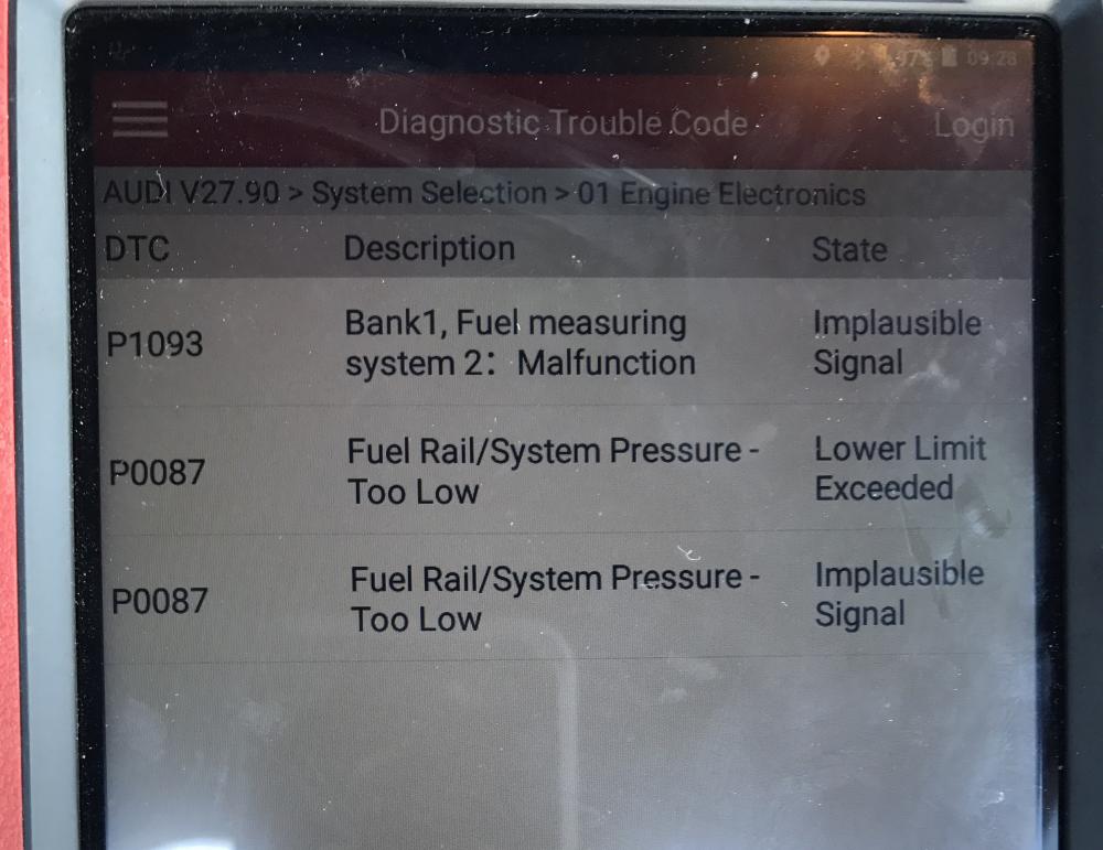

Riccardo Posted May 10, 2017 Posted May 10, 2017 For the last six months plus, while driving at any speed or any gear, random power losses/misfires for one or two seconds, with no pattern sometimes it does not do it for days and sometimes does it three times in a fourteen mile journey, with rev counter dropping and returning to normal again. Sometimes when accelerating from a stand still at a traffic light when I move off, the car seems to do what I can only describe as a huge misfire, I feel a large thud from the engine and the vehicle jerks forward violently then acts normal again so I can drive. Vehicle has had a minor Audi service March 2017b (also full Audi service history). 29thApril I fitted a brand new original Audi original part fuel filter. It seemed to improve things but.... I still see the random power loss/miss fires stutter. Straight after fuel filter change vehicle put on a computer, codes came up P0087 and P1093. (Re computer codes picture attached)Reference code P0087 I googled results; https://www.obd-codes.com/p0087Potential causes of a P0087 trouble code may include: Weak fuel pump, clogged filter or screen, restricted fuel supply line Faulty fuel pump driver module Faulty fuel pressure sensor.Reference code P1093; http://wiki.ross-tech.com/wiki/index.php/17501/P1093/004243P1093 - Bank 1; Fuel Measuring System 2: MalfunctionPossible SymptomsPower LossMisfire(s)StallingPossible CausesFuel Pressure insufficient/exceed/fluctuatingFuel Pump (High Pressure System) faultyFuel Pressure Regulator Valve (N276) faultyPossible SolutionsCheck Fuel Pressure (on FSI engines High and Low Fuel Pressure System)Check Fuel Pump (High Pressure System)Check Fuel Pressure Regulator Valve (N276)Check Fuel Filter and Filter in Fuel Pump CasingSpecial NotesWhen found in 2.0l TFSI<http://wiki.ross-tech.com/wiki/index.php/2.0l_TFSI_(AXX/BGB/BPJ/BPY/BWA)>: * Check Fuel Pressure<http://wiki.ross-tech.com/wiki/index.php/2.0l_TFSI_(AXX/BGB/BPJ/BPY/BWA)#Checking_Fuel_Pressure> * Check TSB/TPI 2008753 (Rest of World), incompatibility between Fuel Pressure Regulator Valve (N276) and ECU software. * When found in conjunction with Misfires and Lean fault codes, check RVUTB: 01-09-03 or 2018919 (NAR only) 2.0T (BPY), for updated Crankcase Breather Valve * If the breather valve is faulty, full engine vacuum is typically found when removing the oil cap at idleMaybe possibly need a new breather valve, high pressure fuel pump/cam follower, or fuel pressure sensor. I've booked my vehicle to go to Audi specialist Les Paul's for first time and I hope they can fix issue as quick as possible.

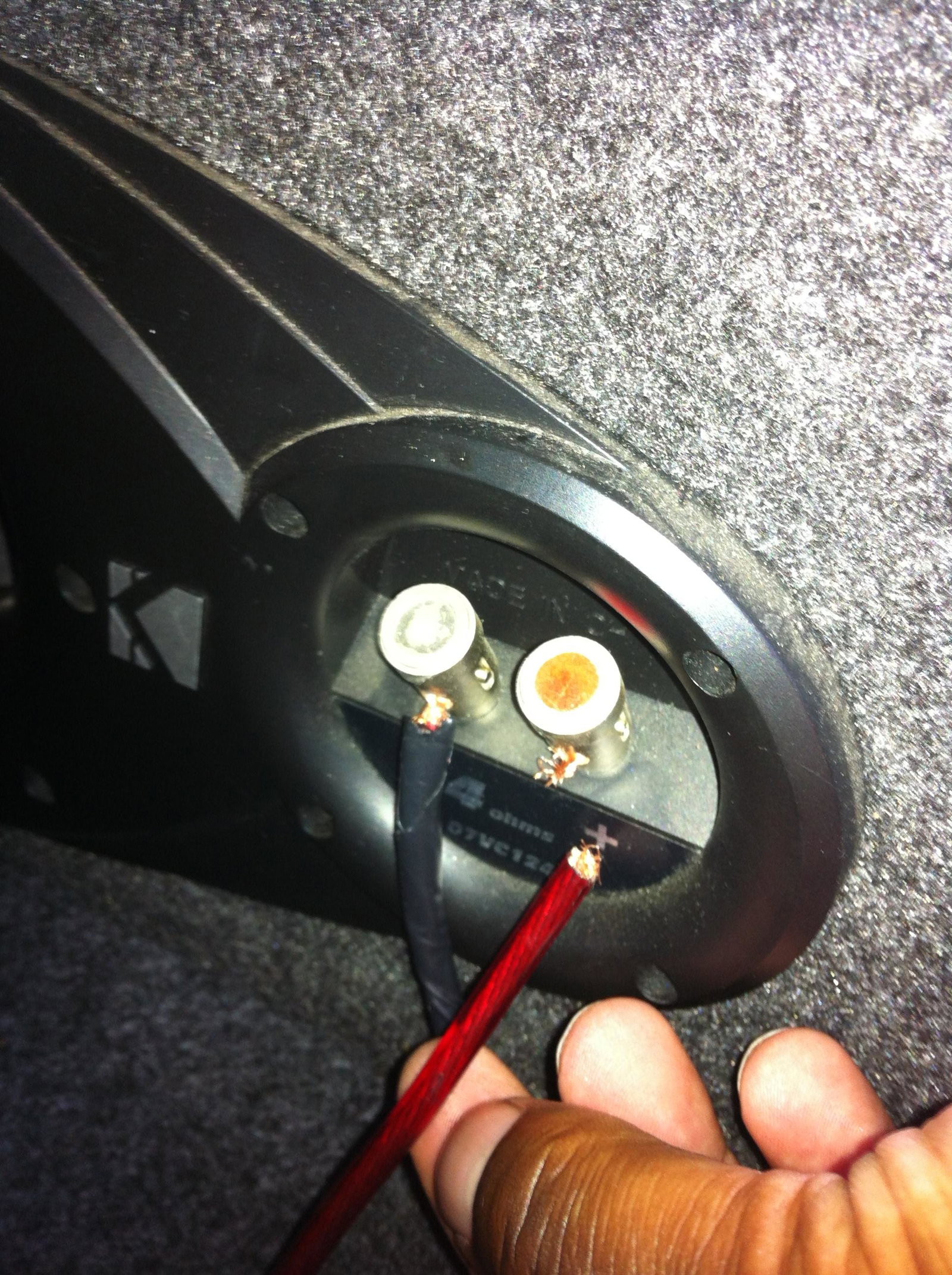

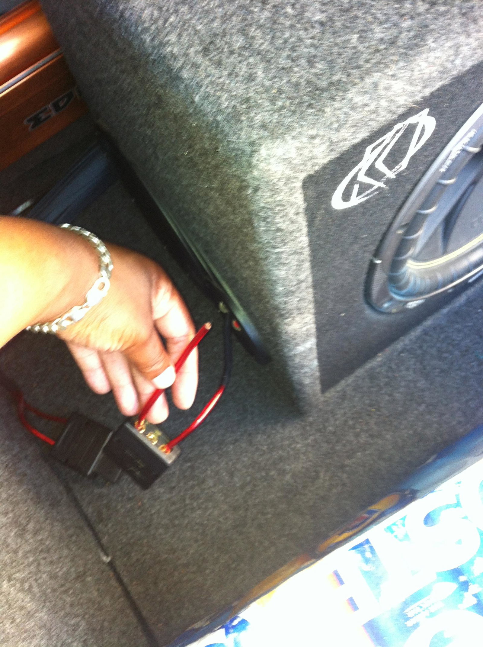

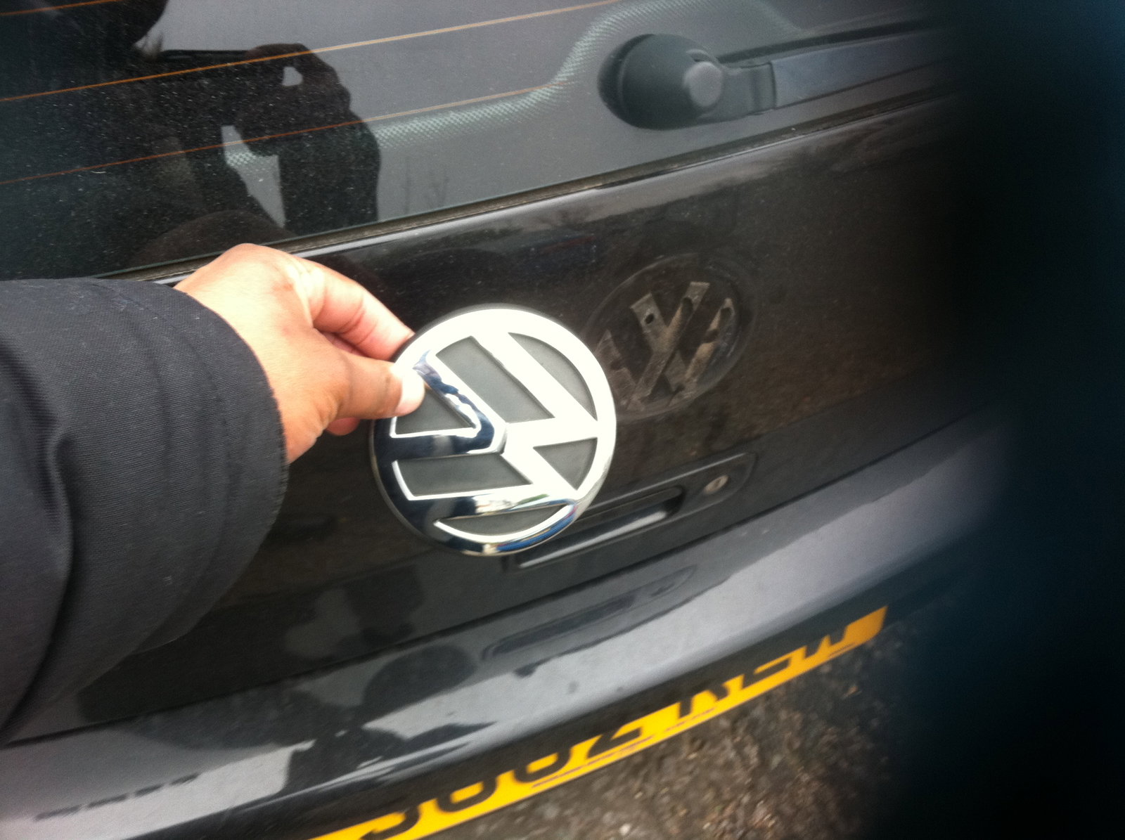

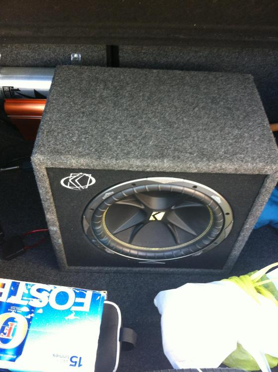

Magnet Posted May 29, 2017 Posted May 29, 2017 Hi Richard, Interesting background, but I'm a bit lost as to where these photos fit in with your current problem for which you are asking for advice on what may be causing your issues. As I see it, the best that can be done on here is to offer some advice on what the causes could possibly be - and it's generally a stab in the dark - and leave it to be dismissed or followed up on, as the case may be. It would be interesting to know how you sort it/have it sorted in the end. Kind regards, Gareth.
Riccardo Posted May 29, 2017 Author Posted May 29, 2017 12 hours ago, Magnet said: Hi Richard, Interesting background, but I'm a bit lost as to where these photos fit in with your current problem for which you are asking for advice on what may be causing your issues. As I see it, the best that can be done on here is to offer some advice on what the causes could possibly be - and it's generally a stab in the dark - and leave it to be dismissed or followed up on, as the case may be. It would be interesting to know how you sort it/have it sorted in the end. Kind regards, Gareth. 25/5/17, 26th, 27th problem came up but since then vanished I will keep monitoring, I'm half tempted to call up mecanic and cancel my 3/6/17 vehicle booking (I really don't want to spend anymore money 🙈😅)

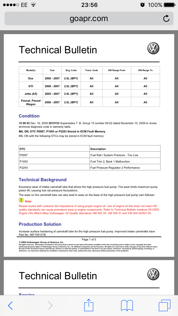

Riccardo Posted May 31, 2017 Author Posted May 31, 2017 I found this last night; Re codes p0087 and p1093 vw technical bulletin, re excessive wear of intake camshaft lobe that drives high pressure fuel pump. The wear on the camshaft lobe can lead to wear on the base of the high pressure fuel pump cam follower. http://www.goapr.com/images/support/tsb/15-09-03 (2015153) 16 Dec 2009 - MIL ON, DTC P0087, P1093 or P2293.pdf
