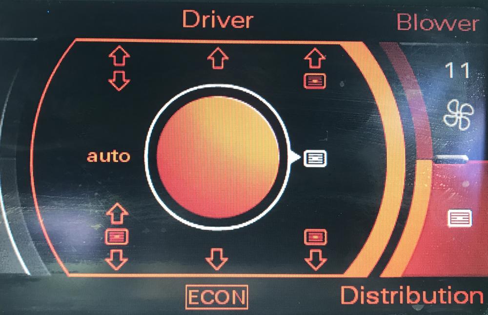

SeanQ87 Posted January 25, 2018 Author Share Posted January 25, 2018 Thats me bought the Cabin / Dust filters, they didn't have the right ones i needed so i have to pick them up tomorrow and ill fit them tomorrow. :P Wither that helps the demister and/or heaters or not, hoping it will, at least its another thing done towards getting the car all sorted and up to date as iv never changed the filter before and i have had the car 10 year, i knew nothing about this filter until this thread.Audi a6 c6 Aircon Button.mp4 Could the 8 options on the screen please be explained to me because i cant find somewhere that tells me what each as? I am just want to make sure im using it correctly lol before i take it to a garage. This is also what happens with the aircon button.. Audi_a6_c6_Aircon_Button.mp4 Quote Link to comment Share on other sites More sharing options...
niedzial1983 Posted January 25, 2018 Share Posted January 25, 2018 Yea so from the video i can see that there is a fault with the air con as the light should go off when you press it Re your picture . Its the air direction settings . On the picture you have it set to central vents . The arrow up in the middle mens the air will be directed to the vends below the winds screen . The 2 next to it is windscreen+central vents and windscreen + legs , rest work on the same principle For example on my a6 c6 i have the air con all all the time and its set on auto, with means the speed and vents are set automaticly dep3nding on the temperature set Quote Link to comment Share on other sites More sharing options...
