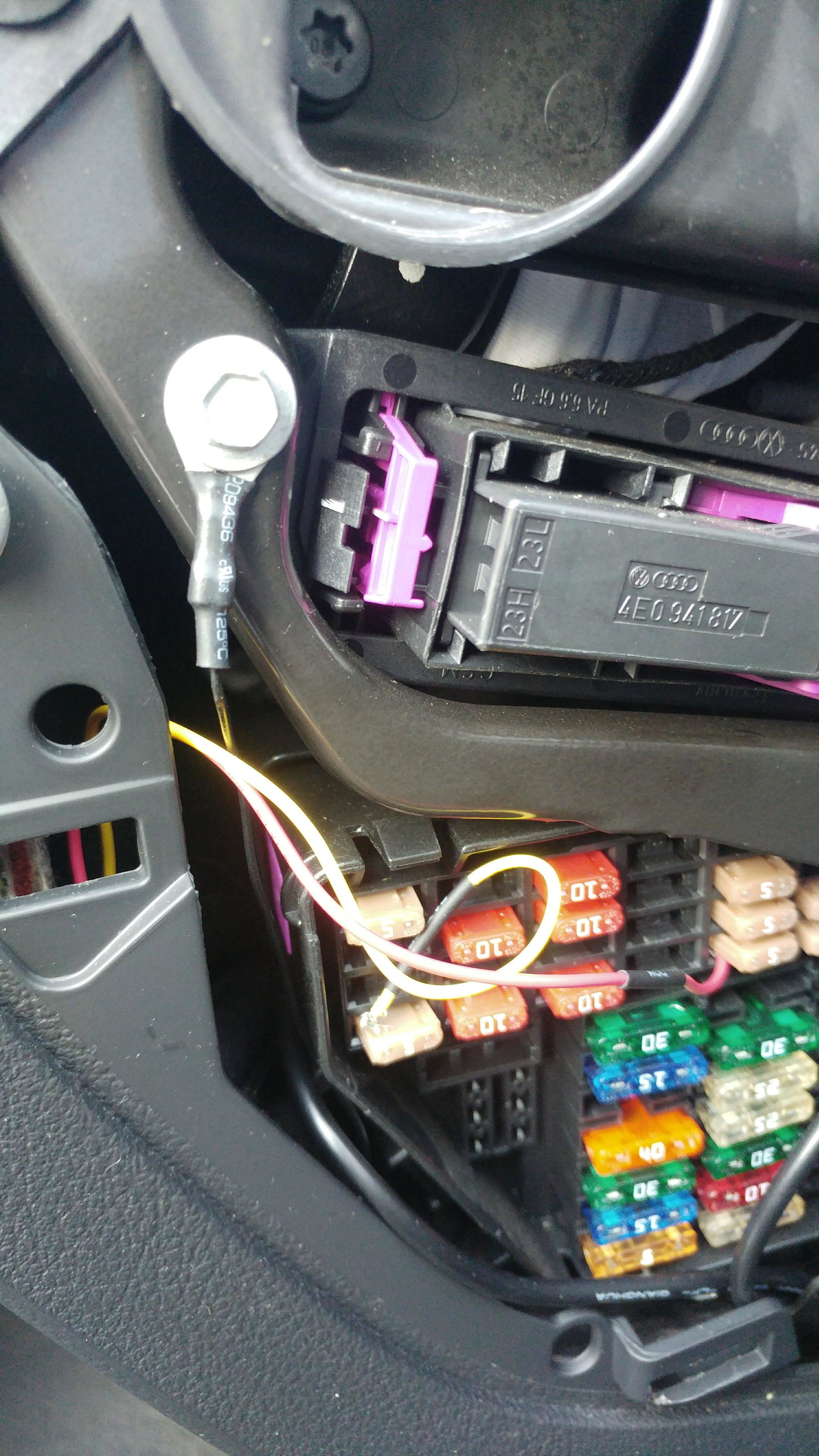

Big_dom91 Posted July 27, 2018 Author Posted July 27, 2018 Right guys only just got round to getting my dash cam bit later than i wanted but im going to be hardwiring it in today and was wondering if anyone knows the best place to connect the earth connection. much appreciated
WPAWS Posted July 27, 2018 Posted July 27, 2018 i earthed mine to the metal part of the fuse box case on drivers side 1
Big_dom91 Posted July 27, 2018 Author Posted July 27, 2018 1 hour ago, Paul A6 said: i earthed mine to the metal part of the fuse box case on drivers side Nice one what fuse is best to piggback to get switch the cam on/off with the ignition
WPAWS Posted July 27, 2018 Posted July 27, 2018 i assume you have a red and yellow wire if so red is off and yellow always on, so you need to test what fuses go off with the ignition and which are still on with the ignition off i would not recommend using the parking brake fuse or air bag fuse
Big_dom91 Posted July 27, 2018 Author Posted July 27, 2018 Only just getting round to doing it and this is how my fuse box is looking but compared to whats wrote in the owners manual there seems to be fuses missing as such
WPAWS Posted July 27, 2018 Posted July 27, 2018 2 hours ago, Big_dom91 said: Only just getting round to doing it and this is how my fuse box is looking but compared to whats wrote in the owners manual there seems to be fuses missing as such not much to play with there m8 how much better on the passenger side?
Big_dom91 Posted July 27, 2018 Author Posted July 27, 2018 2 hours ago, Paul A6 said: not much to play with there m8 how much better on the passenger side? Ending up taking it from fuse 2 on the black panel and its all working fine thankfully pain trying to get the a pillar trim off to hide the wires like but only visible on a tiny bit
WPAWS Posted July 27, 2018 Posted July 27, 2018 had the same issues m8 i never wanted to mess with the pillar trims either, glad ur all sorted 😎 1
