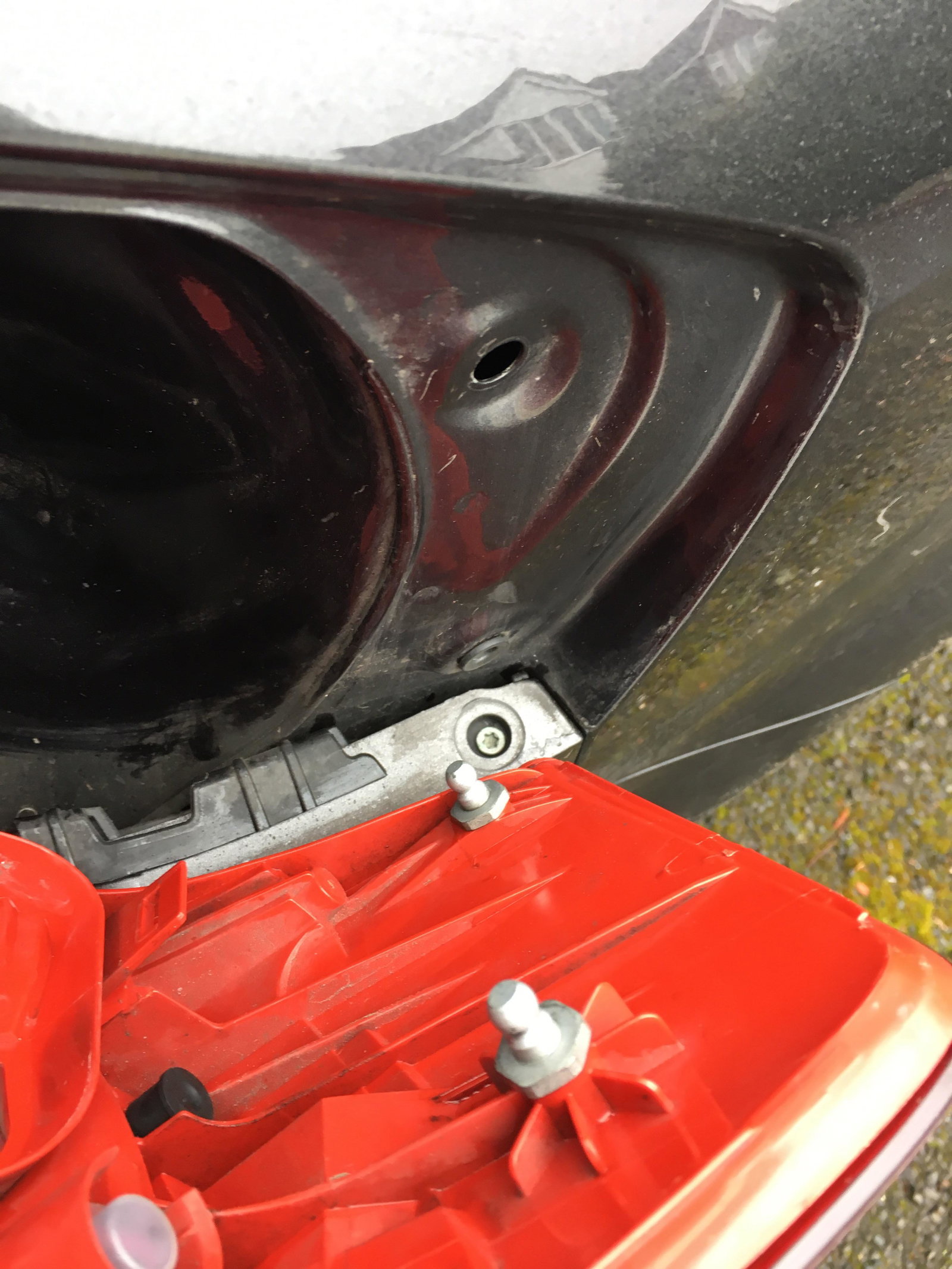

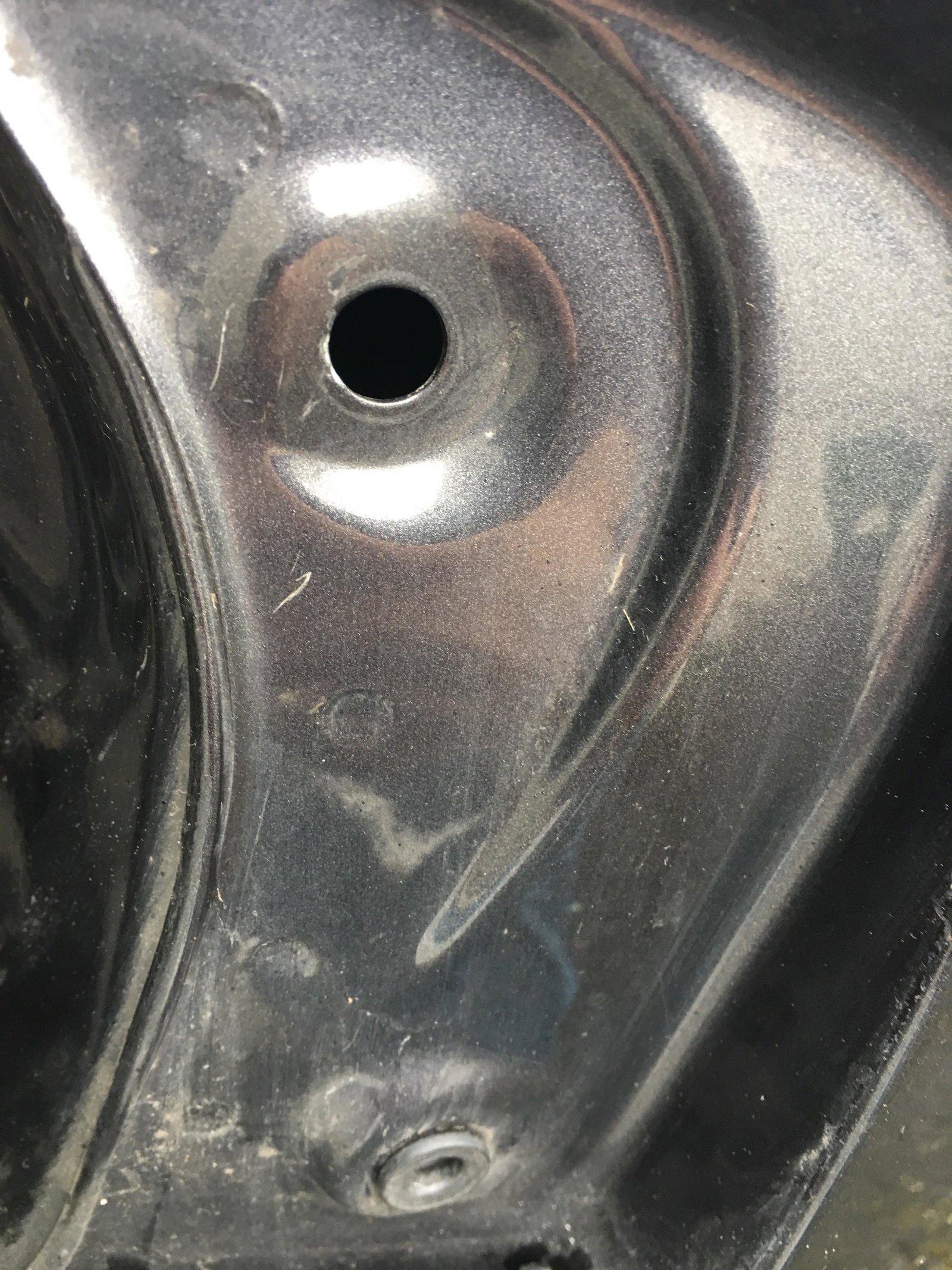

Pete Britton Posted February 17, 2018 Share Posted February 17, 2018 Hi all, i have removed my rear light cluster to change a build but unfortunately one of the rubber bungs have dropped down into the side panel. Anyone know the correct name for them and where I can get replacements? Also any tips on how to stop rain water getting into the cluster. Cheers. Quote Link to comment Share on other sites More sharing options...

Pete Britton Posted February 17, 2018 Author Share Posted February 17, 2018 No, the rubber cups that sit in the side panels that you clip the light cluster into. I was thinking a bit of silicone silent might do the trick for the water but if the cluster was fixed with new rubber cups it might do the trick. Quote Link to comment Share on other sites More sharing options...
Steve Q Posted February 17, 2018 Share Posted February 17, 2018 I'm having a bit of a mind blank. Have you got a picture if the part in question? And yea silicone sealer should do the trick :) Quote Link to comment Share on other sites More sharing options...

Steve Q Posted February 18, 2018 Share Posted February 18, 2018 On seeing the part in question I can tell silicone sealer is t going to work. It's a rubber grommet that protects the paint from rubbing against the light cluster. I would suspect a local motor factors will have something suitable. I've not been able to source the Audi part number, sorry. Cheers Steve Quote Link to comment Share on other sites More sharing options...

Southampton Graham Posted February 18, 2018 Share Posted February 18, 2018 Hi Pete The only Part number I can find is 8EO 845 299A it is a 10mm clip nut There are 2 per side Graham Quote Link to comment Share on other sites More sharing options...
cliffcoggin Posted February 18, 2018 Share Posted February 18, 2018 Pete. That is not simply a plug to seal the hole. It is the mounting grommet that holds the lamp unit in place, so it needs to be the right part to grip the metal peg. I have no idea what Audi calls it but most mechanics would recognise the term grommet. Quote Link to comment Share on other sites More sharing options...

Magnet Posted February 18, 2018 Share Posted February 18, 2018 Hello Pete, I'm of the same opinion as Cliff here and I believe it is a special grommet into which the shaped fasteners fit. Since the dealer is some way away, couldn't you just e-mail them the photo then once they have that, you could talk with them over the phone? Kind regards, Gareth. Quote Link to comment Share on other sites More sharing options...

Pete Britton Posted February 19, 2018 Author Share Posted February 19, 2018 All sorted Graham, turns out Seat do the same one, same part number, 49p each 👍 thanks to you all for your help. Quote Link to comment Share on other sites More sharing options...
