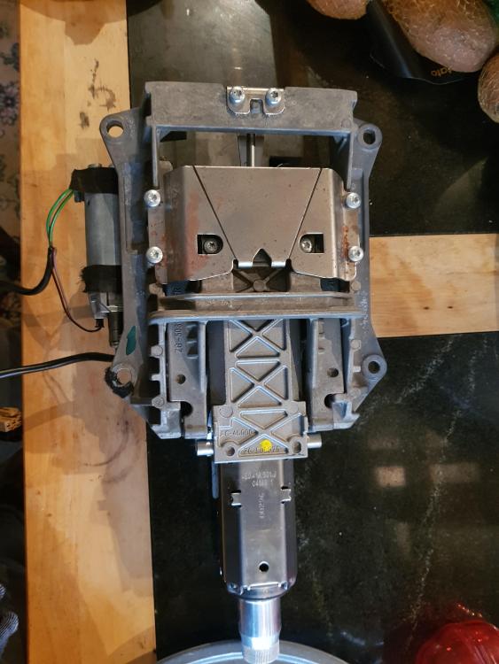

UnknownVirus Posted April 2, 2018 Posted April 2, 2018 Hi I'm a new member and a owner of a Audi S8 D3. I'm a die hard Audi fan and have been for years or even decades. I needed some advise and thought this would be the ultimate place to share my problems with. Lol🤗 So where do I start. I purchased this car a while ago as a project and have now started to look into it. It's been stood since 2007 and has covered around 5thousand miles. 5k. The previous owner had it parked for 10years as it had an electrical fault and some damage which was caused in 2007. After reading on various websites, Ive concluded the steering column to be faulty as vcds is showing steering lock actuator n360 open circuit fault leading me to believe it needs a column. The car accepts the key but there is no ignition lights on the dash. Hopefully when I've sorted this problem I will have to start it at some point. What would be the best procedure. I have already dismantled the front end hoping to crank it by hand for the first few revolutions what should i do as I don't know the state of the engine. If it's seized etc. I don't want to damage what could potentially be my car i keep for life. Any help would be appreciated. ThanksÂ

UnknownVirus Posted April 3, 2018 Author Posted April 3, 2018 Thanks Steve. The car had sustained some damage at the front and was subject to a category D in 2007. It was bought by a chap who had left It in his barn for over 10 years. He had some health problems (at least what he told me ) and tried a few electricians but no success. My main concern is the engine not seized etc. I have removed the column and I'm waiting to see if a friend can swap the file from my car to a new steering column which I bought of eBay. Holefullyvthat may work. If not it's £1020 from audi plus coding. But obviously don't want to fork out 1100 pounds if the engine is shot . I will hopefully keep this detailed and take pics. Fingers crossed the engine isn't knackered, can't take anyone's word on it unless I take the measures to check myself.  I'm going to drop some oil in the cylinders today and let it soak in for a cpl days and manually turn it over by hand.Â

UnknownVirus Posted April 12, 2018 Author Posted April 12, 2018 So, I stripped the steering lock and sent it to Tom at Speedo solutions to have it remanufactured, along with the kessy and a key. Hoping he sorts it. Heard a lot of good things about the chap. I also filled the cylinders with marvels magic oil and let it soak for a few days.  Turned engine by hand wasn't seized so that was a result.Â

UnknownVirus Posted August 14, 2018 Author Posted August 14, 2018 So a quick update. Installed the new column. Had it coded. I'm still having the same problem. No lights no ignition. I did manage to get the car to crank over. But only through vcds. I go to 05 Acc/start module. Put in my security code, which then allows me to do out put tests. The out put test 1. Unlocks the column 2. Switched on terminal 15, which allows me to get all the dash lights etc. On. Which then allows me to start the car which starts for a brief 2 secs. Then dies out. My vcds codes are as follows. The codes that I think are related to start problem are ECM not adapted and Transmission ECM not adapted. I'm in the right direction and have come along way, I just need some expert advice from you guys to get me a little closer. Sunday,05,August,2018,19:05:29:53651 VCDS -- Windows Based VAG/VAS Emulator Running on Windows 7 x64 VCDS Version: 17.1.0.0 Data version: 20170106 DS267.0 www.Ross-Tech.com VIN: WAUZZZ4E47N005512 License Plate: Chassis Type: 4E (4E0) Scan: 01 02 03 05 06 07 08 09 11 31 15 16 17 19 1D 1E 25 34 36 37 38 42 46 47 4F 52 53 55 56 57 61 62 65 67 72 76 77 VIN: WAUZZZ4E47N005512 Mileage: 7850km-4877miles 00-Steering Angle Sensor -- Status: Sporadic communication error 1000 01-Engine -- Status: Malfunction 0010 02-Auto Trans -- Status: Malfunction 0010 03-ABS Brakes -- Status: Malfunction 1010 05-Acc/Start Auth. -- Status: Malfunction 0010 06-Seat Mem. Pass -- Status: Malfunction 0010 07-Control Head -- Status: Malfunction 0010 08-Auto HVAC -- Status: Malfunction 0010 09-Cent. Elect. -- Status: Malfunction 0010 11-Engine II -- Status: Malfunction 0010 31-Engine other -- Status: Malfunction 0010 15-Airbags -- Status: Malfunction 0010 16-Steering wheel -- Status: OK 0000 17-Instruments -- Status: Malfunction 0010 19-CAN Gateway -- Status: Malfunction 0010 1D-Driver Ident. -- Status: Malfunction 0010 1E-Media Player 2 -- Status: Malfunction 0010 25-Immobilizer -- Status: Malfunction 0010 34-Level Control -- Status: Malfunction 0010 36-Seat Mem. Drvr -- Status: Malfunction 0010 37-Navigation -- Status: Malfunction 0010 38-Roof Electronics -- Status: Malfunction 0010 42-Door Elect, Driver -- Status: Malfunction 0010 46-Central Conv. -- Status: Malfunction 0010 47-Sound System -- Status: Malfunction 0010 4F-Centr. Electr. II -- Status: Malfunction 0010 52-Door Elect, Pass. -- Status: Sporadic communication error 1000 53-Parking Brake -- Status: Malfunction 1010 55-Headlight Range -- Status: Cannot be reached 1100 56-Radio -- Status: Sporadic communication error 1000 57-TV Tuner -- Status: OK 0000 61-Battery Regul. -- Status: Malfunction 0010 62-Door, Rear Left -- Status: Malfunction 0010 65-Tire Pressure -- Status: Malfunction 0010 67-Voice Control -- Status: Sporadic communication error 1000 72-Door, Rear Right -- Status: Malfunction 0010 76-Park Assist -- Status: Malfunction 0010 77-Telephone -- Status: OK 0000 ------------------------------------------------------------------------------- Address 01: Engine Labels: Redir Fail! Part No SW: 4E0 910 552 HW: 4E0 907 552 Component: 5.2L V10/4V FSI ª0040 Revision: 5AH11--- Serial number: AUX3Z0F6399878 Coding: 01060003190F0160 Shop #: WSC 02313 785 00200 VCID: 5FCDC5598EEC0FB996-800A 12 Faults Found: 005715 - Please check DTC Memory of ABS Controller P1653 - 008 - Freeze Frame: Fault Status: 01101000 Fault Priority: 0 Fault Frequency: 35 Reset counter: 255 Mileage: 7858 km Time Indication: 0 Date: 2018.07.16 Time: 05:32:00 Freeze Frame: RPM: 0 /min Load: 0.0 % Speed: 0.0 km/h Temperature: -40.0°C Temperature: -40.0°C Absolute Pres.: 1010.0 mbar Voltage: 11.430 V 000280 - Engine Coolant Temp. Sensor (G62) P0118 - 002 - Signal too High Freeze Frame: Fault Status: 01100010 Fault Priority: 0 Fault Frequency: 1 Reset counter: 255 Mileage: 7858 km Time Indication: 0 Date: 2018.07.16 Time: 05:32:02 Freeze Frame: RPM: 0 /min Load: 0.0 % Speed: 0.0 km/h Temperature: -40.0°C Temperature: 30.0°C Absolute Pres.: 1010.0 mbar Voltage: 11.938 V 012370 - Starter Control; Returned Message P3052 - 001 - 50 Short to Plus - Intermittent Freeze Frame: Fault Status: 00100001 Fault Priority: 0 Fault Frequency: 1 Reset counter: 255 Mileage: 7858 km Time Indication: 0 Date: 2018.07.16 Time: 05:42:05 Freeze Frame: RPM: 0 /min Load: 0.0 % Speed: 0.0 km/h Temperature: -40.0°C Temperature: 31.0°C Absolute Pres.: 1010.0 mbar Voltage: 11.684 V 049441 - No Communication with ABS Brake Control Module U0121 - 008 - - Intermittent Freeze Frame: Fault Status: 00101000 Fault Priority: 0 Fault Frequency: 4 Reset counter: 255 Mileage: 7858 km Time Indication: 0 Date: 2018.07.16 Time: 08:42:47 Freeze Frame: RPM: 0 /min Load: 0.0 % Speed: 0.0 km/h Temperature: -40.0°C Temperature: -40.0°C Absolute Pres.: 1010.0 mbar Voltage: 11.303 V 049446 - No Communications with Steering Angle Sender (G85) U0126 - 008 - - Intermittent Freeze Frame: Fault Status: 00101000 Fault Priority: 0 Fault Frequency: 2 Reset counter: 255 Mileage: 7858 km Time Indication: 0 Date: 2018.07.16 Time: 08:42:47 Freeze Frame: RPM: 0 /min Load: 0.0 % Speed: 0.0 km/h Temperature: -40.0°C Temperature: -40.0°C Absolute Pres.: 1010.0 mbar Voltage: 11.303 V 000275 - Intake Air Temp. Sensor (G42) P0113 - 002 - Signal too High Freeze Frame: Fault Status: 01100010 Fault Priority: 0 Fault Frequency: 1 Reset counter: 255 Mileage: 7858 km Time Indication: 0 Date: 2018.07.16 Time: 08:42:48 Freeze Frame: RPM: 0 /min Load: 0.0 % Speed: 0.0 km/h Temperature: -40.0°C Temperature: -40.0°C Absolute Pres.: 1010.0 mbar Voltage: 11.684 V 053250 - Please Check Fault Codes in Comfort System Control Module (J393) U1002 - 008 - - Intermittent Freeze Frame: Fault Status: 00101000 Fault Priority: 0 Fault Frequency: 4 Reset counter: 255 Mileage: 7858 km Time Indication: 0 Date: 2018.07.16 Time: 08:43:49 Freeze Frame: RPM: 0 /min Load: 0.0 % Speed: 0.0 km/h Temperature: -40.0°C Temperature: -40.0°C Absolute Pres.: 1010.0 mbar Voltage: 11.557 V 000258 - Mass Air Flow Sensor (G70) P0102 - 002 - Signal too Low - Intermittent Freeze Frame: Fault Status: 00100010 Fault Priority: 0 Fault Frequency: 1 Reset counter: 255 Mileage: 7858 km Time Indication: 0 Date: 2018.07.16 Time: 08:57:35 Freeze Frame: RPM: 1643 /min Load: 45.9 % Speed: 0.0 km/h Temperature: -40.0°C Temperature: -40.0°C Absolute Pres.: 1010.0 mbar Voltage: 10.922 V 004200 - Intake Air Switch-Over Valve (N335) P1068 - 004 - Open Circuit - Intermittent Freeze Frame: Fault Status: 00100100 Fault Priority: 0 Fault Frequency: 2 Reset counter: 255 Mileage: 7858 km Time Indication: 0 Date: 2018.07.16 Time: 08:57:35 Freeze Frame: RPM: 1643 /min Load: 45.9 % Speed: 0.0 km/h Temperature: -40.0°C Temperature: -40.0°C Absolute Pres.: 1010.0 mbar Voltage: 10.922 V 001299 - Incorrect Immobilizer Key P0513 - 008 - Freeze Frame: Fault Status: 01101000 Fault Priority: 0 Fault Frequency: 1 Reset counter: 255 Mileage: 7858 km Time Indication: 0 Date: 2018.07.16 Time: 09:47:28 Freeze Frame: RPM: 1791 /min Load: 30.6 % Speed: 0.0 km/h Temperature: -40.0°C Temperature: -40.0°C Absolute Pres.: 1010.0 mbar Voltage: 10.033 V 001393 - Brake Switch (F) P0571 - 008 - Implausible Signal Freeze Frame: Fault Status: 01101000 Fault Priority: 0 Fault Frequency: 1 Reset counter: 255 Mileage: 7858 km Time Indication: 0 Date: 2018.07.16 Time: 09:47:29 Freeze Frame: RPM: 1099 /min Load: 22.7 % Speed: 0.0 km/h Temperature: -40.0°C Temperature: -40.0°C Absolute Pres.: 1010.0 mbar Voltage: 11.557 V 006435 - Please Check DTC Memory of ECU Number 2 P1923 - 008 - Freeze Frame: Fault Status: 01101000 Fault Priority: 0 Fault Frequency: 1 Reset counter: 255 Mileage: 7858 km Time Indication: 0 Date: 2018.07.16 Time: 10:20:17 Freeze Frame: RPM: 0 /min Load: 0.0 % Speed: 0.0 km/h Temperature: -40.0°C Temperature: 31.0°C Absolute Pres.: 1010.0 mbar Voltage: 10.795 V Readiness: 0110 1101 ------------------------------------------------------------------------------- Address 02: Auto Trans Labels: 09E-927-156.lbl Part No SW: 4E1 910 156 K HW: 09E 927 156 B Component: AG6 09E 5,2 FSI RdW 0020 Revision: --H01--- Serial number: 0088888 Coding: 0000001 Shop #: WSC 02313 785 00200 VCID: 2B5561898AD4A3194A-807E 6 Faults Found: 049448 - No Communications with Parking Brake Control Module U0128 - 000 - - Intermittent Freeze Frame: Fault Status: 00100000 Fault Priority: 0 Fault Frequency: 4 Reset counter: 255 Mileage: 7858 km Time Indication: 0 Date: 2018.07.16 Time: 00:59:27 Freeze Frame: RPM: 0 /min RPM: 0 /min RPM: 0 /min (no units): 30.0 (no units): 145.0 Temperature: 22.0°C T.B. Angle: 0.0° 049446 - No Communications with Steering Angle Sender (G85) U0126 - 000 - - Intermittent Freeze Frame: Fault Status: 00100000 Fault Priority: 0 Fault Frequency: 4 Reset counter: 255 Mileage: 7858 km Time Indication: 0 Date: 2018.07.16 Time: 00:59:27 049442 - No Communication with ESP (Vehicle Dynamics) Control Module U0122 - 000 - - Intermittent Freeze Frame: Fault Status: 00100000 Fault Priority: 0 Fault Frequency: 4 Reset counter: 255 Mileage: 7858 km Time Indication: 0 Date: 2018.07.16 Time: 00:59:27 013093 - Power Supply Terminal 15 P3325 - 000 - Implausible - Intermittent Freeze Frame: Fault Status: 00100000 Fault Priority: 0 Fault Frequency: 1 Reset counter: 255 Mileage: 7858 km Time Indication: 0 Date: 2018.07.16 Time: 05:20:36 006231 - Load Signal P1857 - 001 - Error Message from ECU - Intermittent Freeze Frame: Fault Status: 00100001 Fault Priority: 0 Fault Frequency: 1 Reset counter: 255 Mileage: 7858 km Time Indication: 0 Date: 2018.07.16 Time: 08:58:21 005889 - Transmission Control Unit P1701 - 000 - Locked Freeze Frame: Fault Status: 01100000 Fault Priority: 0 Fault Frequency: 1 Reset counter: 255 Mileage: 7858 km Time Indication: 0 Date: 2018.07.16 Time: 09:47:29 ------------------------------------------------------------------------------- Address 03: ABS Brakes Labels: 4E0-910-517.lbl Part No SW: 4E0 910 517 D HW: 4E0 614 517 AB Component: ESP 5.7 allrad H46 0500 Coding: 0001627 Shop #: WSC 02313 000 00000 VCID: 24478AB5E70A6C618B-8070 3 Faults Found: 18265 - Load Signal P1857 - 000 - Error Message from ECU - Intermittent 01314 - Engine Control Module 013 - Check DTC Memory - Intermittent 01826 - Sensor for Steering Angle (G85); Supply Voltage Terminal 30 000 - - ------------------------------------------------------------------------------- Address 05: Acc/Start Auth. Labels: 4E0-910-131.lbl Part No SW: 4E0 910 131 HW: 4E0 909 131 K Component: FBS AUDID3 H10 0190 Revision: 01904910 Serial number: AUX3Z0F6399878 Coding: 0412672 Shop #: WSC 29126 001 1048576 VCID: 58BFEE45EBC2F881D7-800C Subsystem 1 - Part No: XXXXXXXXXXX Component: ELV XXXX 4 Faults Found: 02229 - Transmission Control Module (TCM); Immobilizer Data not Adapted 000 - - Freeze Frame: Fault Status: 01100000 Fault Priority: 3 Fault Frequency: 0 Reset counter: 255 Mileage: 7856 km Time Indication: 0 Date: 2018.07.16 Time: 08:57:26 02226 - Engine Control Module (ECM) 2; Immobilizer Data not Adapted 000 - - Freeze Frame: Fault Status: 01100000 Fault Priority: 3 Fault Frequency: 0 Reset counter: 255 Mileage: 7856 km Time Indication: 0 Date: 2018.07.16 Time: 08:57:28 01332 - Door Control Module; Passenger Side (J387) 004 - No Signal/Communication - Intermittent Freeze Frame: Fault Status: 00100100 Fault Priority: 4 Fault Frequency: 0 Reset counter: 159 Mileage: 7856 km Time Indication: 0 Date: 2018.07.16 Time: 09:47:00 00668 - Supply Voltage Terminal 30 002 - Lower Limit Exceeded Freeze Frame: Fault Status: 01100010 Fault Priority: 2 Fault Frequency: 6 Reset counter: 119 Mileage: 7856 km Time Indication: 0 Date: 2018.07.16 Time: 09:52:24 ------------------------------------------------------------------------------- Address 06: Seat Mem. Pass Labels: None Part No SW: 4E0 910 760 D HW: 4E0 959 760 B Component: Sitzmemory BFS H02 0010 Revision: 00000000 Serial number: 5DS 008 795-03 Coding: 4063328 Shop #: WSC 02313 785 00200 VCID: 24478AB5E70A6C618B-8070 2 Faults Found: 02095 - Component Protection Active 000 - - - Intermittent Freeze Frame: Fault Status: 00100000 Fault Priority: 2 Fault Frequency: 3 Reset counter: 159 Mileage: 7856 km Time Indication: 0 Date: 2018.07.16 Time: 08:43:06 01719 - Sensor for Seat Position; Pass. Seat (G278) 010 - Open or Short to Plus Freeze Frame: Fault Status: 01101010 Fault Priority: 4 Fault Frequency: 1 Reset counter: 119 Mileage: 7856 km Time Indication: 0 Date: 2007.08.14 Time: 00:18:35 ------------------------------------------------------------------------------- Address 07: Control Head Labels: 4E0-910-7xx-07.lbl Part No SW: 4E0 910 731 G HW: 4E0 035 729 A Component: Interfacebox H43 2830 Revision: 00000000 Serial number: 300GZ067569875 Coding: 0000002 Shop #: WSC 02313 785 00200 VCID: 254197B1EC3095699C-8070 Subsystem 1 - Part No: 4E0 910 611 Component: E0380 BedienteilH03 0040 Subsystem 2 - Serial number: 00000000015746 Subsystem 3 - Serial number: 0118.07.060000000100010042ÿ Subsystem 4 - Serial number: 010042ÿ 3 Faults Found: 00384 - Optical Databus 011 - Open Circuit - Intermittent Freeze Frame: Fault Status: 00101011 Fault Priority: 5 Fault Frequency: 25 Reset counter: 159 Time Indication: 15 00474 - Control Module for Immobilizer 004 - No Signal/Communication - Intermittent Freeze Frame: Fault Status: 00100100 Fault Priority: 5 Fault Frequency: 2 Reset counter: 159 Mileage: 7858 km Time Indication: 0 Date: 2018.07.16 Time: 08:43:05 02095 - Component Protection Active 000 - - - Intermittent Freeze Frame: Fault Status: 00100000 Fault Priority: 5 Fault Frequency: 2 Reset counter: 159 Mileage: 7858 km Time Indication: 0 Date: 2018.07.16 Time: 08:43:05 ------------------------------------------------------------------------------- Address 08: Auto HVAC Labels: None Part No SW: 4E0 910 043 B HW: 4E0 820 043 G Component: KLIMAAUTOMAT 017 0450 Revision: 00000032 Serial number: 00000000102420 Coding: 0057577 Shop #: WSC 02311 785 00200 VCID: 1C37B255DF7A54A133-8048 4 Faults Found: 01869 - Rear Left Cold / Warm Air Outlet Motor Position Sensor (G351) 010 - Open or Short to Plus Freeze Frame: Fault Status: 01101010 Fault Priority: 3 Fault Frequency: 1 Reset counter: 119 Mileage: 7858 km Time Indication: 0 Date: 2018.07.16 Time: 01:12:53 Freeze Frame: Voltage: 11.90 V (no units): 187.0 (no units): 255.0 00819 - High Pressure Sensor (G65) 010 - Open or Short to Plus - Intermittent Freeze Frame: Fault Status: 00101010 Fault Priority: 3 Fault Frequency: 1 Reset counter: 158 Mileage: 7858 km Time Indication: 0 Date: 2018.07.16 Time: 05:20:40 01592 - Air Quality Sensor (G238) 010 - Open or Short to Plus - Intermittent Freeze Frame: Fault Status: 00101010 Fault Priority: 3 Fault Frequency: 1 Reset counter: 158 Mileage: 7858 km Time Indication: 0 Date: 2018.07.16 Time: 05:20:40 Freeze Frame: Temperature: 33.0°C 01314 - Engine Control Module 013 - Check DTC Memory Freeze Frame: Fault Status: 00101010 Fault Priority: 3 Fault Frequency: 1 Reset counter: 158 Mileage: 7858 km Time Indication: 0 Date: 2018.07.16 Time: 05:20:40 ------------------------------------------------------------------------------- Address 09: Cent. Elect. Labels: 4E0-910-279.lbl Part No HW: 4E0 907 279 Q Component: RLS NO RESPONSE Coding: 0133121 Shop #: WSC 02313 785 00200 VCID: 55A1E771FCD0C5E9CC-8000 Subsystem 1 - Part No: 4E2 910 113 B Component: Wischer WWS D3 H50 0420 Coding: 00000037 Shop #: WSC 02313 5 Faults Found: 01520 - Rain and Light Recognition Sensor (G397) 004 - No Signal/Communication Freeze Frame: Fault Status: 01100100 Fault Priority: 2 Fault Frequency: 4 Reset counter: 119 Mileage: 7858 km Time Indication: 0 Date: 2018.07.16 Time: 09:57:56 01493 - Bulb for Blinkers; Front Left (M5) 010 - Open or Short to Plus Freeze Frame: Fault Status: 01101010 Fault Priority: 2 Fault Frequency: 1 Reset counter: 119 Mileage: 7858 km Time Indication: 0 Date: 2018.07.16 Time: 09:59:00 01497 - Bulb for Blinkers; Front Right (M7) 010 - Open or Short to Plus Freeze Frame: Fault Status: 01101010 Fault Priority: 2 Fault Frequency: 1 Reset counter: 119 Mileage: 7858 km Time Indication: 0 Date: 2018.07.16 Time: 09:59:00 00908 - Control Module for Wiper Motor 004 - No Signal/Communication - Intermittent Freeze Frame: Fault Status: 00100100 Fault Priority: 1 Fault Frequency: 1 Reset counter: 159 Mileage: 7858 km Time Indication: 0 Date: 2018.07.16 Time: 08:51:05 02510 - Steering Column Adjustment 014 - Defective Freeze Frame: Fault Status: 01101110 Fault Priority: 3 Fault Frequency: 1 Reset counter: 119 Mileage: 7858 km Time Indication: 0 Date: 2018.07.16 Time: 10:20:18 ------------------------------------------------------------------------------- Address 11: Engine II Labels: Redir Fail! Part No SW: 4E0 910 552 HW: 4E0 907 552 Component: 5.2L V10/4V FSI ª0040 Revision: 5AH11--- Serial number: AUX3Z0F6399878 Coding: 01060003190F0160 Shop #: WSC 02313 785 00200 VCID: 5FCDC5598EEC0FB996-800A 6 Faults Found: 005715 - Please check DTC Memory of ABS Controller P1653 - 008 - Freeze Frame: Fault Status: 01101000 Fault Priority: 0 Fault Frequency: 59 Reset counter: 255 Mileage: 7858 km Time Indication: 0 Date: 2018.07.16 Time: 21:23:45 Freeze Frame: RPM: 0 /min Load: 0.0 % Speed: 0.0 km/h Temperature: -40.0°C Temperature: -40.0°C Absolute Pres.: 1010.0 mbar Voltage: 11.430 V 049441 - No Communication with ABS Brake Control Module U0121 - 008 - - Intermittent Freeze Frame: Fault Status: 00101000 Fault Priority: 0 Fault Frequency: 12 Reset counter: 255 Mileage: 7858 km Time Indication: 0 Date: 2018.07.16 Time: 00:59:27 Freeze Frame: RPM: 0 /min Load: 0.0 % Speed: 0.0 km/h Temperature: -40.0°C Temperature: -40.0°C Absolute Pres.: 1010.0 mbar Voltage: 11.303 V 049446 - No Communications with Steering Angle Sender (G85) U0126 - 008 - - Intermittent Freeze Frame: Fault Status: 00101000 Fault Priority: 0 Fault Frequency: 4 Reset counter: 255 Mileage: 7858 km Time Indication: 0 Date: 2018.07.16 Time: 00:59:27 Freeze Frame: RPM: 0 /min Load: 0.0 % Speed: 0.0 km/h Temperature: -40.0°C Temperature: -40.0°C Absolute Pres.: 1010.0 mbar Voltage: 11.303 V 053250 - Please Check Fault Codes in Comfort System Control Module (J393) U1002 - 008 - - Intermittent Freeze Frame: Fault Status: 00101000 Fault Priority: 0 Fault Frequency: 5 Reset counter: 255 Mileage: 7858 km Time Indication: 0 Date: 2018.07.16 Time: 05:20:01 Freeze Frame: RPM: 0 /min Load: 0.0 % Speed: 0.0 km/h Temperature: -40.0°C Temperature: -40.0°C Absolute Pres.: 1010.0 mbar Voltage: 11.557 V 001299 - Incorrect Immobilizer Key P0513 - 008 - Freeze Frame: Fault Status: 01101000 Fault Priority: 0 Fault Frequency: 1 Reset counter: 255 Mileage: 7858 km Time Indication: 0 Date: 2018.07.16 Time: 09:47:29 Freeze Frame: RPM: 1112 /min Load: 22.7 % Speed: 0.0 km/h Temperature: -40.0°C Temperature: -40.0°C Absolute Pres.: 1010.0 mbar Voltage: 11.430 V 000915 - Camshaft Position Sensor (G301) P0393 - 001 - Signal too High Freeze Frame: Fault Status: 01100001 Fault Priority: 0 Fault Frequency: 1 Reset counter: 255 Mileage: 7858 km Time Indication: 0 Date: 2018.07.16 Time: 09:50:53 Freeze Frame: RPM: 615 /min Load: 27.4 % Speed: 0.0 km/h Temperature: -40.0°C Temperature: -40.0°C Absolute Pres.: 1010.0 mbar Voltage: 11.049 V ------------------------------------------------------------------------------- Address 15: Airbags Labels: 4E0-910-655-94.lbl Part No SW: 4E0 910 655 D HW: 4E0 959 655 H Component: Airbag 9.41 H13 3710 Revision: 91H13371 Serial number: 0037P000P8F/ Coding: 0431707 Shop #: WSC 02313 785 00200 VCID: 275D9DB9963C8779AE-8072 Subsystem 1 - Serial number: 63328RB401632503+ Subsystem 2 - Serial number: 63428RB4016325332 Subsystem 3 - Serial number: 63528RB4016324D4D Subsystem 4 - Serial number: 63628RB4016324E3E Subsystem 5 - Serial number: 63729RB4016B8A38U Subsystem 6 - Serial number: 63829RB4047F41D6Y 2 Faults Found: 01316 - ABS Control Module 004 - No Signal/Communication - Intermittent Freeze Frame: Fault Status: 00100100 Fault Priority: 2 Fault Frequency: 4 Reset counter: 159 Mileage: 7858 km Time Indication: 0 Date: 2018.07.16 Time: 00:59:27 02095 - Component Protection Active 000 - - - Intermittent Freeze Frame: Fault Status: 00110000 Fault Priority: 2 Fault Frequency: 3 Reset counter: 159 Mileage: 7858 km Time Indication: 0 Date: 2018.07.16 Time: 08:43:05 ------------------------------------------------------------------------------- Address 16: Steering wheel Labels: 4E0-910-549.lbl Part No SW: 4E0 910 549 HW: 4E0 953 549 Component: Lenksäulenmodul H14 0040 Coding: 0112141 Shop #: WSC 02311 785 00200 VCID: 65C1D7B1ACB055695C-8030 Subsystem 1 - Part No: XXXXXXXXXXX Component: Lenkradmodul H07 0090 No fault code found. ------------------------------------------------------------------------------- Address 17: Instruments Labels: 4E0-910-xxx-17.lbl Part No SW: 4E0 910 951 E HW: 4E0 920 951 E Component: KOMBIINSTR. VDO H82 0520 Revision: D03 Serial number: AUDID3F6000573 Coding: 0048413 Shop #: WSC 02313 785 00200 VCID: 275D9DB9963C8779AE-8072 1 Fault Found: 00779 - Outside Air Temp Sensor (G17) 010 - Open or Short to Plus Freeze Frame: Fault Status: 00000011 Fault Priority: 7 Fault Frequency: 1 Reset counter: 119 Mileage: 7858 km Time Indication: 0 Date: 2018.07.16 Time: 01:12:36 ------------------------------------------------------------------------------- Address 19: CAN Gateway Labels: 4E0-910-468.clb Part No SW: 4E0 910 468 B HW: 4E0 907 468 E Component: Gateway H11 0090 Revision: 11 Serial number: 20003066238076 Coding: FCFFFBDD2B7504 Shop #: WSC 02313 785 00200 VCID: 275D9DB9963C8779AE-8072 7 Faults Found: 01771 - Control Module for Headlight Range (J431) 004 - No Signal/Communication Freeze Frame: Fault Status: 01100100 Fault Priority: 2 Fault Frequency: 6 Reset counter: 119 Mileage: 7858 km Time Indication: 0 Date: 2018.07.16 Time: 01:12:36 01304 - Radio 004 - No Signal/Communication Freeze Frame: Fault Status: 01100100 Fault Priority: 3 Fault Frequency: 10 Reset counter: 119 Mileage: 7858 km Time Indication: 0 Date: 2018.07.16 Time: 01:13:31 01301 - Control Module for Voice Recognition (J507) 004 - No Signal/Communication Freeze Frame: Fault Status: 01100100 Fault Priority: 3 Fault Frequency: 10 Reset counter: 119 Mileage: 7858 km Time Indication: 0 Date: 2018.07.16 Time: 01:13:31 01316 - ABS Control Module 004 - No Signal/Communication - Intermittent Freeze Frame: Fault Status: 00100100 Fault Priority: 2 Fault Frequency: 3 Reset counter: 159 Mileage: 7858 km Time Indication: 0 Date: 2018.07.16 Time: 05:12:04 00473 - Control Module for Elect. Park/Hand Brake (J540) 004 - No Signal/Communication - Intermittent Freeze Frame: Fault Status: 00100100 Fault Priority: 2 Fault Frequency: 3 Reset counter: 159 Mileage: 7858 km Time Indication: 0 Date: 2018.07.16 Time: 05:12:04 00778 - Steering Angle Sensor (G85) 004 - No Signal/Communication - Intermittent Freeze Frame: Fault Status: 00100100 Fault Priority: 2 Fault Frequency: 3 Reset counter: 159 Mileage: 7858 km Time Indication: 0 Date: 2018.07.16 Time: 05:12:04 01332 - Door Control Module; Passenger Side (J387) 004 - No Signal/Communication - Intermittent Freeze Frame: Fault Status: 00100100 Fault Priority: 2 Fault Frequency: 1 Reset counter: 159 Mileage: 7858 km Time Indication: 0 Date: 2018.07.16 Time: 09:46:58 ------------------------------------------------------------------------------- Address 1D: Driver Ident. Labels: 4E0-910-218.lbl Part No SW: 4E0 910 218 A HW: 4E2 905 218 B Component: FPI_1 H01 0020 Revision: 01000102 Serial number: 28062006221043 Shop #: WSC 00000 000 00000 VCID: 1F4D8559CE6C4FB9D6-804A 1 Fault Found: 00446 - Function Limitation due to Under-Voltage 002 - Lower Limit Exceeded - Intermittent Freeze Frame: Fault Status: 00100010 Fault Priority: 7 Fault Frequency: 7 Reset counter: 159 Mileage: 7856 km Time Indication: 0 Date: 2018.07.16 Time: 09:58:56 ------------------------------------------------------------------------------- Address 1E: Media Player 2 Labels: 4E0-910-111.lbl Part No SW: 4E0 910 111 F HW: 4E0 035 111 A Component: CD-Changer H44 0470 Revision: 00000000 Serial number: AUZ5ZBF8161647 Shop #: WSC 00000 000 00000 VCID: 1C37B255DF7A54A133-8048 1 Fault Found: 02261 - Data Medium 014 - Defective Freeze Frame: Fault Status: 01101110 Fault Priority: 7 Fault Frequency: 1 Reset counter: 119 Mileage: 7858 km Time Indication: 0 Date: 2018.07.16 Time: 00:00:15 Freeze Frame: Text: 00000000 ------------------------------------------------------------------------------- Address 25: Immobilizer Labels: 4E0-910-131.lbl Part No SW: 4E0 910 131 HW: 4E0 909 131 K Component: FBS AUDID3 H10 0190 Revision: 01904910 Serial number: AUX3Z0F6399878 Coding: 0412672 Shop #: WSC 29126 001 1048576 VCID: 58BFEE45EBC2F881D7-800C Subsystem 1 - Part No: XXXXXXXXXXX Component: ELV XXXX XXXXXXXXXXX ELV XXXX 4 Faults Found: 02229 - Transmission Control Module (TCM); Immobilizer Data not Adapted 000 - - Freeze Frame: Fault Status: 01100000 Fault Priority: 3 Fault Frequency: 0 Reset counter: 255 Mileage: 7856 km Time Indication: 0 Date: 2018.07.16 Time: 08:57:26 02226 - Engine Control Module (ECM) 2; Immobilizer Data not Adapted 000 - - Freeze Frame: Fault Status: 01100000 Fault Priority: 3 Fault Frequency: 0 Reset counter: 255 Mileage: 7856 km Time Indication: 0 Date: 2018.07.16 Time: 08:57:28 01332 - Door Control Module; Passenger Side (J387) 004 - No Signal/Communication - Intermittent Freeze Frame: Fault Status: 00100100 Fault Priority: 4 Fault Frequency: 0 Reset counter: 159 Mileage: 7856 km Time Indication: 0 Date: 2018.07.16 Time: 09:47:00 00668 - Supply Voltage Terminal 30 002 - Lower Limit Exceeded Freeze Frame: Fault Status: 01100010 Fault Priority: 2 Fault Frequency: 6 Reset counter: 119 Mileage: 7856 km Time Indication: 0 Date: 2018.07.16 Time: 09:52:24 ------------------------------------------------------------------------------- Address 34: Level Control Labels: 4E0-910-553.lbl Part No SW: 4E0 910 553 J HW: 4E0 907 553 F Component: LUFTFDR.-CDC H06 6310 Coding: 0015510 Shop #: WSC 02313 785 00200 VCID: 2A5B648D852EBA11B1-807E 7 Faults Found: 01399 - Relay for Level-Control Compressor (J403) 009 - Open or Short to Ground - Intermittent Freeze Frame: Fault Status: 00101001 Fault Priority: 2 Fault Frequency: 3 Reset counter: 159 Mileage: 0 km Time Indication: 0 00144 - Rear Left Dampening Adjustment Valve (N338) 012 - Electrical Fault in Circuit Freeze Frame: Fault Status: 11101100 Fault Priority: 3 Fault Frequency: 21 Reset counter: 119 Mileage: 7858 km Time Indication: 0 Date: 2018.07.16 Time: 21:24:43 00778 - Steering Angle Sensor (G85) 004 - No Signal/Communication - Intermittent Freeze Frame: Fault Status: 00100100 Fault Priority: 3 Fault Frequency: 5 Reset counter: 159 Mileage: 7858 km Time Indication: 0 Date: 2018.07.16 Time: 00:59:27 01316 - ABS Control Module 004 - No Signal/Communication - Intermittent Freeze Frame: Fault Status: 00100100 Fault Priority: 3 Fault Frequency: 5 Reset counter: 159 Mileage: 7858 km Time Indication: 0 Date: 2018.07.16 Time: 00:59:28 01400 - Suspension Level Control 001 - Upper Limit Exceeded - Intermittent Freeze Frame: Fault Status: 00100001 Fault Priority: 2 Fault Frequency: 6 Reset counter: 159 Mileage: 7858 km Time Indication: 0 Date: 2018.07.16 Time: 05:16:53 01769 - Sensor for Vehicle Leveling; Front Right (G289) 008 - Implausible Signal Freeze Frame: Fault Status: 11101000 Fault Priority: 3 Fault Frequency: 8 Reset counter: 119 Mileage: 7858 km Time Indication: 0 Date: 2018.07.16 Time: 08:55:03 01598 - Drive Battery Voltage 002 - Lower Limit Exceeded Freeze Frame: Fault Status: 11100010 Fault Priority: 4 Fault Frequency: 4 Reset counter: 119 Mileage: 7858 km Time Indication: 0 Date: 2018.07.16 Time: 09:53:03 ------------------------------------------------------------------------------- Address 36: Seat Mem. Drvr Labels: None Part No SW: 4E0 910 760 D HW: 4E0 959 760 B Component: Sitzmemory FS H02 0010 Revision: 00000000 Serial number: 5DS 008 795-03 Coding: 4063330 Shop #: WSC 00000 000 00000 VCID: 24478AB5E70A6C618B-8070 3 Faults Found: 01446 - Sensor for Driver Seat; Seatback Adjust (G230) 005 - No or Incorrect Basic Setting / Adaptation Freeze Frame: Fault Status: 01100101 Fault Priority: 4 Fault Frequency: 1 Reset counter: 119 Mileage: 0 km Time Indication: 0 Date: 2008.01.01 Time: 00:00:00 02095 - Component Protection Active 000 - - - Intermittent Freeze Frame: Fault Status: 00100000 Fault Priority: 2 Fault Frequency: 3 Reset counter: 159 Mileage: 7856 km Time Indication: 0 Date: 2018.07.16 Time: 08:43:06 01893 - Belt Height Adjustment Position Sensor (G372) 005 - No or Incorrect Basic Setting / Adaptation Freeze Frame: Fault Status: 01100101 Fault Priority: 4 Fault Frequency: 1 Reset counter: 119 Mileage: 0 km Time Indication: 0 Date: 2008.01.01 Time: 00:00:00 ------------------------------------------------------------------------------- Address 37: Navigation Labels: 4E0-910-88x-37.lbl Part No SW: 4E0 910 887 Q HW: 4E0 919 887 D Component: MNS ECE H48 0850 Revision: 00000000 Serial number: 364G2067579658 Shop #: WSC 02313 785 00200 VCID: 3B7551C97AB43399DA-806E 1 Fault Found: 01316 - ABS Control Module 004 - No Signal/Communication - Intermittent Freeze Frame: Fault Status: 00100100 Fault Priority: 5 Fault Frequency: 9 Reset counter: 159 Mileage: 7858 km Time Indication: 0 Date: 2018.07.16 Time: 00:59:31 Freeze Frame: Bin. Bits: 1100 ------------------------------------------------------------------------------- Address 38: Roof Electronics Labels: 4E0-910-135.lbl Part No SW: 4E0 910 135 A HW: 4E0 907 135 A Component: Dachknoten D3 H05 0090 Serial number: 00000620000052 Coding: 0036070 Shop #: WSC 02313 785 00200 VCID: 1D31BF51C4605DA9C4-8048 3 Faults Found: 02162 - Indicator Lamp on Rear Interior Light Switch (K190) 006 - Short to Plus - Intermittent Freeze Frame: Fault Status: 00100110 Fault Priority: 0 Fault Frequency: 15 Reset counter: 159 Mileage: 7856 km Time Indication: 0 Date: 2018.07.16 Time: 01:31:00 02138 - Control Circuit for Front Right Interior Lights 012 - Electrical Fault in Circuit Freeze Frame: Fault Status: 01101100 Fault Priority: 0 Fault Frequency: 1 Reset counter: 119 Mileage: 7856 km Time Indication: 0 Date: 2018.07.16 Time: 01:53:00 01332 - Door Control Module; Passenger Side (J387) 004 - No Signal/Communication - Intermittent Freeze Frame: Fault Status: 00100100 Fault Priority: 0 Fault Frequency: 1 Reset counter: 159 Mileage: 7856 km Time Indication: 0 Date: 2018.07.16 Time: 09:47:00 ------------------------------------------------------------------------------- Address 42: Door Elect, Driver Labels: 4E1-910-802-42.lbl Part No SW: 4E1 910 802 B HW: 4E2 959 802 B Component: Türsteuer.FS BRM003 0100 Coding: 0032751 Shop #: WSC 02313 785 00200 VCID: 204F86A5F3127041EF-8074 1 Fault Found: 01332 - Door Control Module; Passenger Side (J387) 004 - No Signal/Communication - Intermittent Freeze Frame: Fault Status: 00100100 Fault Priority: 4 Fault Frequency: 0 Reset counter: 159 Mileage: 7856 km Time Indication: 0 Date: 2018.07.16 Time: 09:47:10 ------------------------------------------------------------------------------- Address 46: Central Conv. Labels: 4E0-910-289.lbl Part No SW: 4E0 910 289 D HW: 4E0 907 289 D Component: Komfortgeraet H07 0010 Revision: 00100007 Serial number: W040607240256 Coding: 0004861 Shop #: WSC 02313 785 00200 VCID: 2A5B648D852EBA11B1-807E Subsystem 1 - Part No: 4E0 910 853 Component: Heckdeckel P14H06 0070 Subsystem 2 - Part No: 4E0 907 719 Component: Neigungssensor H05 0020 6 Faults Found: 01316 - ABS Control Module 004 - No Signal/Communication - Intermittent Freeze Frame: Fault Status: 00100100 Fault Priority: 3 Fault Frequency: 5 Reset counter: 159 Mileage: 7858 km Time Indication: 0 Date: 2018.07.16 Time: 05:20:01 00576 - Terminal 15 008 - Implausible Signal - Intermittent Freeze Frame: Fault Status: 00101000 Fault Priority: 3 Fault Frequency: 2 Reset counter: 159 Mileage: 7858 km Time Indication: 0 Date: 2018.07.16 Time: 05:20:36 01366 - Opened Due to Crash Signal 004 - No Signal/Communication - Intermittent Freeze Frame: Fault Status: 00100100 Fault Priority: 3 Fault Frequency: 2 Reset counter: 159 Mileage: 7858 km Time Indication: 0 Date: 2018.07.16 Time: 05:20:40 02095 - Component Protection Active 000 - - - Intermittent Freeze Frame: Fault Status: 00100000 Fault Priority: 2 Fault Frequency: 2 Reset counter: 159 Mileage: 7858 km Time Indication: 0 Date: 2018.07.16 Time: 08:44:37 01332 - Door Control Module; Passenger Side (J387) 004 - No Signal/Communication - Intermittent Freeze Frame: Fault Status: 00100100 Fault Priority: 5 Fault Frequency: 2 Reset counter: 159 Mileage: 7858 km Time Indication: 0 Date: 2018.07.16 Time: 09:47:04 01699 - Motor for Central Locking; Hatch/Trunk (V53) 014 - Defective Freeze Frame: Fault Status: 01101110 Fault Priority: 3 Fault Frequency: 92 Reset counter: 119 Mileage: 7858 km Time Indication: 0 Date: 2007.08.14 Time: 00:00:03 ------------------------------------------------------------------------------- Address 47: Sound System Labels: None Part No SW: 4E0 910 466 A HW: 4E0 035 466 Component: BO_D3 H06 0170 Revision: 12S00002 Serial number: 00607060004114 Coding: 0000027 Shop #: WSC 02313 785 00200 VCID: 24478AB5E70A6C618B-8070 Subsystem 1 - Part No: 4E0 910 465 A Component: BO_D3_SLAVE H31 0100 Subsystem 2 - Serial number: 01407060001993 Subsystem 3 - Serial number: 0214.07.060000000100030012ÿ Subsystem 4 - Serial number: 030012ÿ 4 Faults Found: 00877 - Treble Speaker Rear Right (R16) 011 - Open Circuit Freeze Frame: Fault Status: 01101011 Fault Priority: 5 Fault Frequency: 77 Reset counter: 119 Mileage: 7858 km Time Indication: 0 Date: 2018.07.16 Time: 21:14:22 Freeze Frame: Voltage: 11.60 V Temperature: 52.0°C Bin. Bits: 00000100 Voltage: 11.50 V Temperature: 54.0°C 00474 - Unlicensed Version. Not all DTCs 004 - will be decoded. - Intermittent Freeze Frame: Fault Status: 00100100 Fault Priority: 5 Fault Frequency: 4 Reset counter: 160 Mileage: 7858 km Time Indication: 0 Date: 2018.07.16 Time: 21:20:45 Freeze Frame: Voltage: 11.50 V Temperature: 53.0°C Bin. Bits: 00000011 Voltage: 11.50 V Temperature: 58.0°C 03029 - Unlicensed Version. Not all DTCs 011 - will be decoded. Freeze Frame: Fault Status: 01101011 Fault Priority: 5 Fault Frequency: 79 Reset counter: 119 Mileage: 7858 km Time Indication: 0 Date: 2018.07.16 Time: 21:20:45 Freeze Frame: Voltage: 11.40 V Temperature: 53.0°C Bin. Bits: 00000011 Voltage: 25.50 V Temperature: -52.0°C 02559 - Rear Right Mid-Range/Woofer Loudspeaker (R160) 011 - Open Circuit Freeze Frame: Fault Status: 01101011 Fault Priority: 5 Fault Frequency: 79 Reset counter: 119 Mileage: 7858 km Time Indication: 0 Date: 2018.07.16 Time: 21:20:45 Freeze Frame: Voltage: 11.50 V Temperature: 53.0°C Bin. Bits: 00000011 Voltage: 11.50 V Temperature: 58.0°C ------------------------------------------------------------------------------- Address 4F: Centr. Electr. II Labels: None Part No SW: 4E0 910 280 A HW: 4E0 907 280 B Component: ILM Beifahrer H11 0070 Revision: Serial number: 00000000001108 Coding: 0010101 Shop #: WSC 02313 785 00200 VCID: 1E33B85DC96646B1DD-804A 3 Faults Found: 01316 - ABS Control Module 004 - No Signal/Communication - Intermittent Freeze Frame: Fault Status: 00100100 Fault Priority: 3 Fault Frequency: 10 Reset counter: 159 Mileage: 7856 km Time Indication: 0 Date: 2018.07.16 Time: 05:12:00 01314 - Engine Control Module 004 - No Signal/Communication - Intermittent Freeze Frame: Fault Status: 00100100 Fault Priority: 3 Fault Frequency: 1 Reset counter: 159 Mileage: 7856 km Time Indication: 0 Date: 2018.07.16 Time: 05:12:00 02095 - Component Protection Active 000 - - - Intermittent Freeze Frame: Fault Status: 00100000 Fault Priority: 3 Fault Frequency: 3 Reset counter: 159 Mileage: 7856 km Time Indication: 0 Date: 2018.07.16 Time: 08:43:00 ------------------------------------------------------------------------------- Address 52: Door Elect, Pass. Labels: 4E1-910-802-52.lbl Part No SW: 4E1 910 802 B HW: 4E2 959 801 B Component: Türsteuer.BF BRM003 0100 Coding: 0032751 Shop #: WSC 02313 785 00200 VCID: 204F86A5F3127041EF-8074 No fault code found. ------------------------------------------------------------------------------- Address 53: Parking Brake Labels: 4E0-910-801.clb Part No SW: 4E0 910 801 C HW: 4E0 907 801 A Component: EPB A32C0220 H02 0220 Revision: A32C0220 Coding: 0000731 Shop #: WSC 02313 785 00200 VCID: 1F4D8559CE6C4FB9D6-804A 5 Faults Found: 01315 - Transmission Control Module 004 - No Signal/Communication - Intermittent Freeze Frame: Fault Status: 00100100 Fault Priority: 4 Fault Frequency: 1 Reset counter: 159 Time Indication: 0 Freeze Frame: Voltage: 10.77 V Count: 243 02429 - Right Parking Brake Motor (V283) Clamping Force Not Reached 000 - - - MIL ON Freeze Frame: Fault Status: 11110000 Fault Priority: 4 Fault Frequency: 1 Reset counter: 119 Mileage: 7856 km Time Indication: 0 Date: 2018.07.16 Time: 05:42:20 Freeze Frame: Voltage: 11.70 V Count: 15 02428 - Left Parking Brake Motor (V282) Clamping Force Not Reached 000 - - - MIL ON Freeze Frame: Fault Status: 11110000 Fault Priority: 4 Fault Frequency: 1 Reset counter: 119 Mileage: 7856 km Time Indication: 0 Date: 2018.07.16 Time: 05:42:20 Freeze Frame: Voltage: 11.70 V Count: 14 02427 - Brake Disk Rear Right; Not Reached 000 - - - MIL ON Freeze Frame: Fault Status: 11110000 Fault Priority: 1 Fault Frequency: 1 Reset counter: 119 Mileage: 7856 km Time Indication: 0 Date: 2018.07.16 Time: 05:39:48 Freeze Frame: Voltage: 11.70 V Count: 13 02426 - Brake Disk Rear Left; Not Reached 000 - - - MIL ON Freeze Frame: Fault Status: 11110000 Fault Priority: 1 Fault Frequency: 2 Reset counter: 119 Time Indication: 0 Freeze Frame: Voltage: 10.87 V Count: 12 ------------------------------------------------------------------------------- Address 55: Headlight Range Cannot be reached ------------------------------------------------------------------------------- Address 56: Radio Cannot be reached ------------------------------------------------------------------------------- Address 57: TV Tuner Labels: None Part No SW: 4E0 910 148 A HW: 4E0 919 148 Component: R0078 TVhybridTuner 0280 Revision: R0H05000 Serial number: 76300700444602 Coding: 0000003 Shop #: WSC 02313 785 00200 VCID: 214983A1F8187949E0-8074 No fault code found. ------------------------------------------------------------------------------- Address 61: Battery Regul. Labels: 4E0-910-181.lbl Part No SW: 4E0 910 181 C HW: 4E0 915 181 C Component: J0644 BEM H12 0550 Revision: 00000000 Serial number: 00000000014111 Shop #: WSC 12345 128 00289 VCID: 204F86A5F3127041EF-8074 Subsystem 1 - Part No: JCB 4C0 626 Q2 Component: von VA0 4F0915105E Coding: 4A4342344330363236513256413034463039313531303545 Shop #: WSC 12345 128 00289 5 Faults Found: 02276 - Quiescent Current Stage 5 000 - - - Intermittent Freeze Frame: Fault Status: 00100000 Fault Priority: 7 Fault Frequency: 8 Reset counter: 255 Mileage: 7858 km Time Indication: 0 Date: 2018.07.16 Time: 01:12:26 02274 - Quiescent Current Stage 3 000 - - - Intermittent Freeze Frame: Fault Status: 00100000 Fault Priority: 7 Fault Frequency: 8 Reset counter: 255 Mileage: 7858 km Time Indication: 0 Date: 2018.07.16 Time: 01:57:46 02272 - Quiescent Current Stage 1 000 - - - Intermittent Freeze Frame: Fault Status: 00100000 Fault Priority: 7 Fault Frequency: 18 Reset counter: 255 Mileage: 7858 km Time Indication: 0 Date: 2018.07.16 Time: 01:59:43 02273 - Quiescent Current Stage 2 000 - - - Intermittent Freeze Frame: Fault Status: 00100000 Fault Priority: 7 Fault Frequency: 7 Reset counter: 255 Mileage: 7858 km Time Indication: 0 Date: 2018.07.16 Time: 02:02:53 02277 - Quiescent Current Stage 6 000 - - - Intermittent Freeze Frame: Fault Status: 00100000 Fault Priority: 7 Fault Frequency: 6 Reset counter: 255 Mileage: 7858 km Time Indication: 0 Date: 2018.07.16 Time: 03:22:51 ------------------------------------------------------------------------------- Address 62: Door, Rear Left Labels: 4E0-910-802.lbl Part No SW: 4E0 910 802 A HW: 4E0 959 801 C Component: Türsteuer.HL BRM003 0100 Coding: 0032751 Shop #: WSC 02313 785 00200 VCID: 1E33B85DC96646B1DD-804A 1 Fault Found: 01332 - Door Control Module; Passenger Side (J387) 004 - No Signal/Communication - Intermittent Freeze Frame: Fault Status: 00100100 Fault Priority: 4 Fault Frequency: 0 Reset counter: 159 Mileage: 7856 km Time Indication: 0 Date: 2018.07.16 Time: 09:47:10 ------------------------------------------------------------------------------- Address 65: Tire Pressure Labels: 4E0-910-273.lbl Part No SW: 4E0 910 273 A HW: 4F0 907 273 A Component: Reifendruck 3 H05 Revision: 00050340 Serial number: 00000700046642 Coding: 0252329 Shop #: WSC 02313 785 00200 VCID: 204F86A5F3127041EF-8074 1 Fault Found: 01325 - Control Module for Tire Pressure Monitoring (J502) 000 - - Freeze Frame: Fault Status: 01100000 Fault Priority: 1 Fault Frequency: 17 Reset counter: 0 Mileage: 7858 km Time Indication: 0 Date: 2018.07.16 Time: 01:11:50 Freeze Frame: (no units): 0.0 Temperature: 19.0°C Error Code: 1 Not Recogn. Not Recogn. Not Recogn. Not Recogn. ------------------------------------------------------------------------------- Address 67: Voice Control Cannot be reached ------------------------------------------------------------------------------- Address 72: Door, Rear Right Labels: 4E0-910-802.lbl Part No SW: 4E0 910 802 A HW: 4E0 959 802 C Component: Türsteuer.HR BRM003 0100 Coding: 0032751 Shop #: WSC 02313 785 00200 VCID: 1E33B85DC96646B1DD-804A 3 Faults Found: 02127 - Exterior Door Handle Light / Mirror Light 012 - Electrical Fault in Circuit - Intermittent Freeze Frame: Fault Status: 00101100 Fault Priority: 3 Fault Frequency: 14 Reset counter: 159 Mileage: 7856 km Time Indication: 0 Date: 2018.07.16 Time: 05:06:44 02130 - Interior Door Lighting 012 - Electrical Fault in Circuit - Intermittent Freeze Frame: Fault Status: 00101100 Fault Priority: 3 Fault Frequency: 1 Reset counter: 159 Mileage: 0 km Time Indication: 0 01332 - Door Control Module; Passenger Side (J387) 004 - No Signal/Communication - Intermittent Freeze Frame: Fault Status: 00100100 Fault Priority: 4 Fault Frequency: 0 Reset counter: 159 Mileage: 7856 km Time Indication: 0 Date: 2018.07.16 Time: 09:47:10 ------------------------------------------------------------------------------- Address 76: Park Assist Labels: 4E0-910-283.lbl Part No SW: 4E0 910 283 C HW: 4E0 919 283 C Component: Parkhilfe 8-Kan H12 0040 Revision: 00H12000 Serial number: 08720619802191 Coding: 0301008 Shop #: WSC 02313 785 00200 VCID: 234589A9E2046B59F2-8076 4 Faults Found: 01549 - Supply Voltage for Parking-Aid Sensor 009 - Open or Short to Ground - Intermittent Freeze Frame: Fault Status: 00101001 Fault Priority: 3 Fault Frequency: 2 Reset counter: 159 Mileage: 7858 km Time Indication: 0 Date: 2018.07.16 Time: 05:20:36 00576 - Terminal 15 008 - Implausible Signal - Intermittent Freeze Frame: Fault Status: 00101000 Fault Priority: 3 Fault Frequency: 2 Reset counter: 159 Mileage: 7858 km Time Indication: 0 Date: 2018.07.16 Time: 05:20:37 01316 - ABS Control Module 004 - No Signal/Communication - Intermittent Freeze Frame: Fault Status: 00100100 Fault Priority: 4 Fault Frequency: 9 Reset counter: 159 Mileage: 7858 km Time Indication: 0 Date: 2018.07.16 Time: 05:12:03 01549 - Supply Voltage for Parking-Aid Sensor 002 - Lower Limit Exceeded - Intermittent Freeze Frame: Fault Status: 00100010 Fault Priority: 3 Fault Frequency: 1 Reset counter: 159 Mileage: 7858 km Time Indication: 0 Date: 2018.07.16 Time: 05:20:45 ------------------------------------------------------------------------------- Address 77: Telephone Labels: 4E0-910-336.lbl Part No SW: 4E0 910 336 H HW: 4E0 862 335 Component: Handyvorb2 H13 0700 Revision: 00000000 Serial number: 00000007560207 Coding: 0010900 Shop #: WSC 02313 785 00200 VCID: 275D9DB9963C8779AE-8072 No fault code found. End-------------------------(Elapsed Time: 04:28)--------------------------
