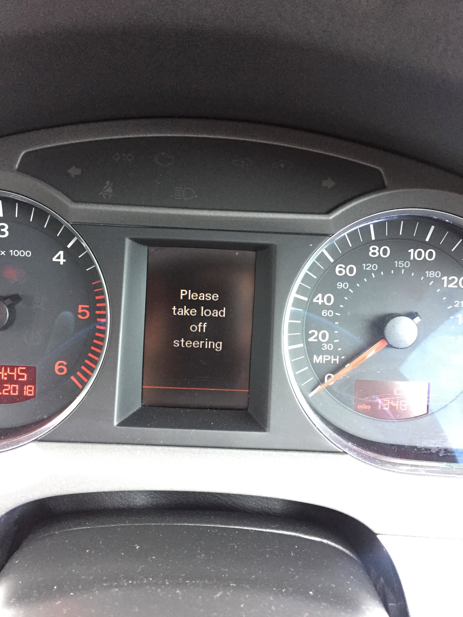

RADEK Posted April 29, 2018 Share Posted April 29, 2018 Hi guys, I do have problem with my Audi A6 c6, 2l diesel. I parked the car today and it came up message : please take load off steering, then the car won’t start at all. I can turn the steering wheel but with clicking noice. Once put the key in ignition then it shows just that message and makes some weird few clicks and not start. I found out that it can be problem with steering column. Any suggestions? Thanks Quote Link to comment Share on other sites More sharing options...

niedzial1983 Posted April 29, 2018 Share Posted April 29, 2018 Steering lock needs to be replaced :) Quote Link to comment Share on other sites More sharing options...
Magnet Posted April 29, 2018 Share Posted April 29, 2018 Hello Radek, I might be well worth getting the battery voltage/ condition checked, and if necessary the alternator output (comparatively cheap/free) before any other expenditure. Kind regards, Gareth. Quote Link to comment Share on other sites More sharing options...

Kinni Posted December 28, 2020 Share Posted December 28, 2020 I had the same issue to keep it Plain and simple just check your power steering fluid Quote Link to comment Share on other sites More sharing options...
