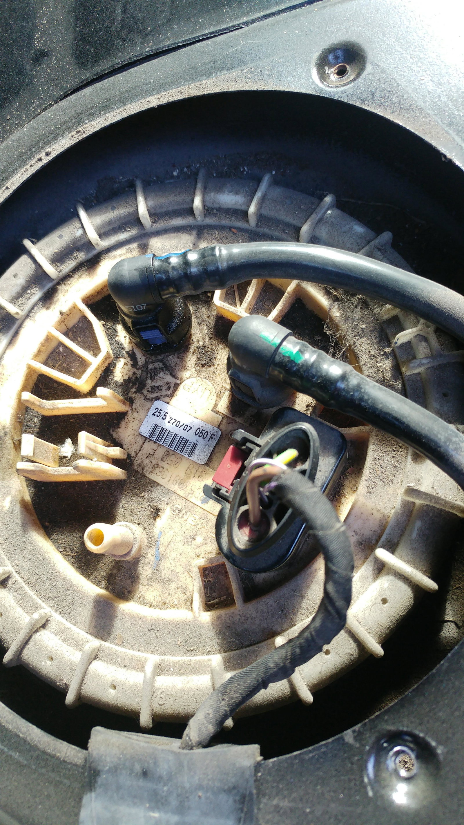

WPAWS Posted August 8, 2018 Author Share Posted August 8, 2018 On 5/18/2018 at 8:48 PM, niedzial1983 said: So your quattro has 2 fuel senders ... 90% of the time its not the sender that fails. You need to yank the bench out. Under there on passenger side there is a plate hold by 3 screws , undo that. Get some contact cleaner from halfords and unpug the wirring harness clean and plug back. If this does not help then let me know there is a stage 2 to this repair 🙂 @niedzial1983 started to happen again as you say, i cleaned connector with contact cleaner but still no gauge whats stage 2 please was this the connector i was meant to mine is on drivers side passenger side is just a round white plate Quote Link to comment Share on other sites More sharing options...
niedzial1983 Posted August 8, 2018 Share Posted August 8, 2018 3 hours ago, Paul A6 said: @niedzial1983 started to happen again as you say, i cleaned connector with contact cleaner but still no gauge whats stage 2 please was this the connector i was meant to mine is on drivers side passenger side is just a round white plate You need to undo the plastic ring and take out the sender . There is a connector there that need cleaning or cutting out and solder the cables Quote Link to comment Share on other sites More sharing options...

niedzial1983 Posted August 8, 2018 Share Posted August 8, 2018 Same as last time. Take it out and have a look Quote Link to comment Share on other sites More sharing options...
niedzial1983 Posted August 8, 2018 Share Posted August 8, 2018 Plastic ring can be a pain to remove without an "audi special key ". I used a bot of wood and a hammer on mine 🙂 Quote Link to comment Share on other sites More sharing options...
WPAWS Posted August 9, 2018 Author Share Posted August 9, 2018 my garage has recommended a replacement sender he is sourcing the part then quote me Quote Link to comment Share on other sites More sharing options...
