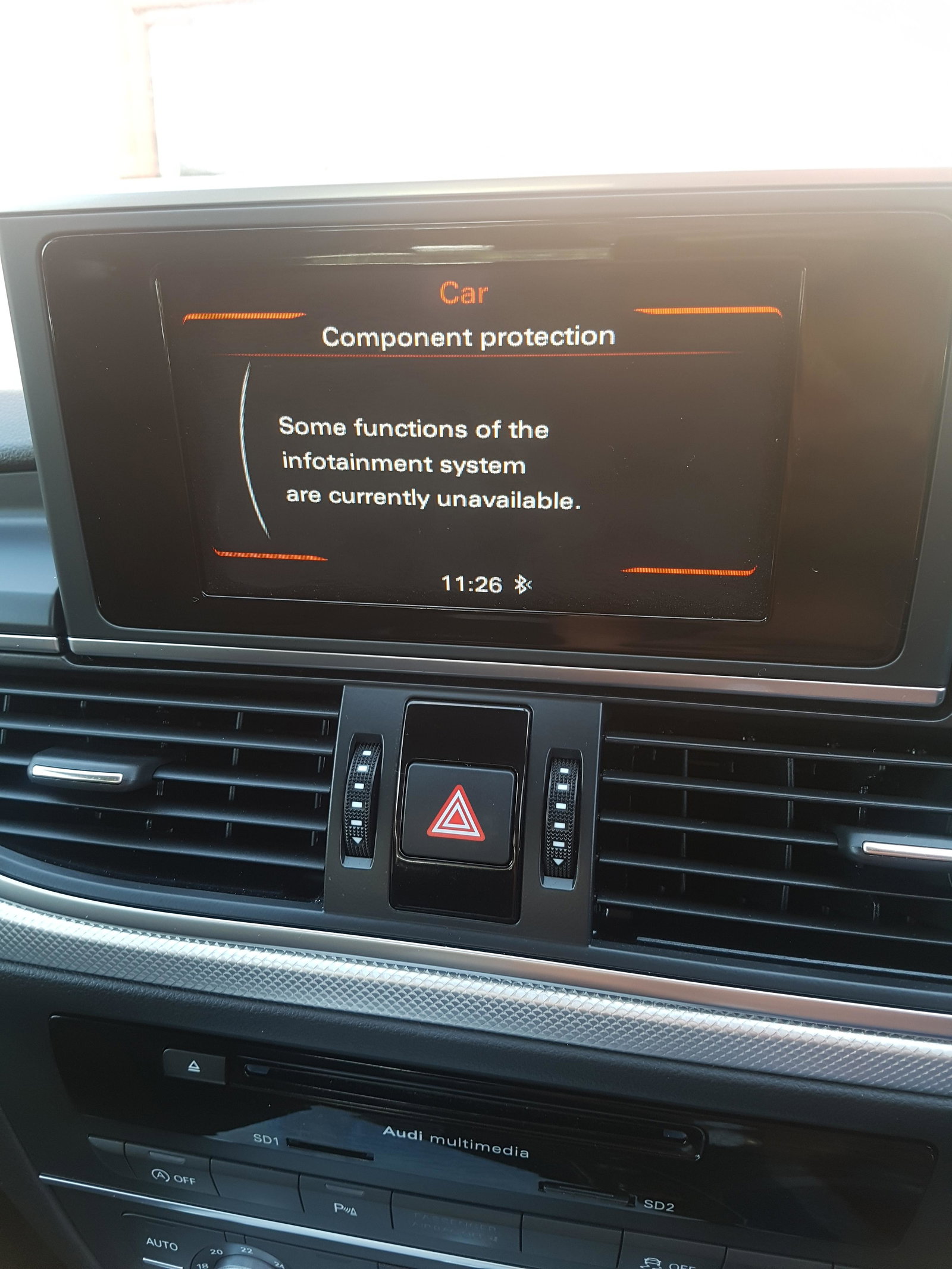

David a6 Posted July 6, 2018 Posted July 6, 2018 Just got this car and the radio Coming on for 20 secs when car is started then giving me this .message any one any idea what it could be thanks
WPAWS Posted July 6, 2018 Posted July 6, 2018 Welcome to the forums David Nice friendly atmosphere here with plenty of Audi owners to help where they can. i came across this which may shed more light on your problem http://www.audi-resource.com/componentprotection.php Please be sure to give the forum rules a quick view Paul 1 1
Tomo1971 Posted July 7, 2018 Posted July 7, 2018 So looks like the previous owner, or garage who sold it has changed something on the MMI etc with a 2nd hand unit - if a dealer, ask them to sort it, if a private sale, I suppose your only hope is an Audi dealer as a first port of call.
niedzial1983 Posted July 7, 2018 Posted July 7, 2018 Get a vcds scan with will tell you what module is under component protection. Once you know its either audi or someone who can remove it. It can be costly . Component protection is to protect modules or units like cd changer etc from theft and using it on another audi...
David a6 Posted July 8, 2018 Author Posted July 8, 2018 Sorted the dealer got it fixed for me, now I have a working radio 🙂 thanks guys
