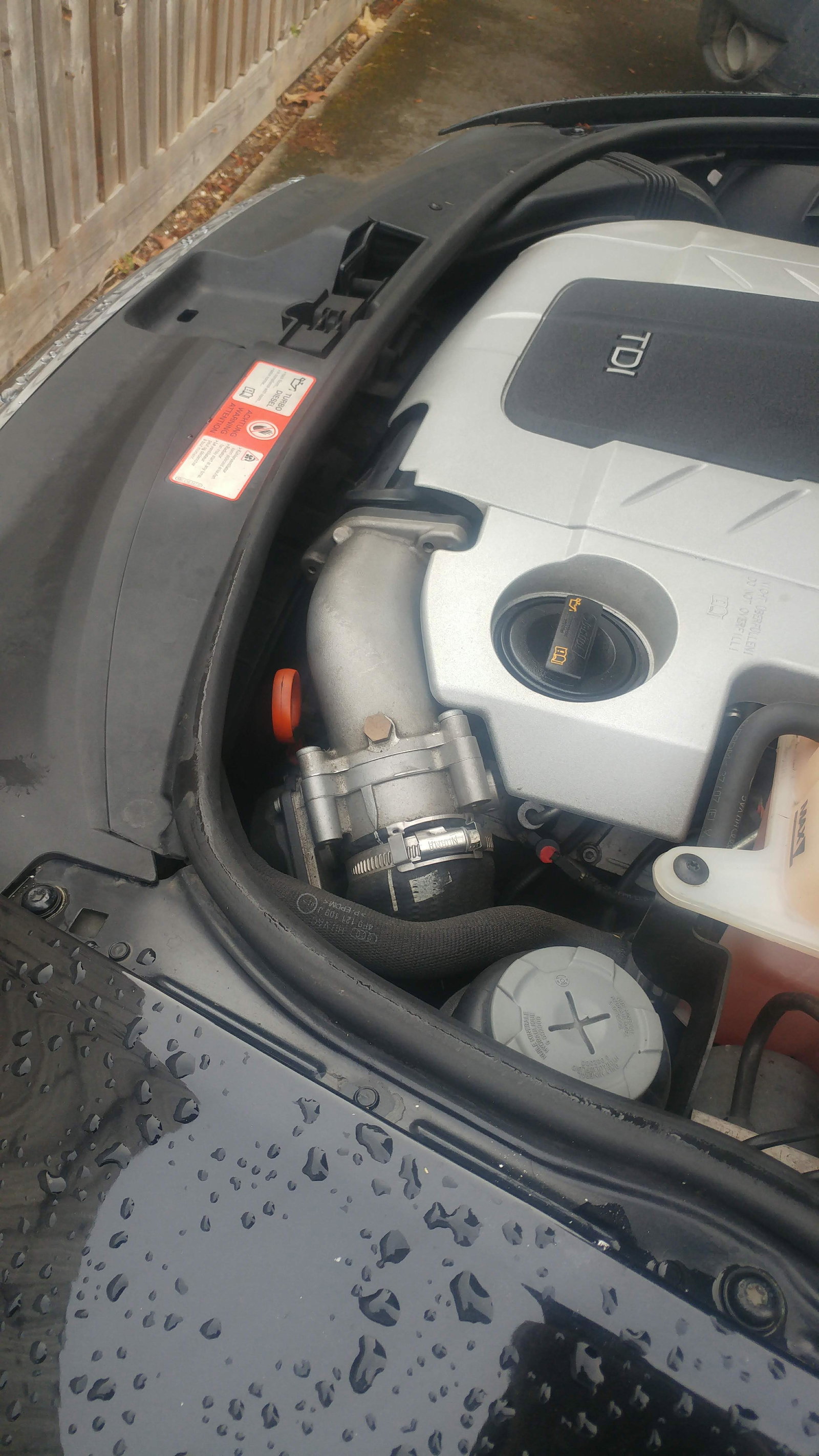

Critical_mass Posted July 14, 2018 Author Posted July 14, 2018 Just now, Paul A6 said: my 3.0 has a dipstick But the 2.7 is sensors? Can't see a dipstick in any of the engine bay pics I've looked at.聽
Critical_mass Posted July 14, 2018 Author Posted July 14, 2018 Ah OK just hidden from view. Non of the pictures show that angle. That's good to know - a nice simple dipstick.聽
