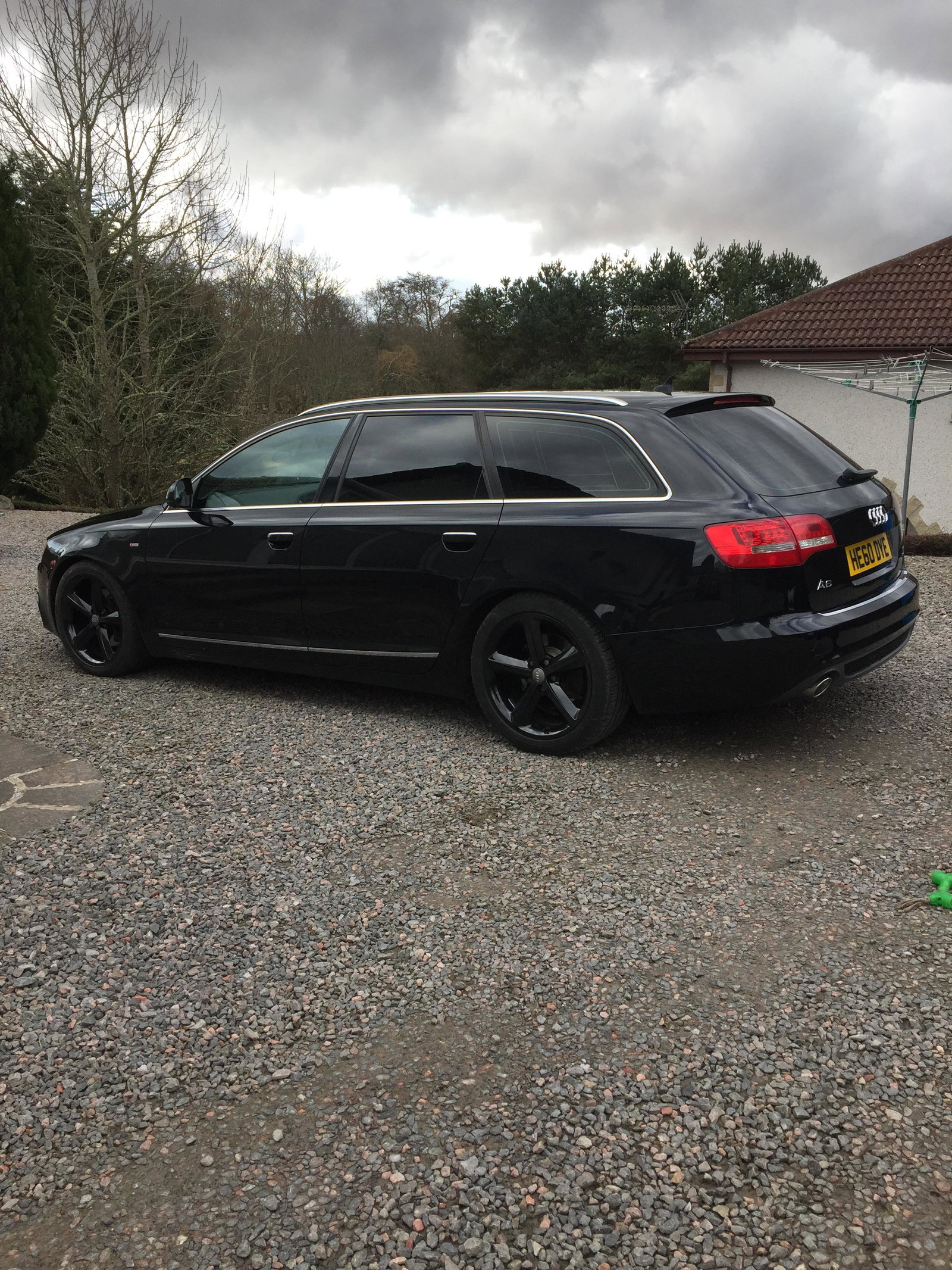

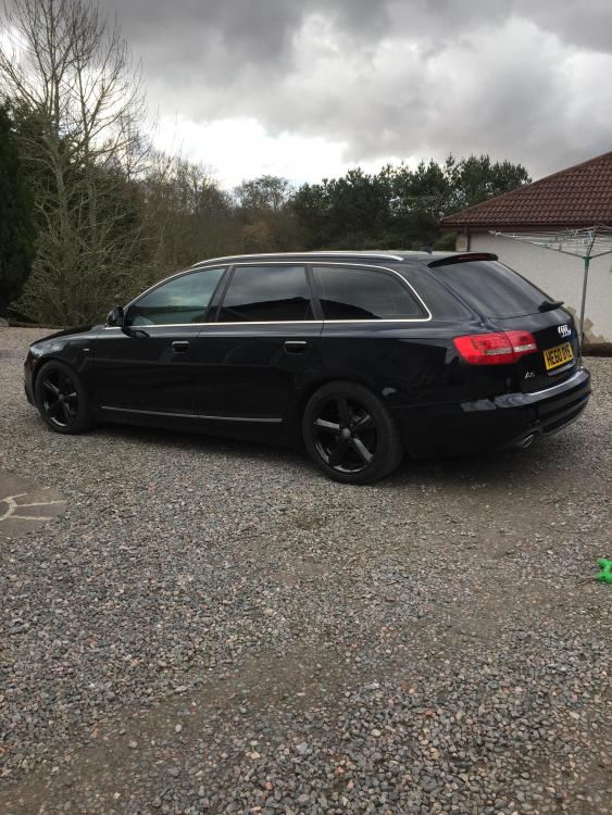

didi Posted August 10, 2018 Share Posted August 10, 2018 hi guys, just signed up,need some info please,can you fit standard coil spring to a6 avant 2.7 tdi s line quattro,2011,need it raised up a bit,just too low for some of the places i have to go with car,its lowered springs thats on it,any advice much appreciated Quote Link to comment Share on other sites More sharing options...
niedzial1983 Posted August 10, 2018 Share Posted August 10, 2018 Post a pic from the side so we can see how it looks like . On sline you will have sport suspention -30 . I belive the shocks are shorter than the standard Quote Link to comment Share on other sites More sharing options...
didi Posted August 10, 2018 Author Share Posted August 10, 2018 yeah it's lowered springs thats on it,standard springs will be longer,will they fit is what i need to know,will try upload photo,not sure how to do that Quote Link to comment Share on other sites More sharing options...
didi Posted August 10, 2018 Author Share Posted August 10, 2018 26 minutes ago, didi said: yeah it's lowered springs thats on it,standard springs will be longer,will they fit is what i need to know,will try upload photo,not sure how to do that Quote Link to comment Share on other sites More sharing options...
niedzial1983 Posted August 10, 2018 Share Posted August 10, 2018 That looks low... Quote Link to comment Share on other sites More sharing options...
didi Posted August 10, 2018 Author Share Posted August 10, 2018 there is photos on niedzial but dont no if you can see them Quote Link to comment Share on other sites More sharing options...
didi Posted August 10, 2018 Author Share Posted August 10, 2018 we must have posted at same time,yeah it is low, tooo low Quote Link to comment Share on other sites More sharing options...
niedzial1983 Posted August 10, 2018 Share Posted August 10, 2018 What wheel is that ? 18"? Quote Link to comment Share on other sites More sharing options...
didi Posted August 10, 2018 Author Share Posted August 10, 2018 yeah think its 18,s Quote Link to comment Share on other sites More sharing options...
niedzial1983 Posted August 11, 2018 Share Posted August 11, 2018 I think you should go back to sline springs. I bet some one have put some lowering springs and it sits like this now. Quote Link to comment Share on other sites More sharing options...

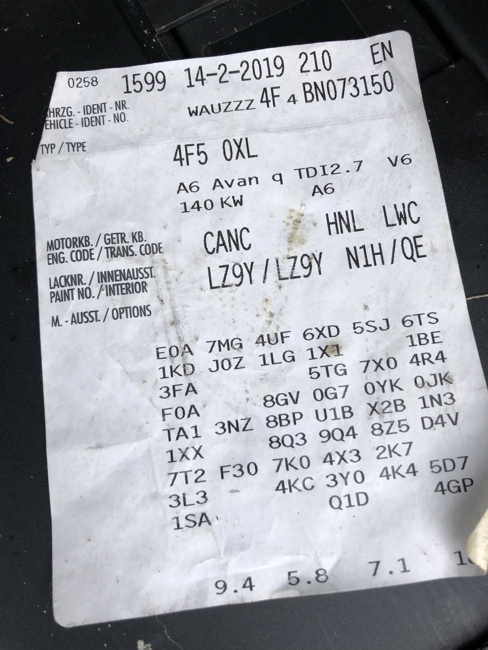

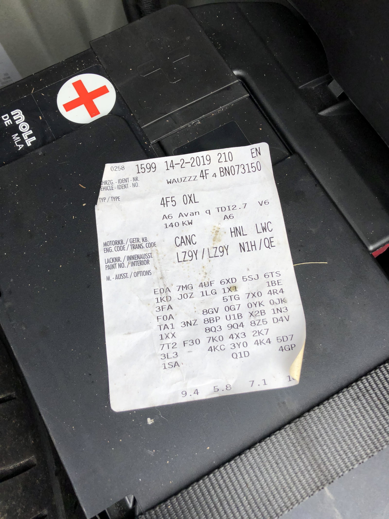

niedzial1983 Posted August 11, 2018 Share Posted August 11, 2018 Under the spare wheel you have a build sticker . It has PR codes on what is instaled on the car . One of the codes in suspention . Decode the sticker here and will tell you what original suspension you had. http://prsearch.planetvag.com/ Quote Link to comment Share on other sites More sharing options...
didi Posted August 11, 2018 Author Share Posted August 11, 2018 this is a photo of the sticker but not sure which numbers i need to use,can you tell me please Quote Link to comment Share on other sites More sharing options...
niedzial1983 Posted August 11, 2018 Share Posted August 11, 2018 Just enter all the numbers in the boxes on the link i have send you Quote Link to comment Share on other sites More sharing options...
niedzial1983 Posted August 11, 2018 Share Posted August 11, 2018 1BE - sport suspention -20mm Quote Link to comment Share on other sites More sharing options...
didi Posted August 11, 2018 Author Share Posted August 11, 2018 have you just done it for me Quote Link to comment Share on other sites More sharing options...
