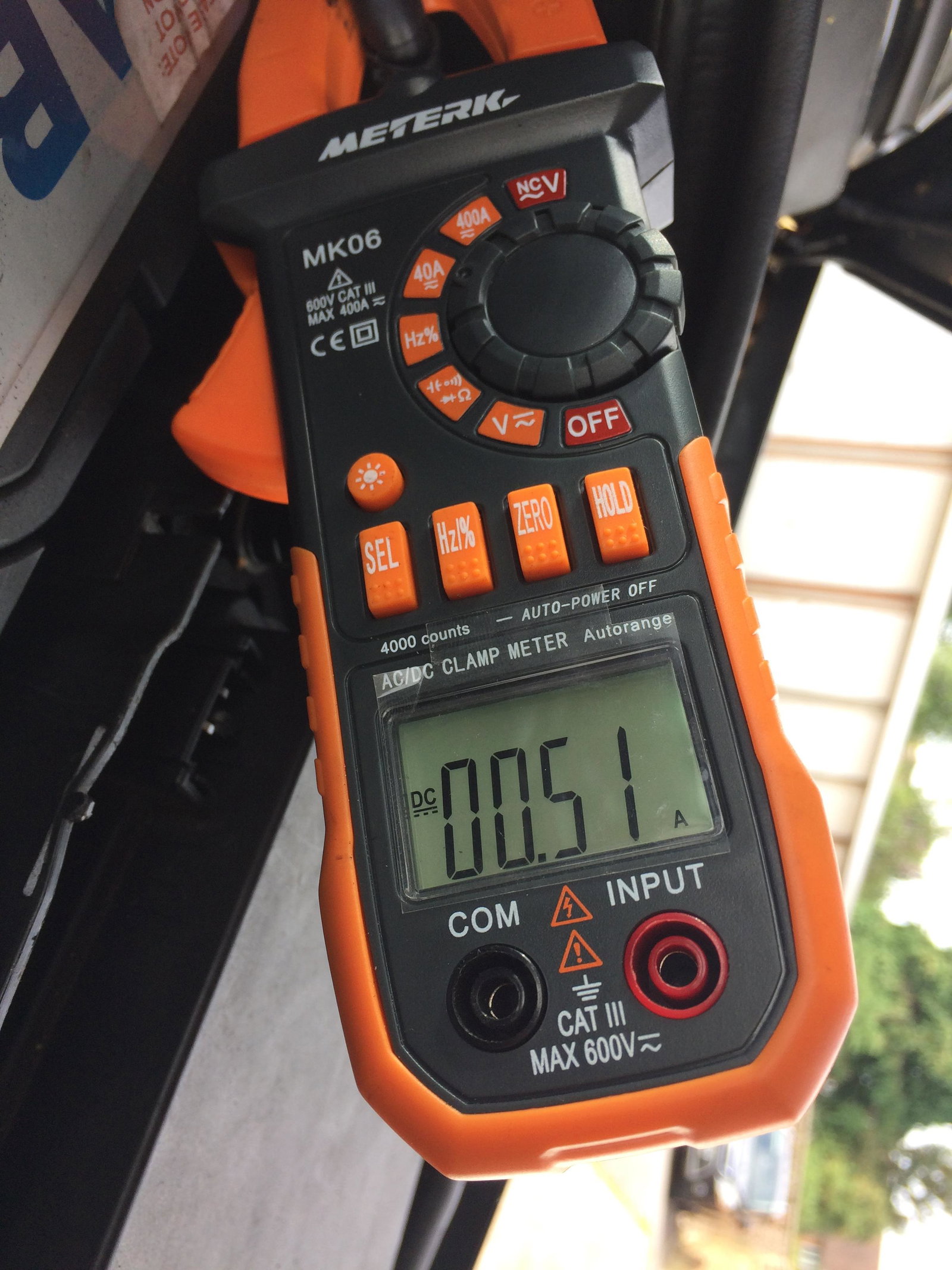

den310 Posted August 20, 2018 Author Posted August 20, 2018 Ok had another quick look today and the current drain remains at around 500mA after locking the car and waiting a while. I tried it with the fuse for the center convenience unit out and no change. I cannot remove one at a time when the car is locked so that makes things tricky. The parrot bluetooth thing only comes on when the igntion is on so that's not a problem so something is drawing around 0.4 to 0.45 Amps. I do have an issue with the ESP and steering as the lights are on the dash. Just waiting to get the code reader again to get the errors logged in VCDS.
den310 Posted August 20, 2018 Author Posted August 20, 2018 Meter reading when locked and after 10 minutes.
Magnet Posted August 20, 2018 Posted August 20, 2018 Hello Dennis, Um, aporox. 500mA. ( half an amp) draw then. That's equivalent to around 5 to 6 watts - not insignificant. Daft-things first checks. Remove glove box bulb incase micro switch is not switching off. Same with boot light, but I would remove one at a time and test, otherwise you won't know which is the culprit if the current draw falls. Sat nav? Known these (boxes) to cause such issues if in the boot and moisture has got in and created 'white rust' deposits on the printed curcuit board. Unplug? Just a couple of extra pointers. Useful though?? Kind regards, Gareth.

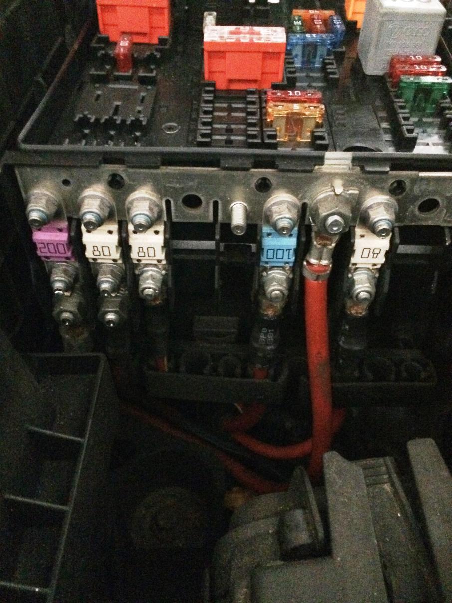

den310 Posted August 28, 2018 Author Posted August 28, 2018 Hi. Sorry for the delay, other stuff happening. This car does automatically lock after a minute (or less, not timed it) I think if unlocked and then no door has been opened. Can anyone tell me what circuits are on the fuse links on the front of the engine bay fuse box? I guess one may be to the alternator but don't know about the others. I ask as may have to disconnect them one at a time to see what happens.
cliffcoggin Posted August 28, 2018 Posted August 28, 2018 Judging by the size of the cables and the fuse ratings (80-100 amps) they have got be the starter motor circuit, and possibly the alternator.
den310 Posted August 28, 2018 Author Posted August 28, 2018 Yes that will be another, the starter motor circuit (probably the 200 Amp fuse?), the alternator and there are 3 more.
