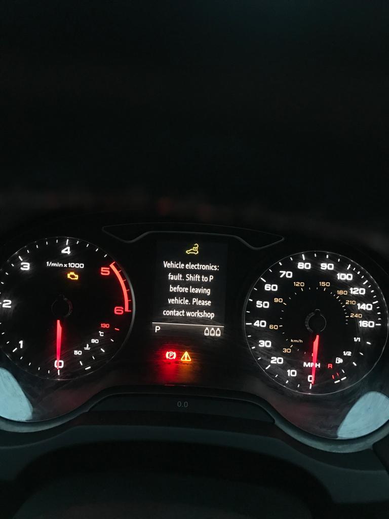

Hi just had this popped up a few times what could it be I have an 2014 a3 Quattro.
TIA
Hello Anamul,
Wouldn't  be sure, but sometimes the Park isolator switch can become worn, and although the lever is in Park, the switch may not be properly 'made'. You've probably done this, but try wiggling the selector lever when in Park to see if this does anything for the message.
