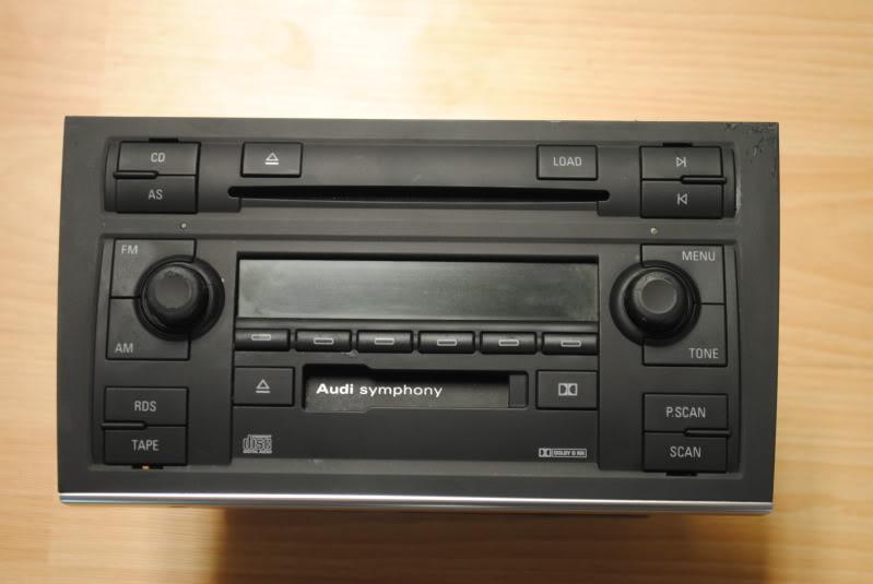

Mylo223 Posted January 12, 2019 Posted January 12, 2019 Hi there, I have a audi a4 b7 2005. My current radio is a double din cassette player and CD changer. I really want to upgrade it for something newer with Bluetooth capabilities and also satnav. There are plenty of choices on the old eBay but I was wandering if anyone has upgraded theirs and have some good recommendations. Many thanks for reading post if you can help I would really appreciate it! Attached image is my current unit. Cheers.
Steve Q Posted January 12, 2019 Posted January 12, 2019 Hi Myles theres quite a few touch screen radios on the market now which incorporate apple car play or Android equivalent. This then allows you to use your phone satnav through them. Again you get what you pay for and I think good ones are around £300. Cheers Steve

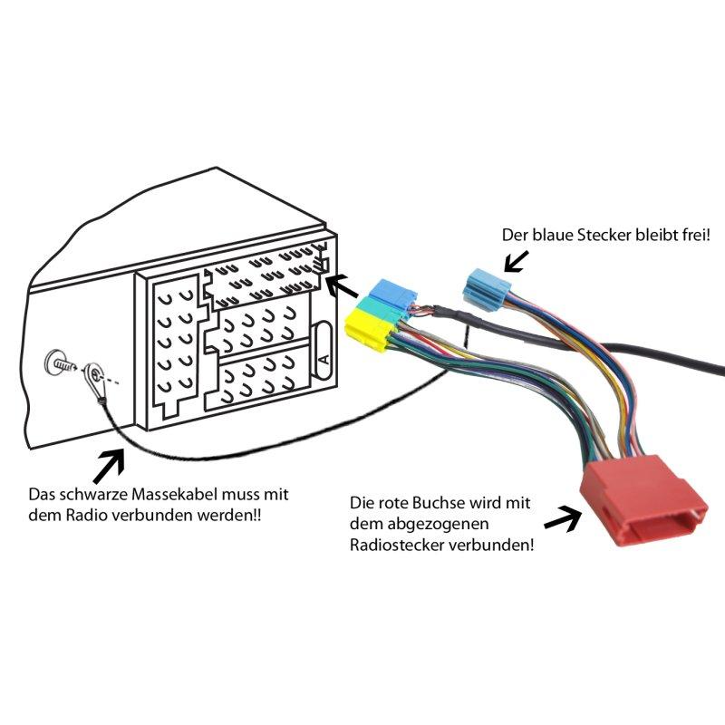

Tarmo Posted May 26, 2024 Posted May 26, 2024 8 hours ago, WhisperingAl said: Hi I have an A4 B7 with a Concert radio. I don’t want to change it for something that looks out of place but I want to play music from my iPhone and retain the steering wheel controls. Any ideas? I'd take something from here. Depending on what connector you have behind your radio. Basically it emulates cd changer and adds bluetooth connectivity that way. https://www.connects2.com/products/steering-wheel-control-interfaces/vehicle/Audi/A4

WhisperingAl Posted May 29, 2024 Posted May 29, 2024 On 5/26/2024 at 6:00 PM, Tarmo said: I'd take something from here. Depending on what connector you have behind your radio. Basically it emulates cd changer and adds bluetooth connectivity that way. https://www.connects2.com/products/steering-wheel-control-interfaces/vehicle/Audi/A4 Hi I have purchased and fitted a similar device and connected via Bluetooth but I have no way to start playing. If I select CD it simply says No Disc
Tarmo Posted June 2, 2024 Posted June 2, 2024 Can you post a link? And did you plug in the connector for cd changer?

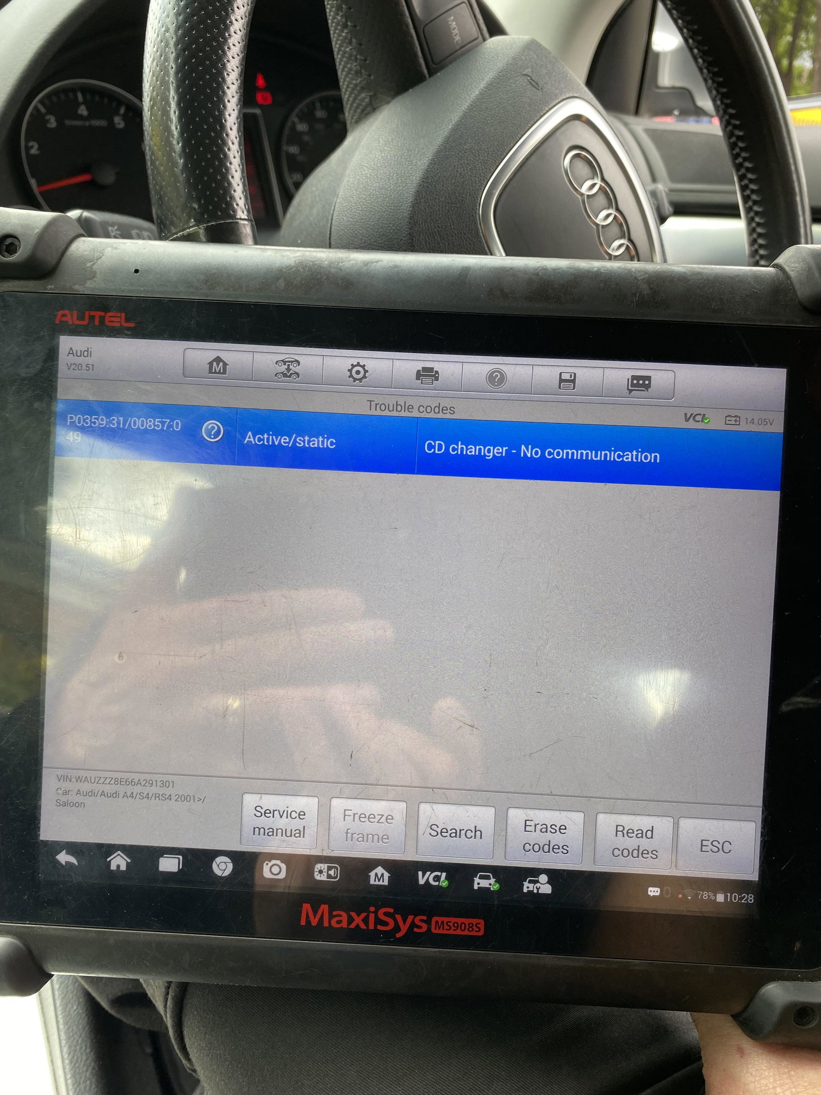

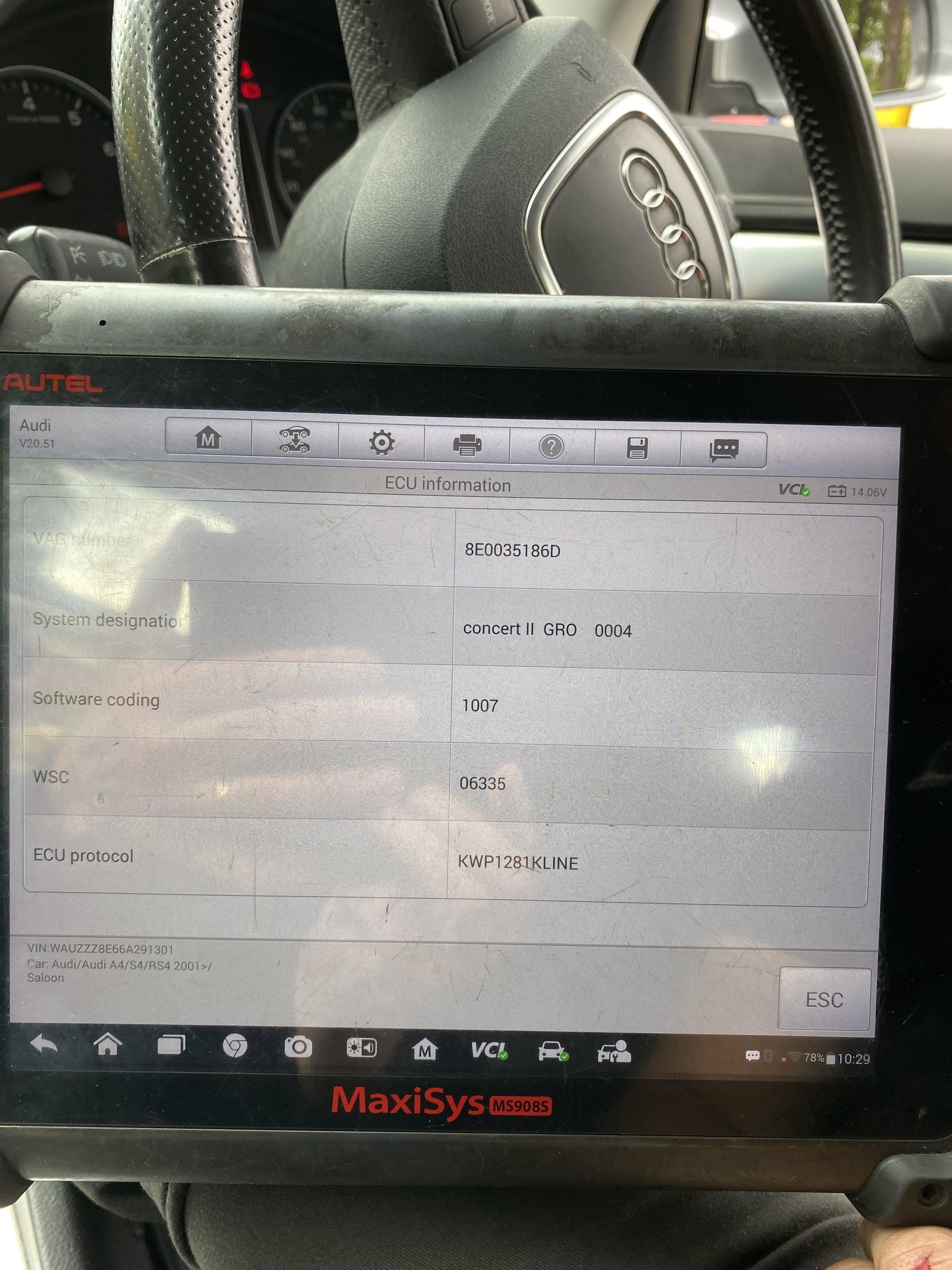

WhisperingAl Posted June 3, 2024 Posted June 3, 2024 12 hours ago, Tarmo said: Can you post a link? And did you plug in the connector for cd changer? I connected the device as specified by the manufacturer. That is, a blue connector which I believe is the CD auto changer. However I need to tell the car that it has a CD changer via programming. A mechanic I use is going to plug into it on Thursday. I will keep you posted.
WhisperingAl Posted June 20, 2024 Posted June 20, 2024 Hi. Mechanic changed programming to include CD auto changer but the item still did not work. I bought a different unit and it worked straight away. I believe, or guess, one unit replaces the auto changer and one works alongside. The one that works has more wires in the blue connector. Thought I would update for anyone who is interested.
