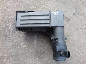

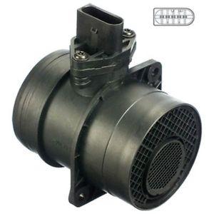

Steve Q Posted January 29, 2019 Posted January 29, 2019 11 hours ago, A3slineTDI said: Steve my driving is mostly economical long journeys, occasionally putting my foot down for fun! Yeah i dont think there is an actual problem with the car neidzial, i think it could just be the sensor but how can you fix that? Well I think we can safe to say it's not dpf related in light of the driving you do. Piotr is probably right with the MAF sensor. This sensor monitors airflow and you would have had to take it off the old airbox and then fitted to the new pipe work for the cold air feed. The mad will look like the one in the attached pic. The second pic shows the MAF sensor attached to the old airbox. The bit sticking up is where the electrical connector plugs in. Hope I've helped and hope that all makes sense 🙂
