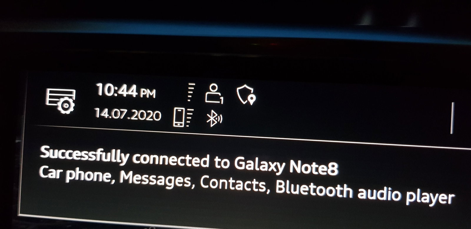

MartinLHW Posted July 14, 2020 Posted July 14, 2020 @Jenna @Wooks63 Got car back today after they replaced the NOx sensor under warranty. They also updated the firmware for the engine ECU and what a difference it's made. Seems to be pulling away much better and with smoother gear changes too. They also updated the MMI software and now i have an extra icon displayed next to the user profile icon. Looks like a shield with a location pin on it. Any ideas what this is? Still haven't been able to get Amazon Alexa to work in it. The guy at the service desk asked two sales advisors but they too had no idea either. Thanks
Jinxit Posted July 15, 2020 Posted July 15, 2020 The shield is for the privacy settings for connecting to Audi and the myAudi app.
Wooks63 Posted July 15, 2020 Author Posted July 15, 2020 6 minutes ago, Jinxit said: The shield is for the privacy settings for connecting to Audi and the myAudi app. So is there any way to get rid of it, or will it always be there? I’ve pressed it, but it doesn’t seem to take me anywhere sensible 😁. Regarding the performance, I’ve had some good drives now and the car is definitely a lot better. I’ve kept it in Dynamic mode. I did have one scare on the North Circular the other day. It was a 40mph limit and I was in a lane doing 30mph. A gap appeared in the overtaking lane that I knew should be safe for me to get into. I pulled over into it and put my foot down to overtake and nothing happened! It was the usual second or so delay before it accelerated. In the meantime, a car that was coming up behind me beeped me. So while the stationary pulling away is vastly improved, it’s worrying that accelerating from higher speeds isn’t. I will report this to my Audi centre and hope that another update comes out which fixes this issue.
Jinxit Posted July 15, 2020 Posted July 15, 2020 I haven't seen a way to remove the shield. At first I thought it was telling me I had privacy restrictions in place but It stays even if you allow all access. Maybe try turning all access off? it may go then but I think that would then disable the google maps? I have only had my car 5 weeks and due to being furloughed have hardly used it. I have had time to go through the manual though which is how I know what it symbolises as I was curious as well. With regard to the sluggish behaviour, the 40 TDI with S ironic does not appear to suffer. At least I don't think mine does. I have come from a Passat with the same gearbox though. I go back to work tomorrow so will be back to 120 miles a day so will get a better understanding of how the car works and drives.

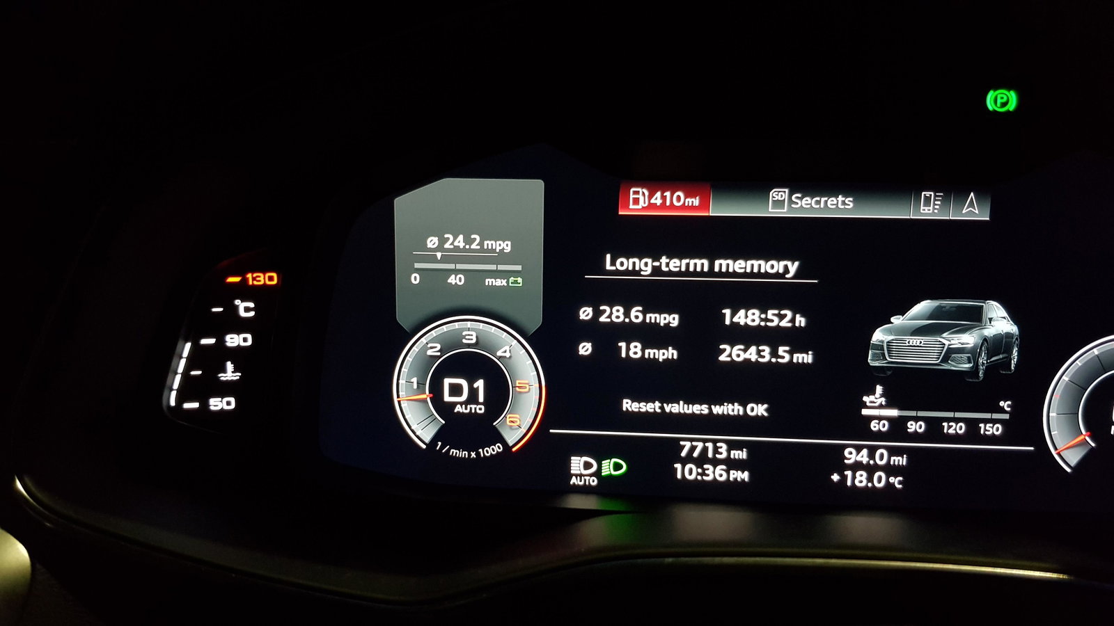

MartinLHW Posted July 19, 2020 Posted July 19, 2020 Any one else noticed this? The permanent temperature guage on the left does not match that of the one displayed inside the virtual cockpit? You'd think both are read using the same thermometer right? Now that I've noticed it, I've checked it over the space of the week and seems to be always the case.
Wooks63 Posted July 19, 2020 Author Posted July 19, 2020 5 hours ago, MartinLHW said: Any one else noticed this? The permanent temperature guage on the left does not match that of the one displayed inside the virtual cockpit? You'd think both are read using the same thermometer right? Now that I've noticed it, I've checked it over the space of the week and seems to be always the case. The left hand temperature is the engine coolant temperature, whereas the virtual cockpit one is the oil temperature. The symbols are different.
