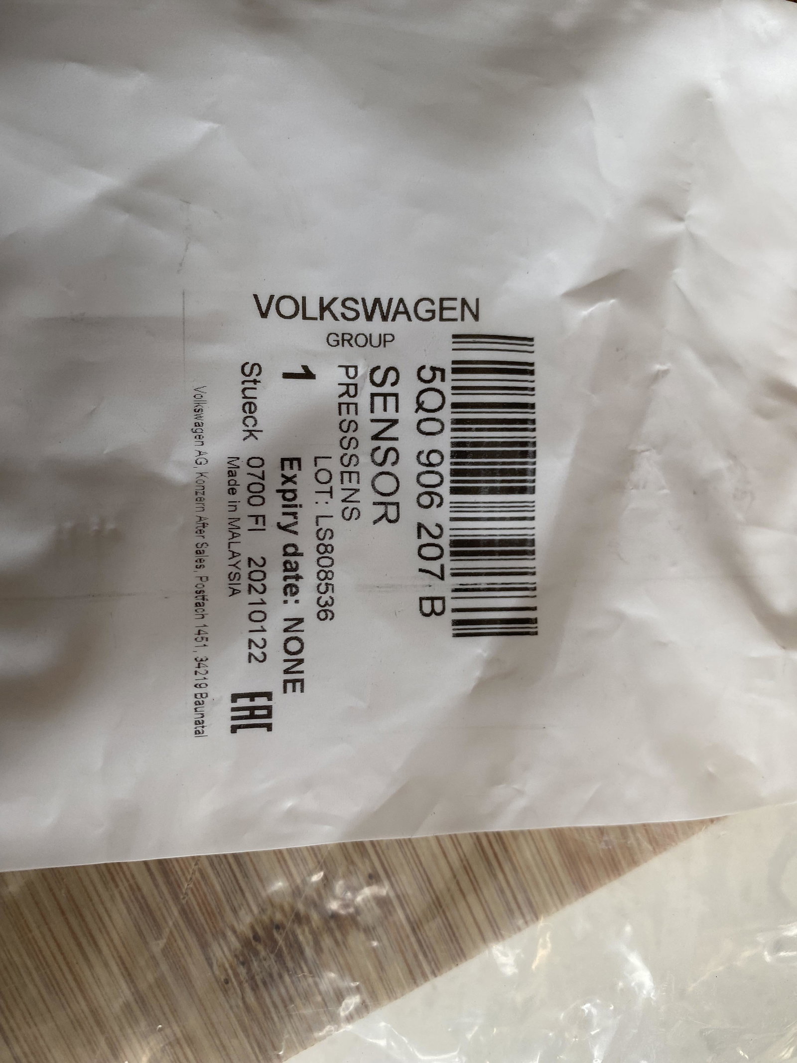

MarkDriver Posted June 24, 2021 Posted June 24, 2021 My part arrived today from Cardiff Audi. Following the video instructions I've changed this over and had a quick test drive, no more warning error! The only difference I had was there was no release of pressure when I removed the old one. BIG BIG BIG THANKS TO AMBROSE! You are an every day hero. Mark 1

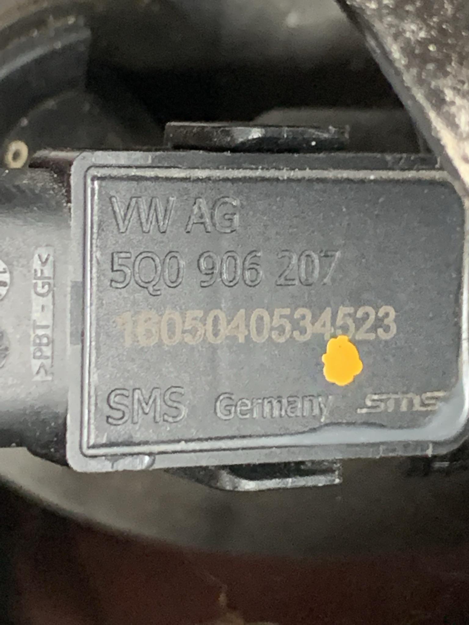

jonnob Posted July 5, 2021 Posted July 5, 2021 Fixed mine with the suggest part in 5 minutes 5Q0 906 207 B

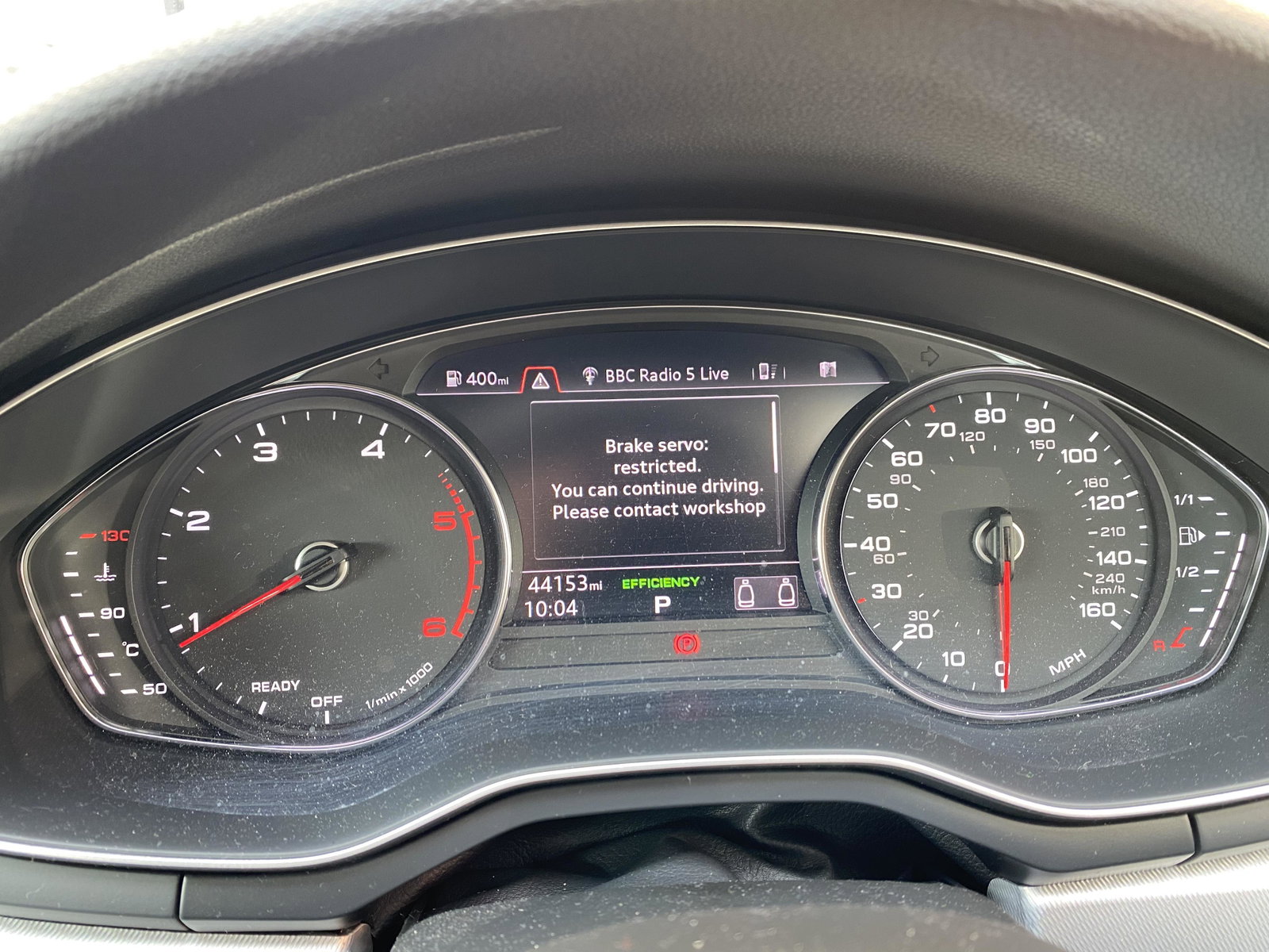

Nicholas fraser Posted July 20, 2021 Posted July 20, 2021 Just bought a A4 Allroad 2017 and just got the message of Brake Servo: restricted phone the garage and they said not to drive on it bra sue you only get so many activations until it fails and your car seizes. Anyone know roughly how many that would be ? because I’ve had to use my car in emergencies for work

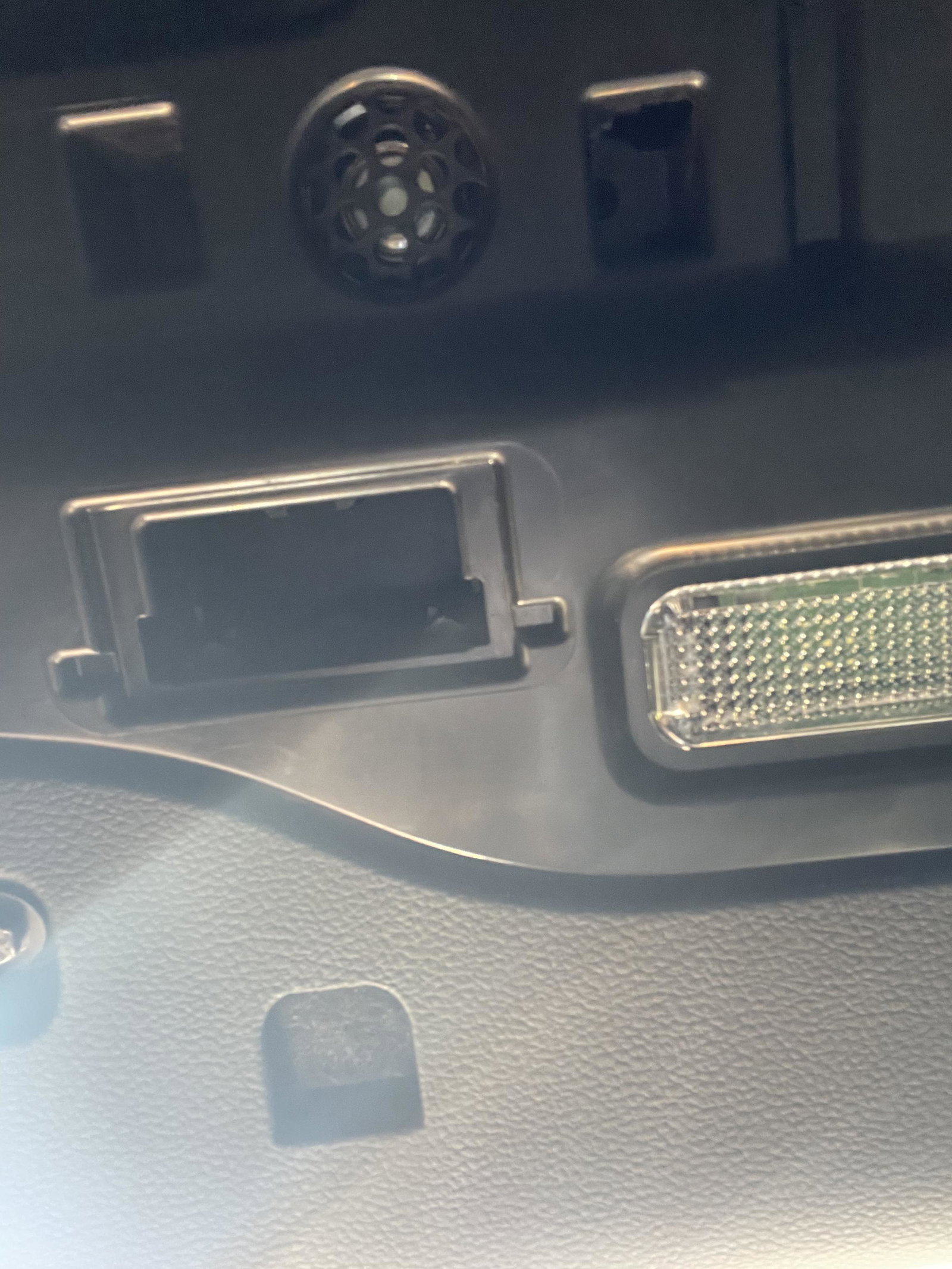

Nicholas fraser Posted July 22, 2021 Posted July 22, 2021 I don’t know if it’s worth waiting for my appointment or just doing it my self but my only other problem is I have to obd plug and I want them to figure that out too whilst it’s under warranty and I have looked everywhere for it and behind the panel

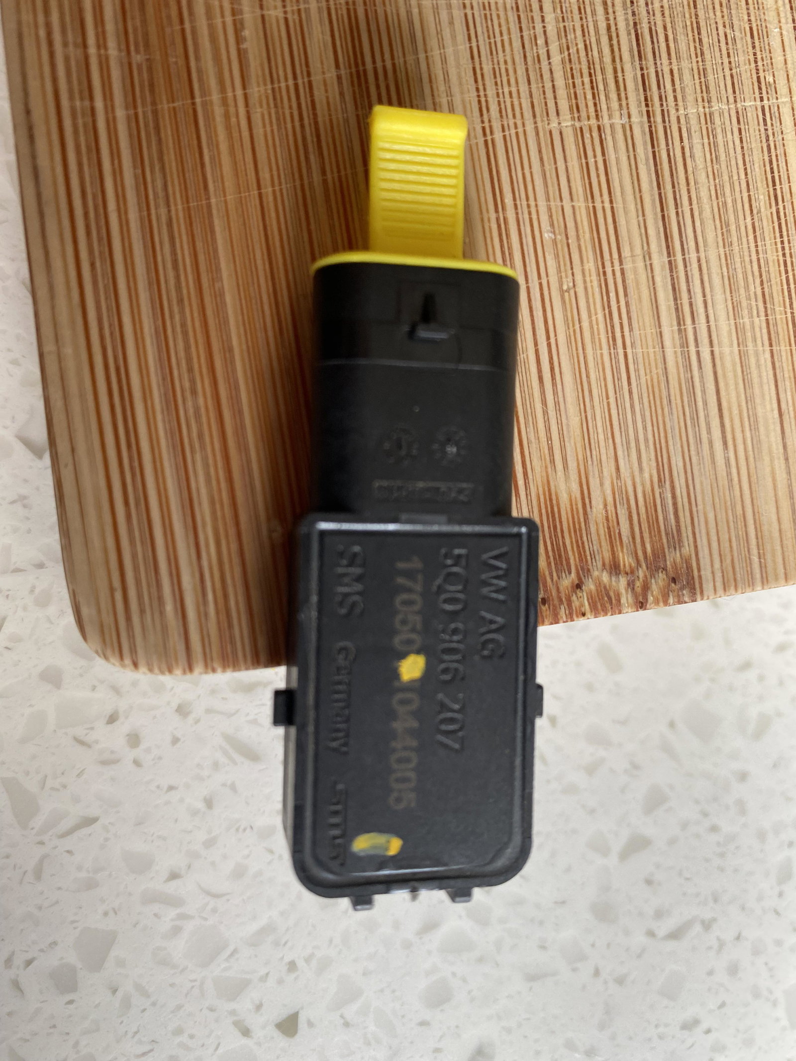

Speedbird Posted July 22, 2021 Posted July 22, 2021 I had exactly the same issue as all the rest on this thread. I have Audi A5 2.0 Diesel 67 plate coupe. I read the forum, rang the dealer and asked how much they said £165 to diagnose , yeah right, so i ordered the part Photos attached, £79.20 collected it within the hour, it take less that 5 minutes yes FIVE minutes to complete the job. All warnings gone, brakes feel correct again. SS showed up so switched off and re-started and that also was gone. Saved at least £95 from the diag alone. It is so simple it's embarrassing. Thank you to Simon Ryder for first showing photos. Note the yellow end is just a terminal protector nothing more. The bag is what it came in with barcode number and the dash is what was bing displayed this morning. Thank you. 1

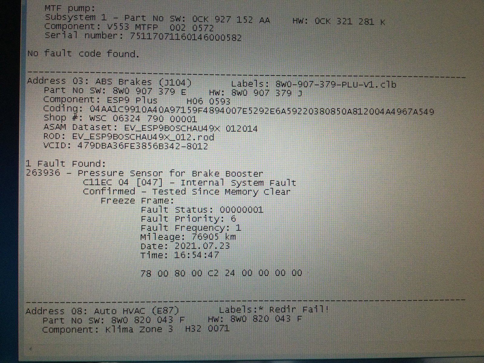

Chrisbee Posted July 24, 2021 Posted July 24, 2021 Hi new to this forum, sorry if this has been covered before as there are so many posts about this issue, I had the dreaded stop start and restricted braking, on my Audi A4 ultra 2016 a couple of days ago, it had been standing for a few weeks. I didn’t drive anywhere, obviously I wanted to get the issue diagnosed. after reading a few of the earlier post about Abs issues,I’m so glad I didn’t drive it. So I Plugged her in with Vcds , I got errors pressure brake sensor fault and the abs module implausible error. so after reading all the earlier post, I needed to get in touch with Audi, so I could get the offending part replaced! with me being out of warranty by a month I didn’t have much choice but try change the boost sensor 5Q0 906 207. Audi parts guy said that part has been superseded by 5Q0 906. 207 B so that was purchased this morning for £79.90, I fitted in probably 5 mins. all is good so far. So obviously Audi have realised there is a big issue across the Audi range with the old type part. So guys get it changed for the new upgraded parts to save any future issues. 2
Steve Q Posted July 24, 2021 Posted July 24, 2021 On 7/24/2021 at 12:16 PM, Chrisbee said: Hi new to this forum, sorry if this has been covered before as there are so many posts about this issue, I had the dreaded stop start and restricted braking, on my Audi A4 ultra 2016 a couple of days ago, it had been standing for a few weeks. I didn’t drive anywhere, obviously I wanted to get the issue diagnosed. after reading a few of the earlier post about Abs issues,I’m so glad I didn’t drive it. So I Plugged her in with Vcds , I got errors pressure brake sensor fault and the abs module implausible error. so after reading all the earlier post, I needed to get in touch with Audi, so I could get the offending part replaced! with me being out of warranty by a month I didn’t have much choice but try change the boost sensor 5Q0 906 207. Audi parts guy said that part has been superseded by 5Q0 906. 207 B so that was purchased this morning for £79.90, I fitted in probably 5 mins. all is good so far. So obviously Audi have realised there is a big issue across the Audi range with the old type part. So guys get it changed for the new upgraded parts to save any future issues. Expand Glad you got sorted 🙂
