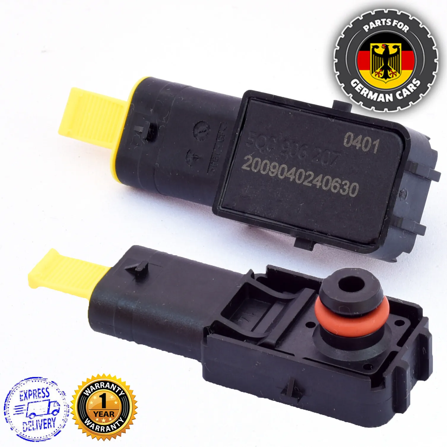

Michael Bennett Posted July 5, 2024 Posted July 5, 2024 Hi all, just fixed the brake servo restricted issue, there are many cheap sensors on eBay, I paid £14.00 and fitted it myself, very simple and straight forward, 10 mins with following pictures and uTube video. Went for a drive and all fixed, no need for an OBD, don't go to Audi if they are asking for £500.00!!!!! 1

Keva Posted August 27, 2024 Posted August 27, 2024 Unlikely, the sensor is under windscreen cowl. But might be worth mentioning to the garage that you only had the problem after the service, to see if they'll do you a good price. It's also very easy to change yourself if you get the part <5mins.

ggdt Posted August 30, 2024 Posted August 30, 2024 (edited) To update this I had the repair done by Audi yesterday. It was just the sensor that needed replacing, no ABS issues thankfully. Total cost of the repair was £336 of which £195 was labour! Fortunately I have a 3rd party warranty which covers some of it so I'll get £176 back. That leaves me £160 out of pocket but if I'd done it myself I'd have paid £102 to buy the sensor from Audi anyway so I'm not to upset about that. Thanks all for the advice, could have been so much worse if I hadn't read this forum 👍 Edited August 30, 2024 by ggdt 1

kh904 Posted August 30, 2024 Posted August 30, 2024 I concur with the other responses! That is horrendous service from Audi! What a rip-off! I purchased a genuine OEM part from Audi for around £90 and it took me less than 5 minutes to replace (no exaggeration)!
ggdt Posted August 30, 2024 Posted August 30, 2024 5 minutes ago, kh904 said: I concur with the other responses! That is horrendous service from Audi! What a rip-off! I purchased a genuine OEM part from Audi for around £90 and it took me less than 5 minutes to replace (no exaggeration)! I'd only have used a genuine OEM part if doing it myself and the cost of that is now £102.60 If I'd not got some of it back under warranty I'd be more annoyed but in reality I've only ended up paying £58 more than if I'd bought the part and done it myself. That doesn't mean that Audi aren't taking the !Removed! here but for me personally it's worked out ok going to them. I'm more annoyed that the part failed in the first place on a 4 year old car with only 27k on the clock! 2
