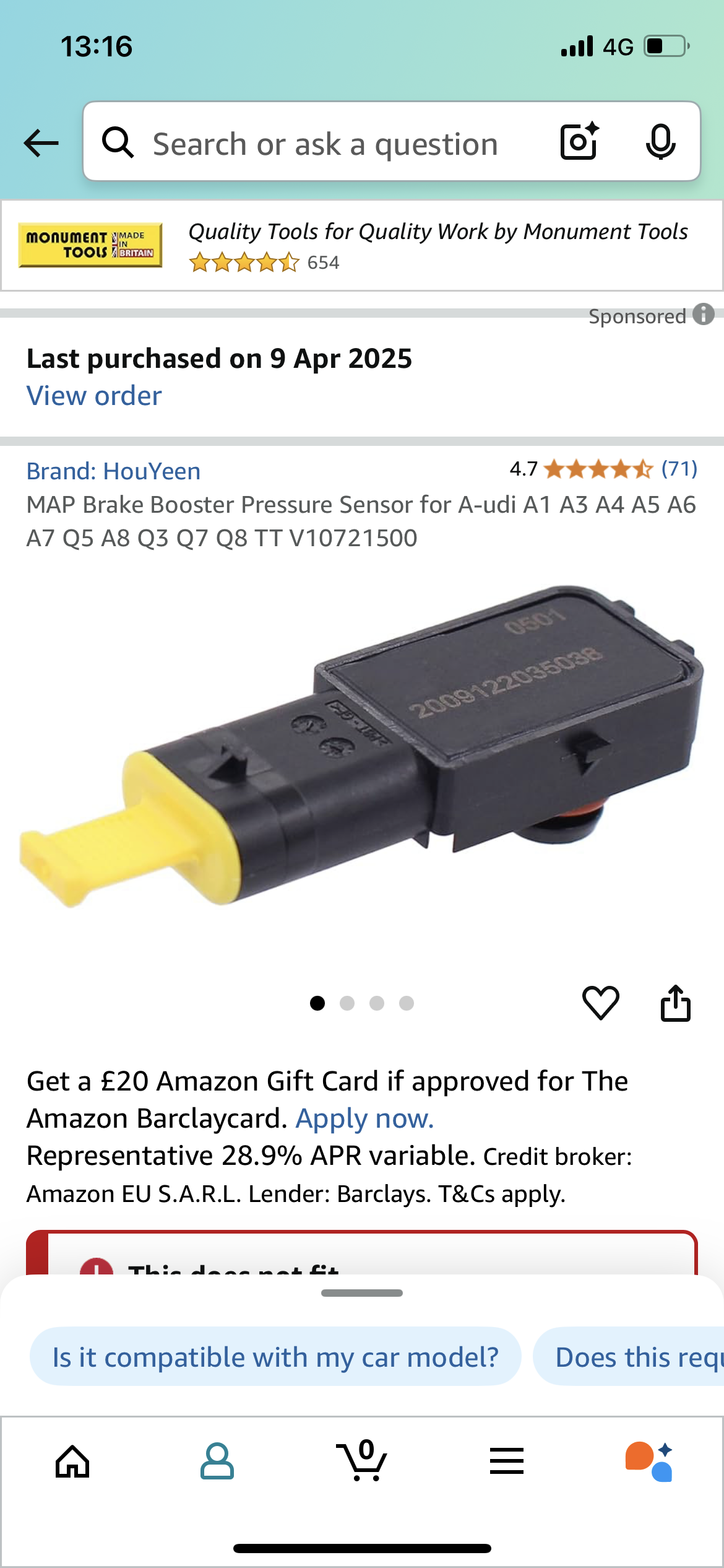

So my car has suffered the same fate, servo sensor from Amazon for £13, looked 100% identical to the removed one, same plastics and markings except the Audi logo had been scratched off which is quite common on aftermarket parts if there made by the same supplier Audi use. Bargain

This is the Amazon seller I bought mine from and appears to be manufactured on same line as the Audi sold ones. materials and markings matched up and even just had the Audi logo marking scratched off. The One on the listing photo  looks like cheap rubbish but that’s not what they sent
