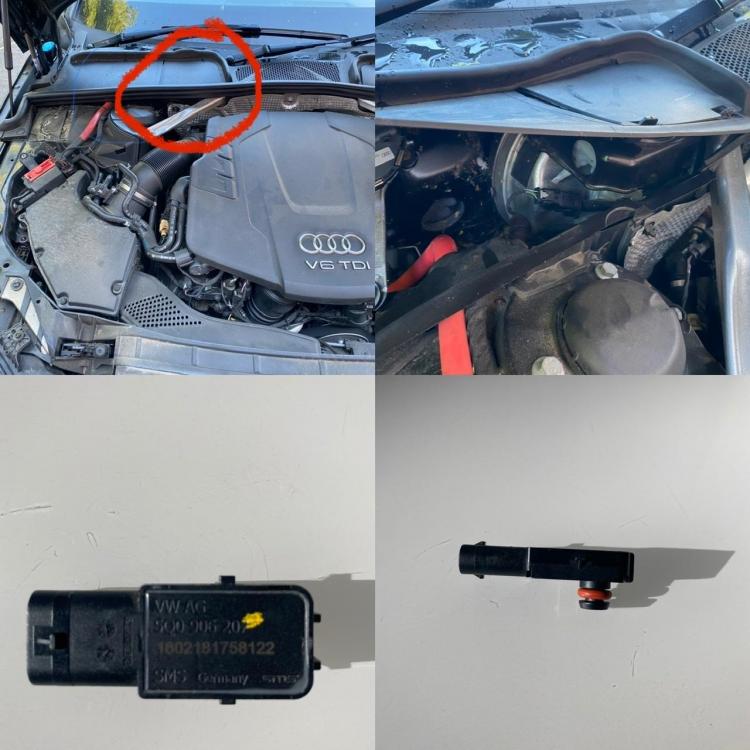

zap263 Posted August 20, 2020 Posted August 20, 2020 On 8/19/2020 at 5:02 PM, Simon Ryder said: Yep, it took literally a minute to unplug the old one and replace with the new one. All the warnings have gone off and the brake feels normal again. Expand Hi Simon.. can you take a pic of what it looks like and where exactly you found it? Will help myself and a lot of folks here loads! Cheers.

Simon Ryder Posted August 20, 2020 Posted August 20, 2020 On 8/20/2020 at 1:57 AM, zap263 said: Hi Simon.. can you take a pic of what it looks like and where exactly you found it? Will help myself and a lot of folks here loads! Cheers. Expand Hope this helps. I’ve circled in red the area of the sensor. It’s under a plastic flap. You have to pull the rubber edge off to lift up. The sensor pulls vertically off. You then slide a plastic holding clamp off the other end. Just reverse the process to put the new one back in. It’s really simple and annoying that everyone seems to want to charge a couple of hundred pounds for this??!? 2 1
