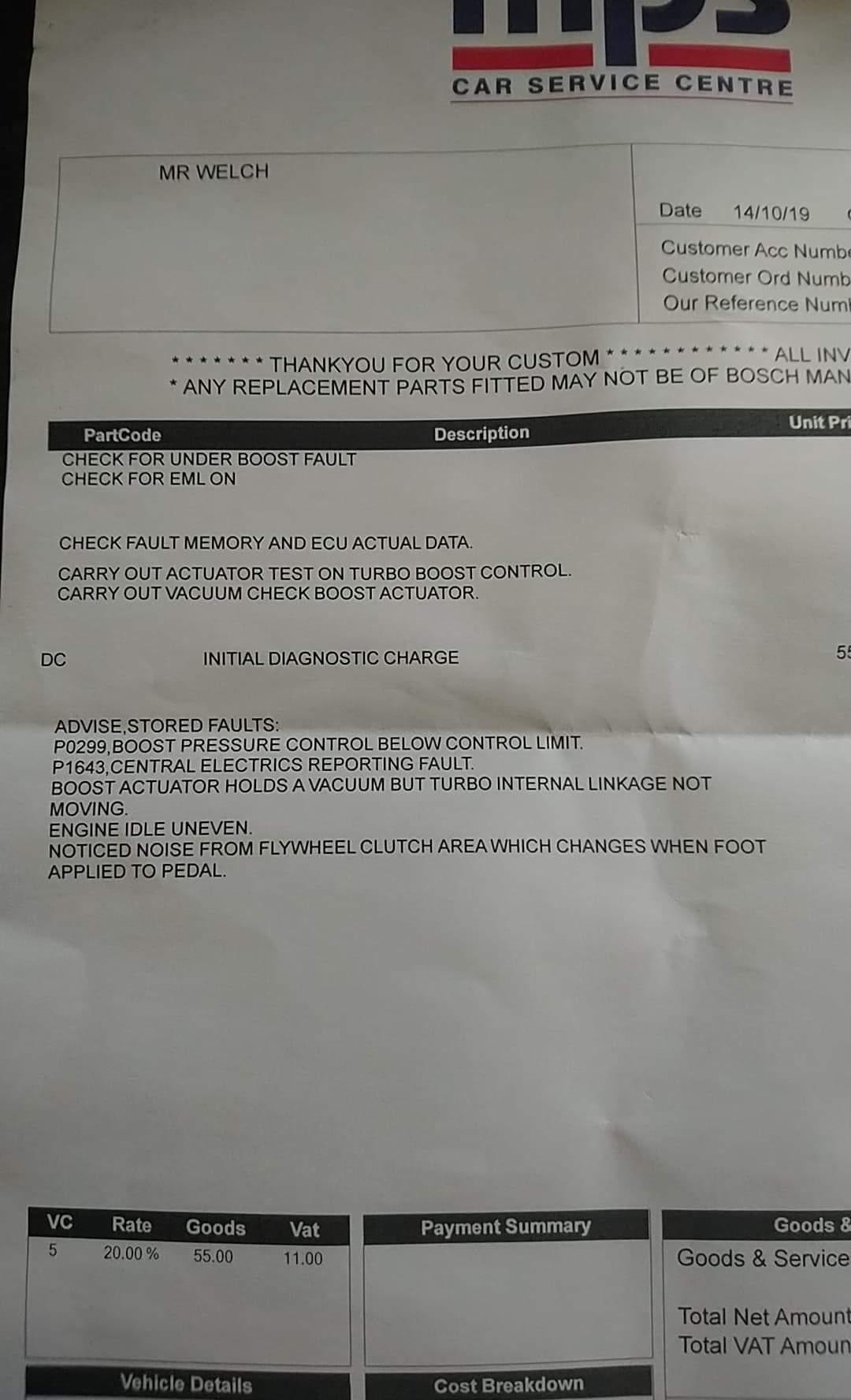

Davidwelch Posted October 16, 2019 Author Posted October 16, 2019 Thanks Trevor, the dealer told me the actuator was stickin and that they would replace it. I'm no mechanic, so I've posted the report which drew my attention to the faults. Sunny today yes 😂 The next A3 I buy I'll make sure to get a diagnostic done before I spend £120 on new discs and pads all round!

Audi Owners Club. Posted October 18, 2019 Posted October 18, 2019 The noise from the flywheel is the fault that would have worried me most.....Dual Mass Flywheel 😞
