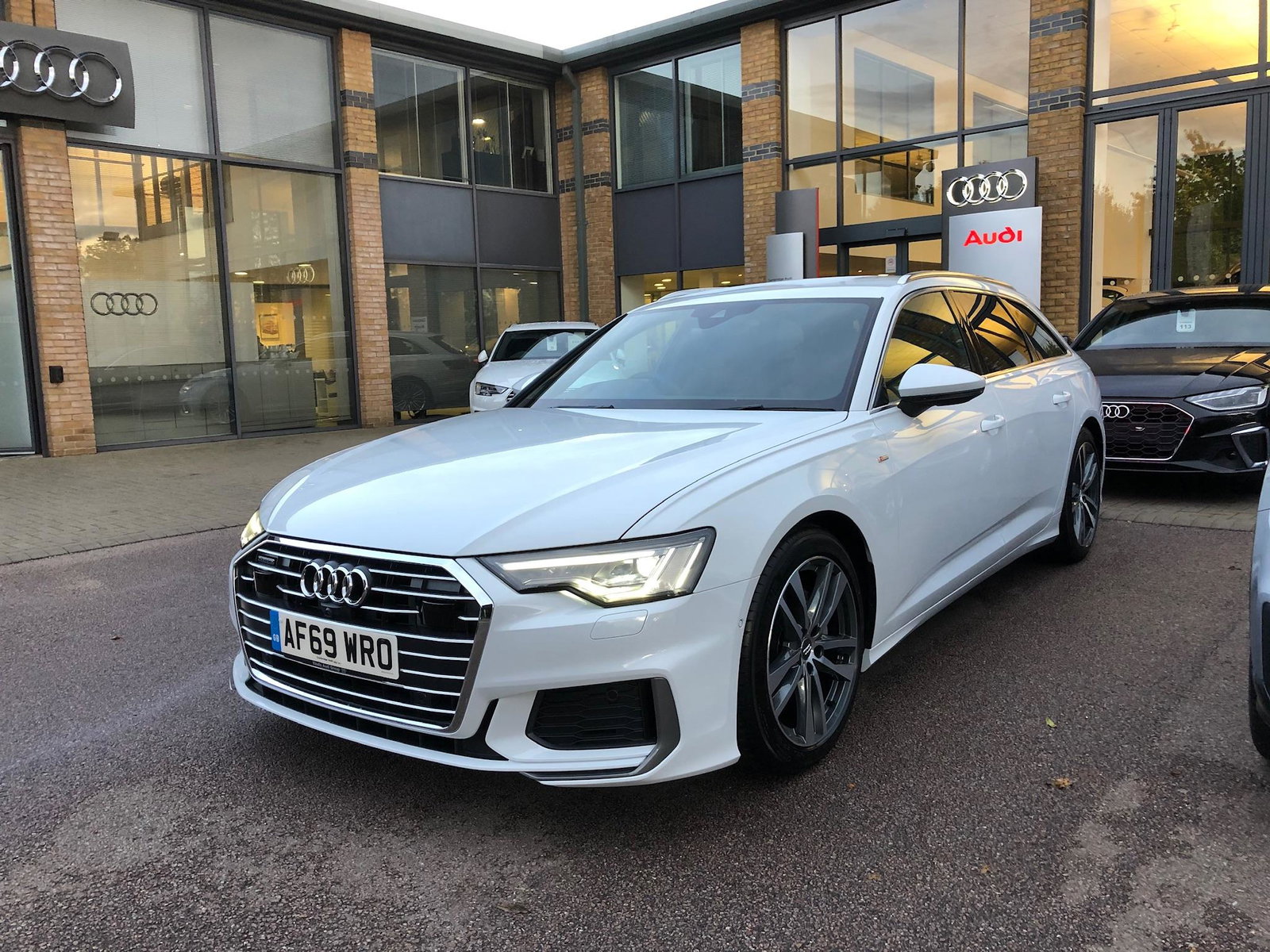

Dave1703 Posted October 21, 2019 Posted October 21, 2019 Hi, I have just collected my Audi A6 Avant 40Tdi quattro last week. Loving it so far and finding my way around the MMI gradually. I have tried to connect to my Amazon Alexa account but so far haven’t had any success...... anyone else having trouble with this? Any tips on getting it to work would be appreciated. 1
