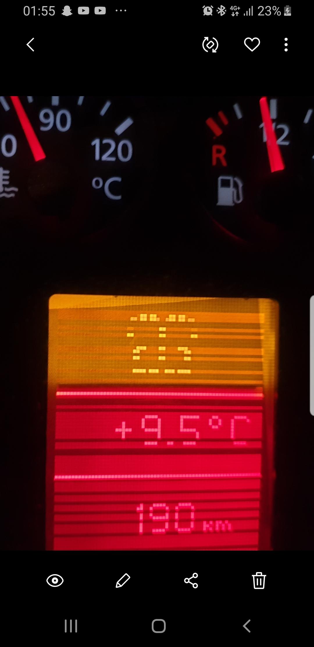

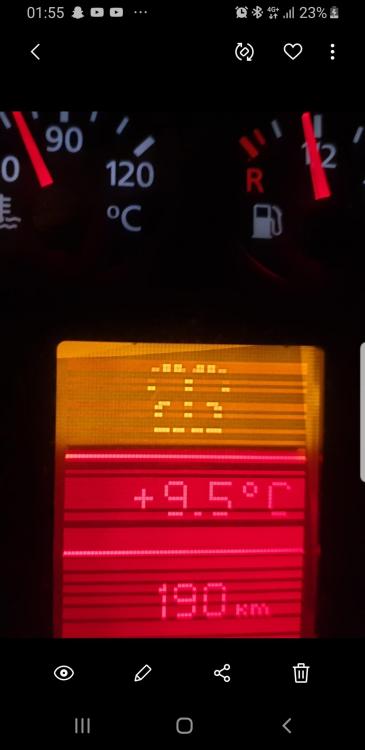

Janis998 Posted November 14, 2019 Posted November 14, 2019 Can someone tell me what does this warning light mean?
cliffcoggin Posted November 15, 2019 Posted November 15, 2019 https://www.prestigeimports.net/audi-dashboard-warning-lights/
Janis998 Posted November 16, 2019 Author Posted November 16, 2019 Well it seems that it is similar to Please add washer fluid but it beeps when when u start the engine and for now and then when u are driving. Even if the fluid is reffiled and thay tank is full. So i thought it might be something else
Magnet Posted November 16, 2019 Posted November 16, 2019 Looks like low washer fluid to me too Janis. Any VAG dealers near to you? If so, worth calling in for advice. If it is low washer fluid then it’s likely to be due to a faulty level switch or a bad contact onto it. Kind regards, Gareth.
