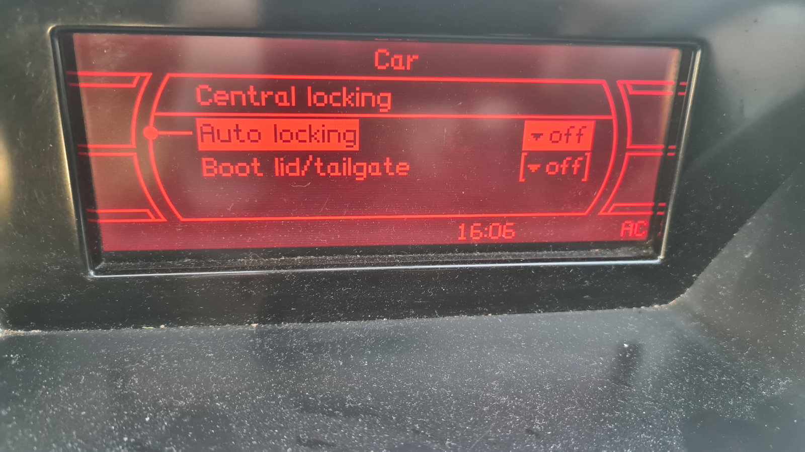

hi when i unlock the car only the drivers door unlocks. i have to press the key twice for the other 3 doors to unlock.as in my pic i have the auto locking off i did try auto locking on just in case.i tried the diagnostics and it locked and unlocked the doors.but no faults.so does it look like i will have to strip the 3 doors and give them a good clean as advised by Mwignall2 thanks
Auto locking is when the car locks the doors when you get to 10mph(ish) pressing the button twice to unlock all the other doors is part of the coding in VCDS and can be recoded. The door lock crud issue is when all or some of the other doors won’t unlock at all.
AAAHHH i see thank you for that explantion thats a relief cheers Mwignall2
