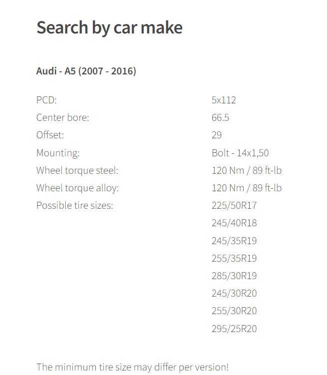

Hammie1982 Posted March 4, 2024 Posted March 4, 2024 A quick google search or Wheel Fitment search on the internet will give you alot of information. Most of it, isnt worth your time reading. But over my 42 years and 36 of them being around cars. I have found that there is plenty of information out there that will help. But you need to know where to look. As far as i am told by a tyre fitter here in town, "you can get 22" wheels on an A5, but it depends on the suspension setup and the width of the wheels". "Your very likely to get rubbing issues and overstress the wheel bearings and bushes on the car but it can be done" "It depends on the Engine, the model and the year" Ill refrain from asking the follow up questions that he put to me in regards to 22" wheels on a "Smaller car". Bare in mind, I drive an A8 and he nearly chewed my face off when i asked him for a price for tyres for 21" wheels...... He went on to say about pickups having wheels that size etc. (Hes a good bloke, ya just have to know how to handle the grumpy sod) Being honest and having had all different types of wheels on all different types of cars over the years, I wouldnt be advising going any bigger than 255/30R20 on the car if you want any kind of longevity out of the wheels or your spine. The roads are not freshly laid nor are the potholes forgiving to any wheel on less than a 25/30 profile tyre (Thats just my opinion) 1
