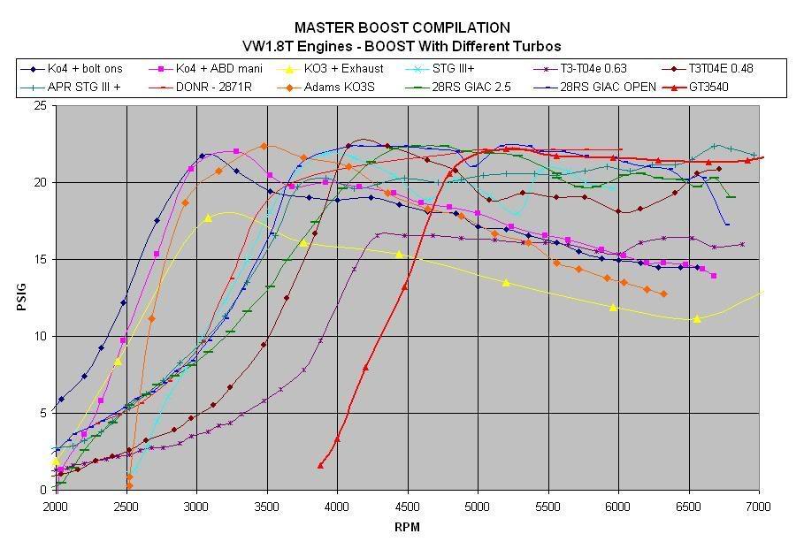

These are all estimations, the actual numbers will depend on where you live and what kind of supporting mods you have. Factor in ~10-15%. Anything past a gt2x is gona have some sort of lag. Here's a boost comparison of the turbo's
