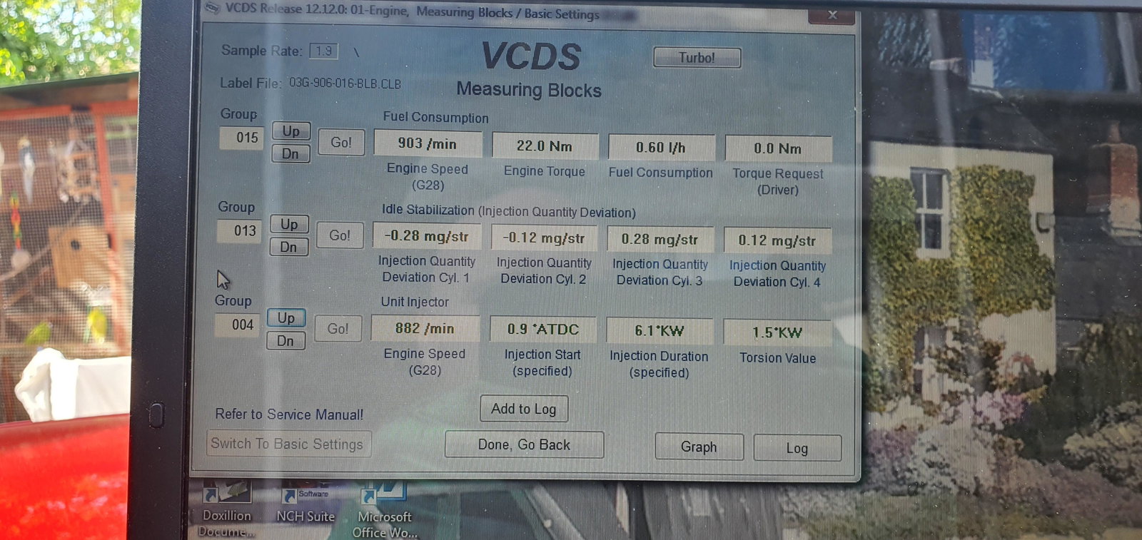

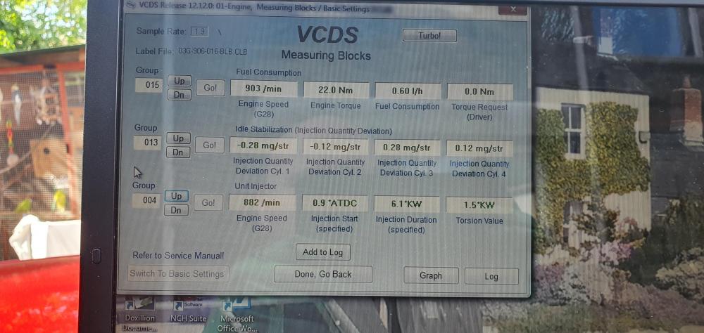

Thanks Gareth , I know with these PD engines the diesel is fed from the tandem pump on the cam straight through channels in the head to the injectors internally and therefore there is no run off pipes to check. I have got the timing smack on now so tomorrow fingers crossed might be a lot better. I have photographed data from VCDS from earlier and the injectors look spot on..
