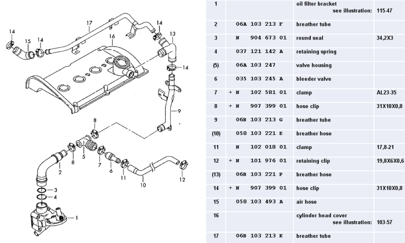

Alex smith Posted May 22, 2020 Posted May 22, 2020 Back again..... so I removed my wing the other week to do some work, long story short I removed the wing and found a tennis ball taped onto a breather and I’m pretty sure there should be something else on the end of that pipe. Anyone have any idea what’s meant to be there?
Steve Q Posted May 22, 2020 Posted May 22, 2020 That's not good! Please see the attached schematic which might help. Also I Know this is a popular upgrade: https://store.034motorsport.com/breather-hose-kit-aug-awm-amb-b5-b6-audi-a4-volkswagen-passat-1-8t-reinforced-silicone.html Cheers Steve
