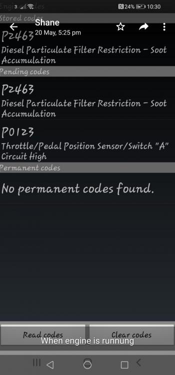

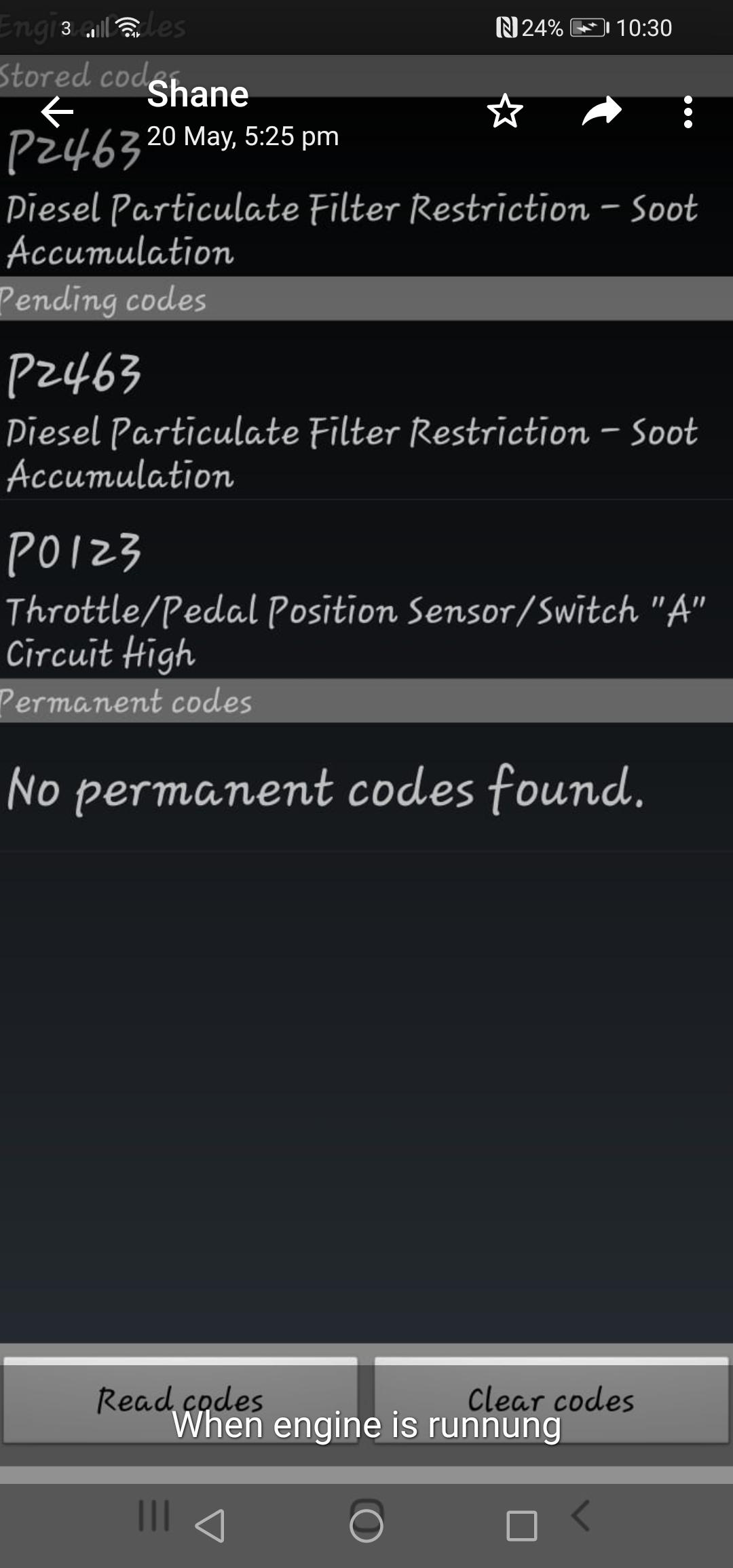

jacass84 Posted May 23, 2020 Author Posted May 23, 2020 I took it for a drive as advised hoping that it would clear itself but no such luck then this happened 馃檲馃檲 do you know what the cost would be getting it sorted by any chance 拢拢拢拢拢拢拢馃槶馃槶馃ぃ馃ぃ it's also been attached to a code reader and that's saying exceleration pedal ??
Steve Q Posted May 23, 2020 Posted May 23, 2020 On 5/23/2020 at 8:42 PM, jacass84 said: I took it for a drive as advised hoping that it would clear itself but no such luck then this happened 馃檲馃檲 do you know what the cost would be getting it sorted by any chance 拢拢拢拢拢拢拢馃槶馃槶馃ぃ馃ぃ it's also been attached to a code reader and that's saying exceleration pedal ?? Expand Having a dog replaced will cost around 拢1000. If it's been attached to a code reader, what did the mechanic say? Cheers Steve
jacass84 Posted May 23, 2020 Author Posted May 23, 2020 He's said to try new pedal first be alot cheaper than going ahead with new dpf I'm just panicking as I'm due back work Friday doubt I'll be able to sort the problem by then thanks so much for your help
