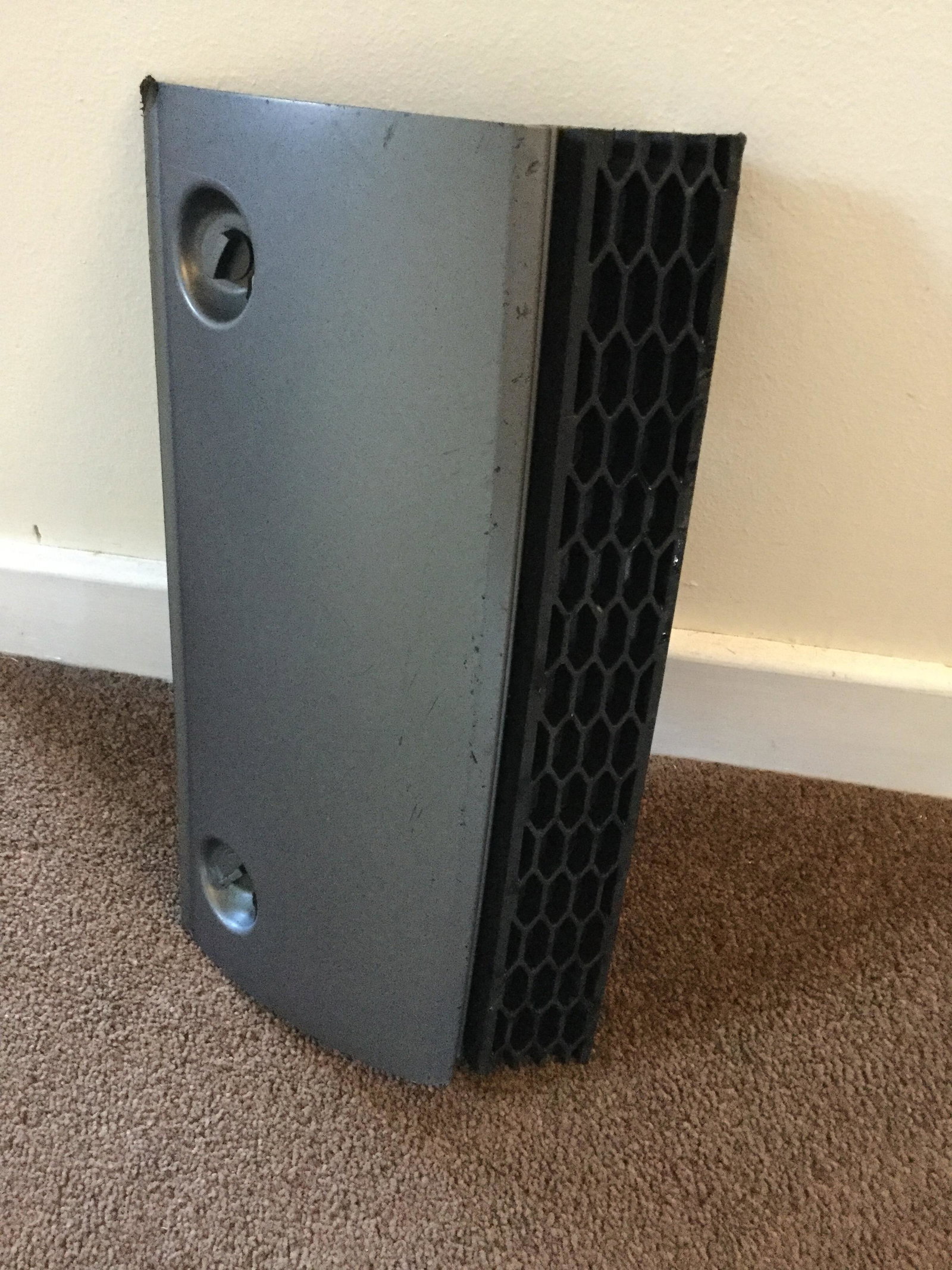

The removable tow bar cover on the rear of my a3 will not stay fixed on any more due to the worn lugs.
any idea how to fix?
i still remove it now and again to fit my removable tow bar ?
I think the lugs pop out don't they? They'll definitely need replacing.
Steve
I replaced the parts for the cover they are sold on eBay
6Q0807180 is the part number they are £3.12
