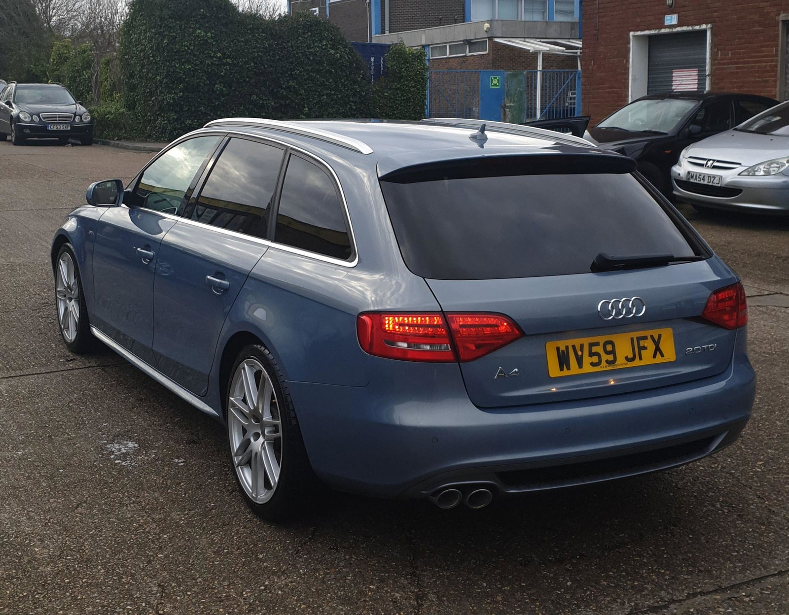

So, I have a 2010 A4 b8 Avant. With the bog standard and fairly pants MMI Symphony. No DAB. No Sat Nav. No Bluetooth. It may as well have an 8 trak it feels that outdated.
I want to upgrade it and have looked at a few options but want some advice for what / if others have done anything.
1st option is to buy a used MMI 3G from eBay. With the upgraded screen, lower control unit etc and install that. Keeps it looking stock but is still fairly dated.
2nd option is an aftermarket screen upgrade that has android play / apple play / whatever other phone mirroring play. But there seems to be a bit of a wide range of these. From the cheep Chinese stuff to higher end full alpine kits.
What have people got in their A4 b8 to make it feel less like it has the ICE from an 1982 Austin Metro?
