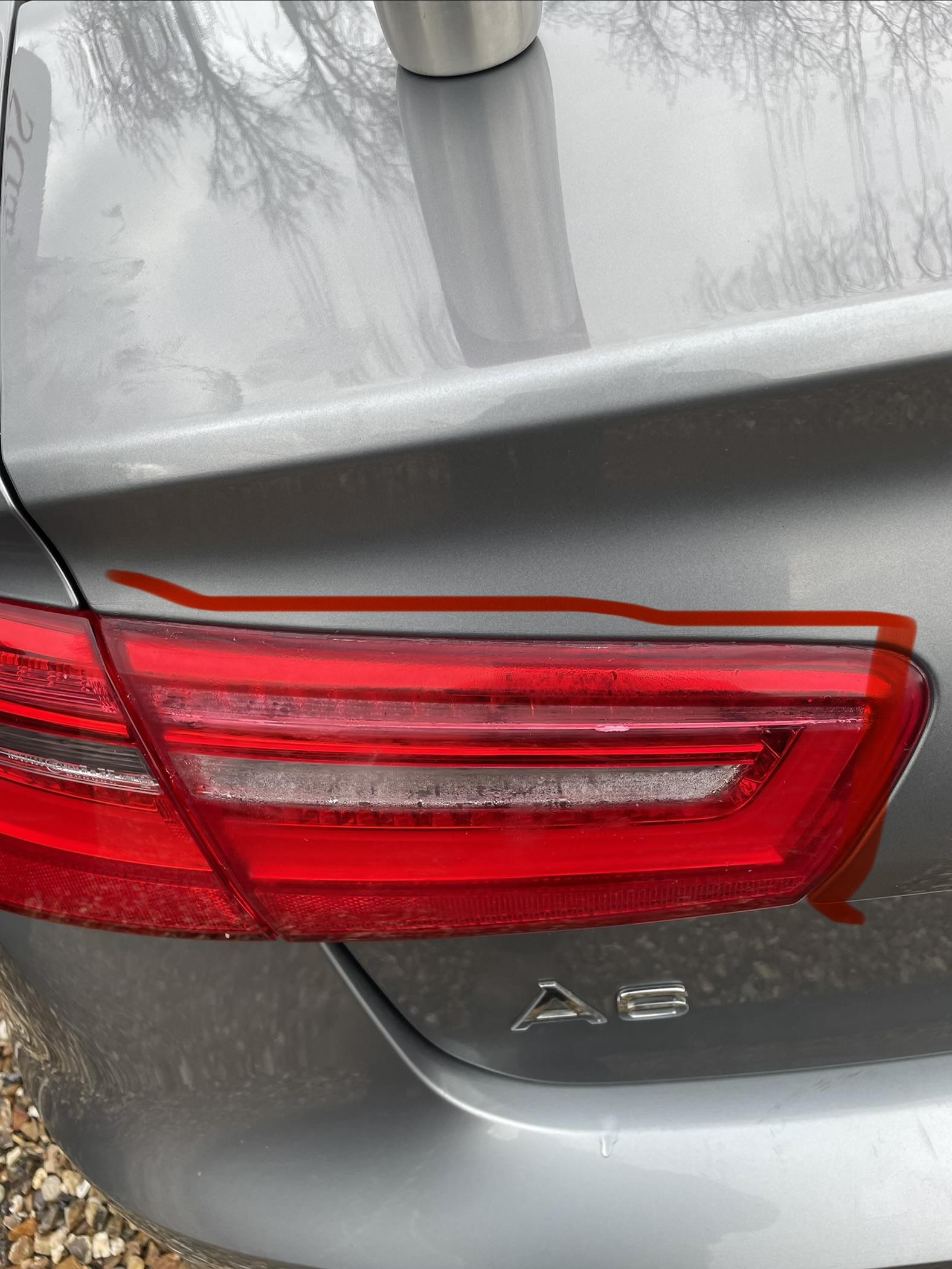

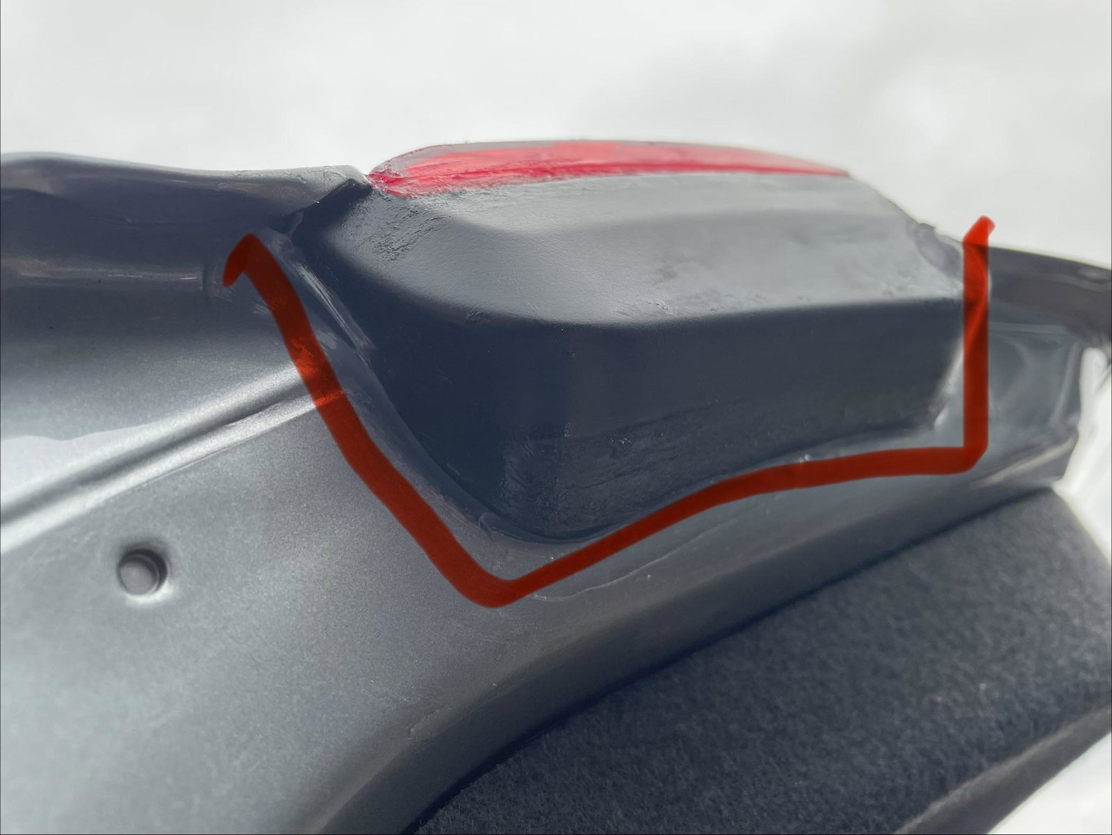

a6blacked007 Posted January 21, 2024 Posted January 21, 2024 Covered mine same location's with same tape no leaks .....
