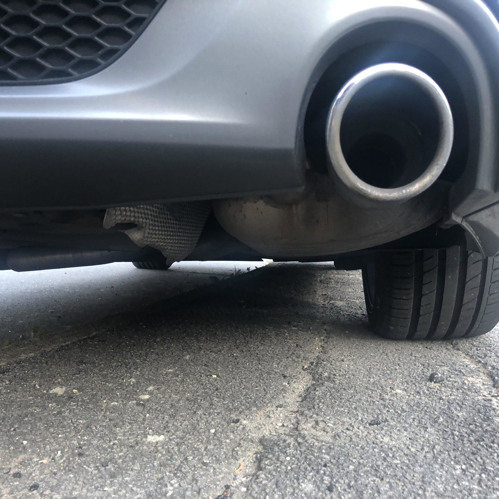

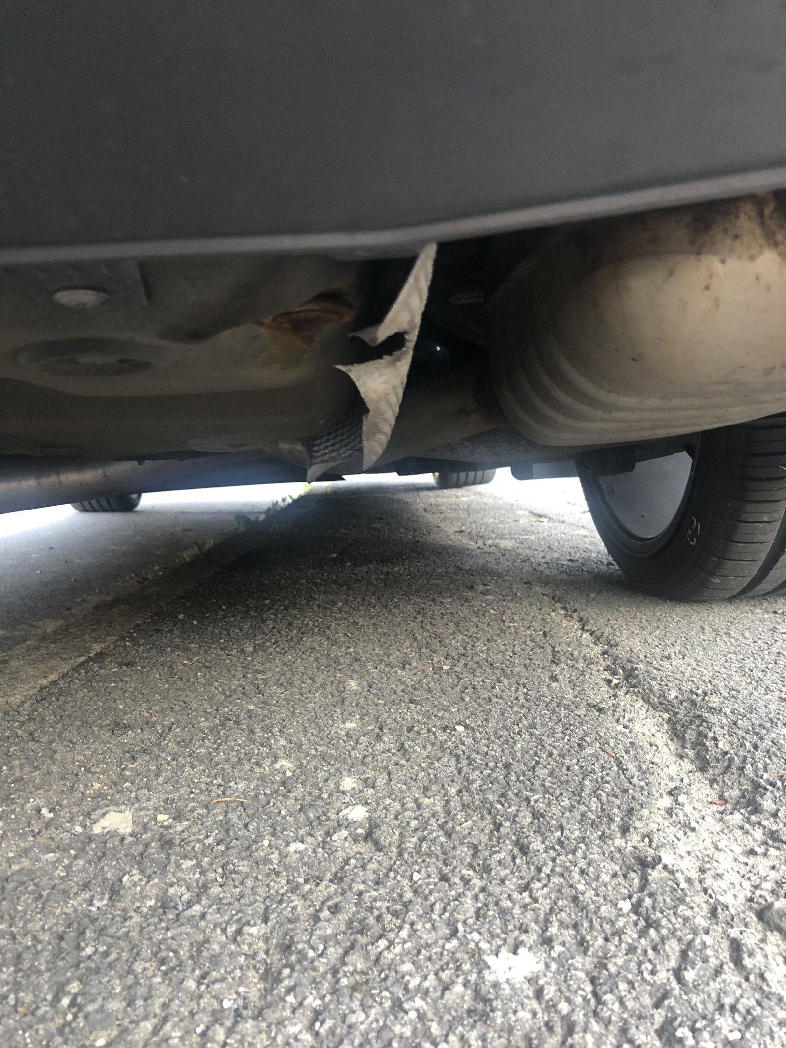

Audi A6 cover plate
Edd1988
That is just the heat shield for the exhaust, you might be able to re fix it with a new clip and a large washer (larger than the clip to go over the whole in the shield).
Otherwise you may need a new one if it is very loose, don't use cable ties as they may melt with the heat.
