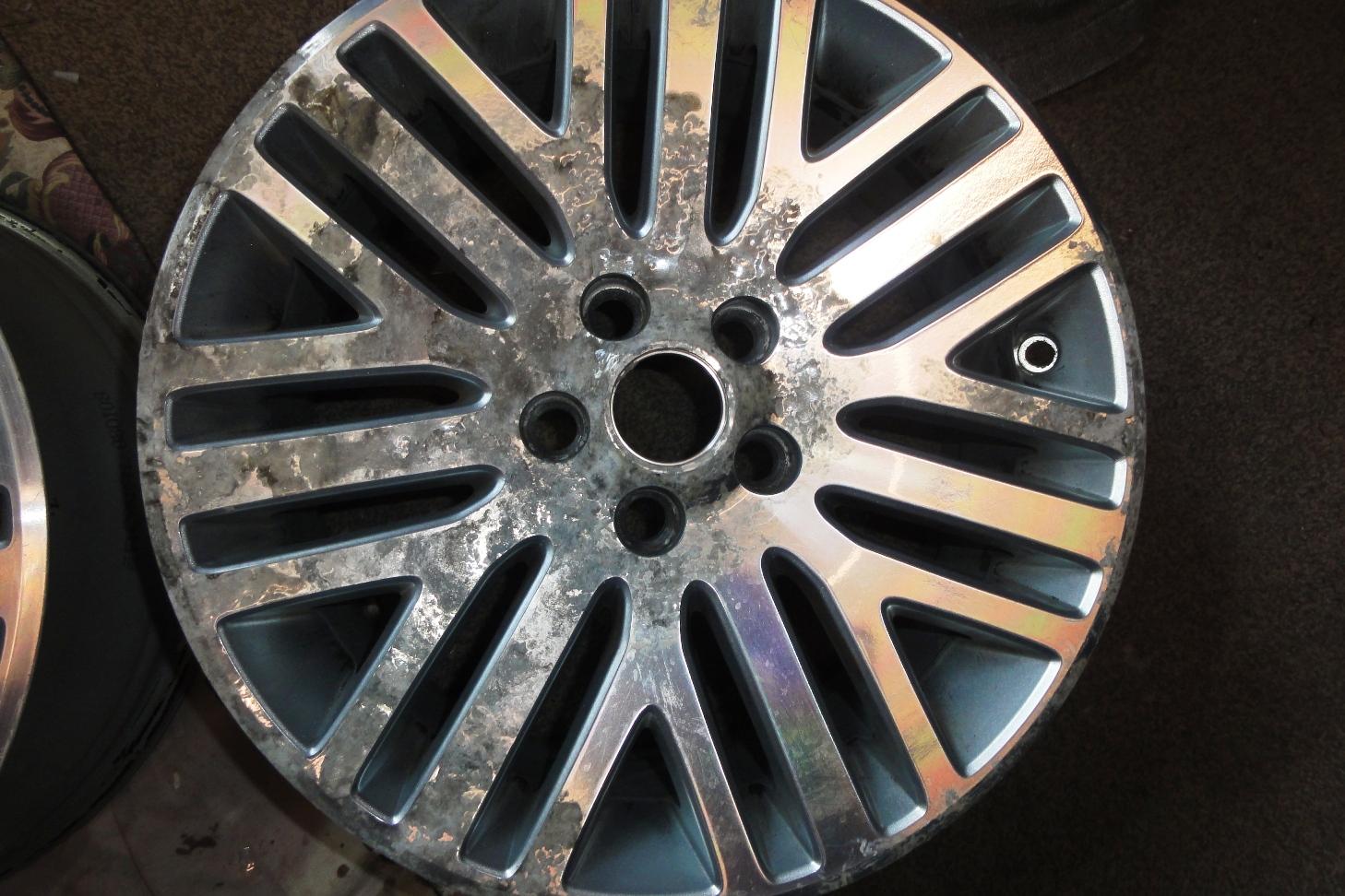

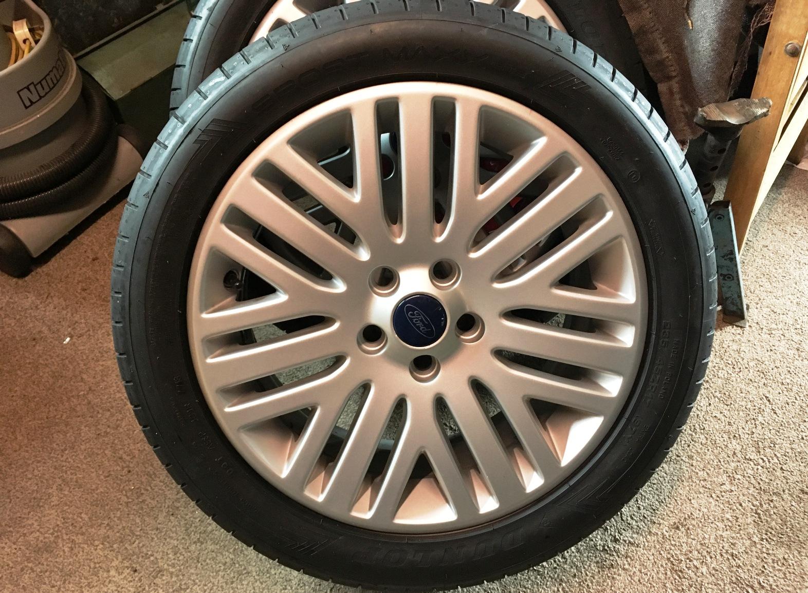

DavidTdi Posted September 3, 2020 Share Posted September 3, 2020 Perhaps it's not your thing to DIY but I've done a couple of sets and the results have been great. Need to get the tyres off... make good the scuffs with the least sanding possible... prep the paint... etch prime... grey undercoat... top coat... clearcoat. I heated up a small garden shed with a fan heater to aid paint drying between coats. Been a year since I did these on my Mondeo and despite giving them no extra care and occasional car wash use they still look perfect. 1 Quote Link to comment Share on other sites More sharing options...

DavidTdi Posted September 4, 2020 Share Posted September 4, 2020 Thanks for your comments. The spray was Halfords BMW Titan/Titanium Silver. Just happened I had tha colour BMW four years ago when I decided to refurb daughters Honda alloys and used that paint as a test on one wheel as I had a can to hand. Personally I like its slightly muted look compared with some of the bright alloy finishes in cans sold as Wheel Silver. 1 Quote Link to comment Share on other sites More sharing options...
