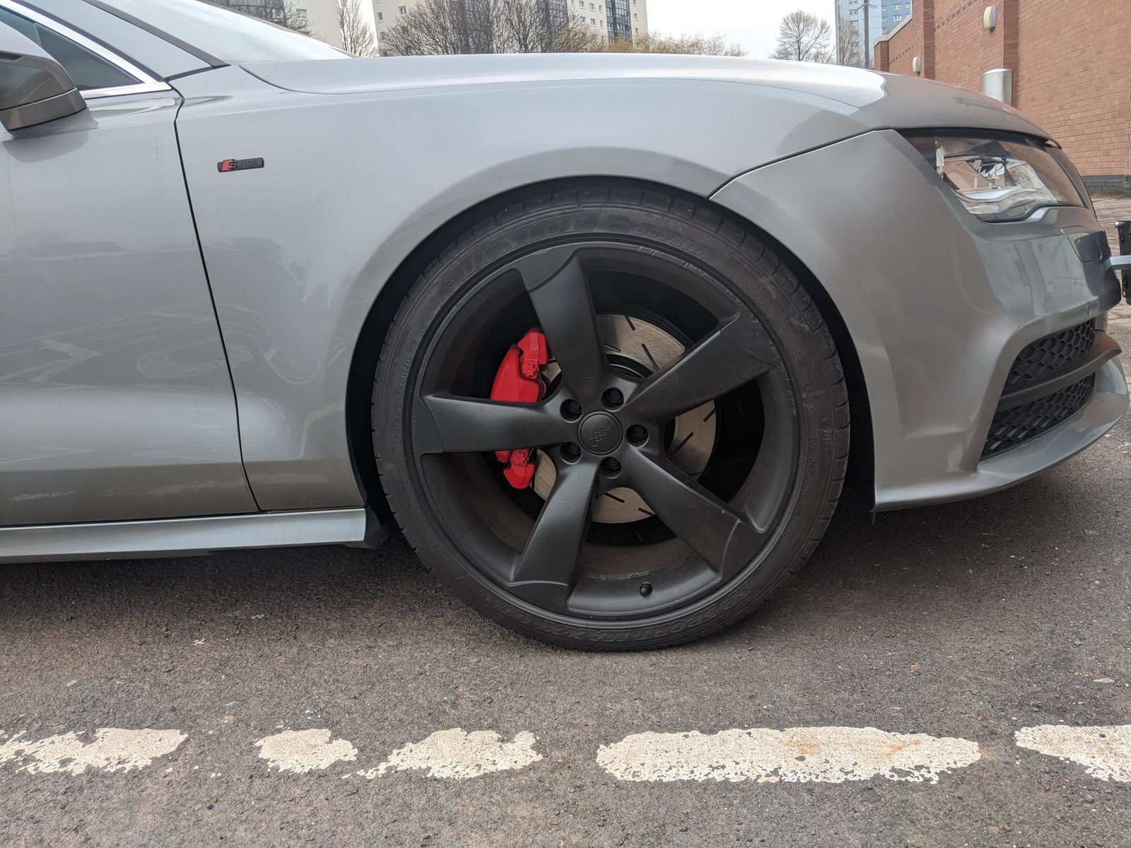

AdamA72020 Posted September 16, 2020 Posted September 16, 2020 Hey I have an A7 black edition 2013 and I need 4 new tyres, currently I'm on 275 30 21 can I change the profile and width on these without messing up the AWD system? It's a bit bumpy currently and would like to smooth that out as well as find cheaper tyres as currently the cheapest are Dunlop's at 250 a corner 😮😮😮 help!

JimmyC Posted October 13, 2020 Posted October 13, 2020 You need to stick to something with the same overall parameters. So to have a higher sidewall, you'll need to reduce the wheel size down from 21". This website shows the options: https://www.wheel-size.com/size/audi/a7/2013/ In summary, the options are: 255/45ZR18 99Y 8.5Jx18 ET32 5x112 2.4 / 2.1 235/55R17 99H 7Jx17 ET25 5x112 2.4 / 2.1 235/55ZR17 99Y 8Jx17 ET30 5x112 2.4 / 2.1 235/45R19 99V 8Jx19 ET26 5x112 2.4 / 2.2 255/40ZR19 100Y 8.5Jx19 ET32 5x112 2.4 / 2.2 255/40ZR19 100Y 9Jx19 ET32 5x112 2.4 / 2.2 265/35ZR20 99Y 9Jx20 ET37 5x112 2.4 / 2.2 275/30ZR21 98Y 9Jx21 ET35 5x112 2.6 / 2.3 My only query would be whether a smaller radius will fit over the brakes, but from your picture the brakes look normal sized so you should be able to drop all the way to the R17 1
