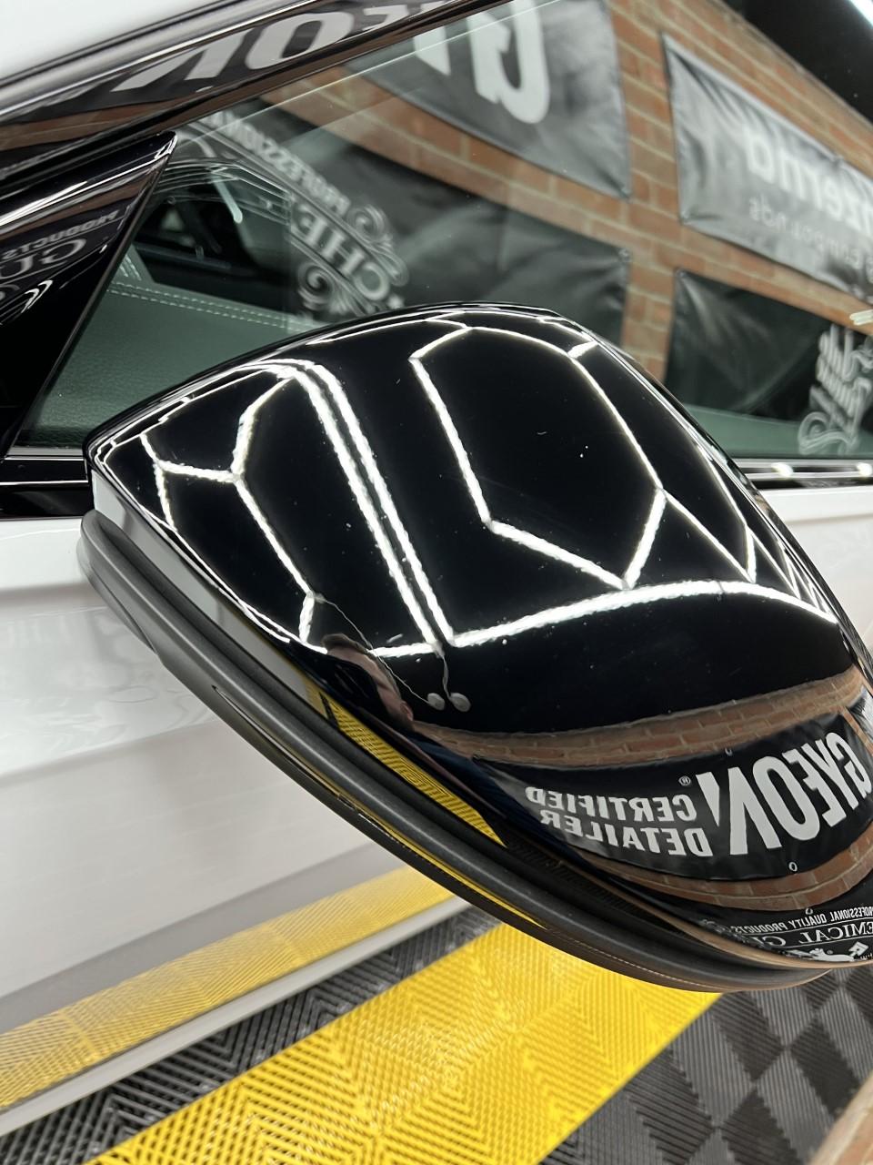

Optimus Posted October 3, 2022 Posted October 3, 2022 interesting i raised with my local dealer concerns about the low paint quality on these exact trims (my car is less than 6 months old) i had it taken to a detailer whom measured all the paint depths using two tools. the paint depth on the trims was shockingly low and the quality of paint was poor. it scratched just running a finger nail across it. Audi Warranty refused to accept any claim, I have had it logged for future complaint as i believe the same is likely to happen... image attached is my car's trims at 2 weeks old, 97 miles on the clock.
