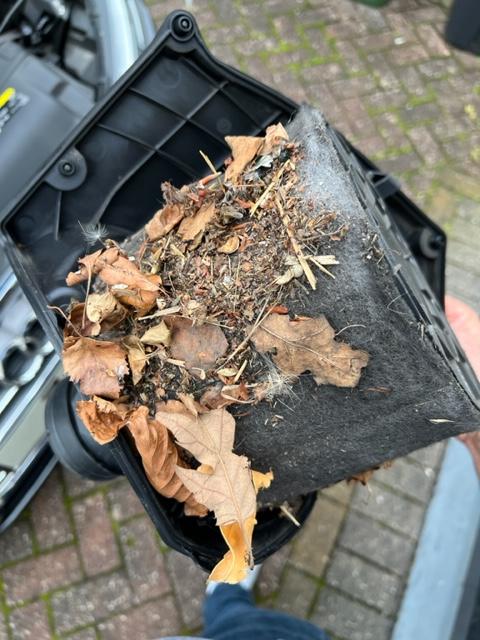

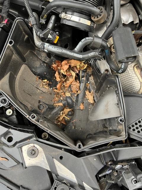

Pics of mine, not sure if ever replaced and the car was on 76k so well overdue by the look of it!
  • Like 2
  • Haha 1
I've pulled the filter from every car I've had to check, regardless of what the service history says. Finding a housing full of debris like that has not been unusual sadly.
I had an Oil Change and inspection service today and they wanted to add £89 for an air filter...errr... no thanks. A visit to GSF Car parts, £21 lighter and 20 minutes later job done.
Thanks for the info, my filter and housing was very much like yours, never been done by the looks of it.
