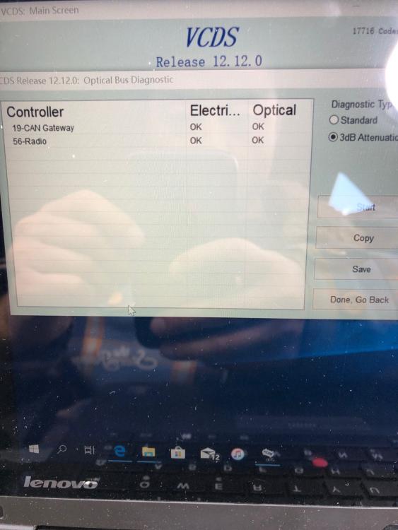

Scanned with 5053, showing
Address 56: Radio
Cannot be reached
Address 5F: Information Electr.
Cannot be reached
Nothing more helpful, optical can bus all showing okay.
