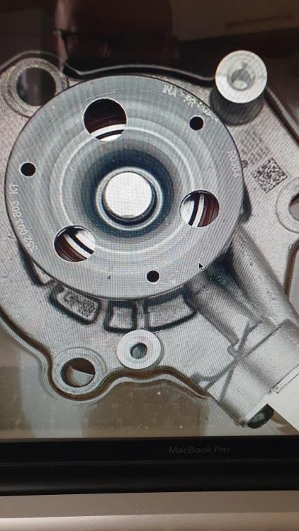

hi, the  genuine audi water pump is made and supplied by a few manufactures, INA is the main one,others are PIERBURG ,mayle,hepu, just go to (7 ZAP. com) put in all your details, you will find every genuine part number.
