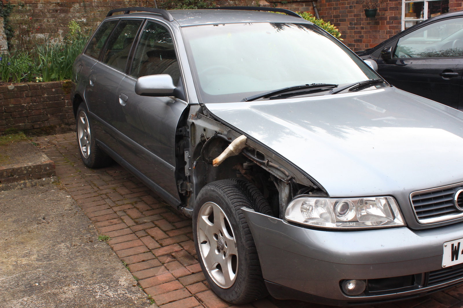

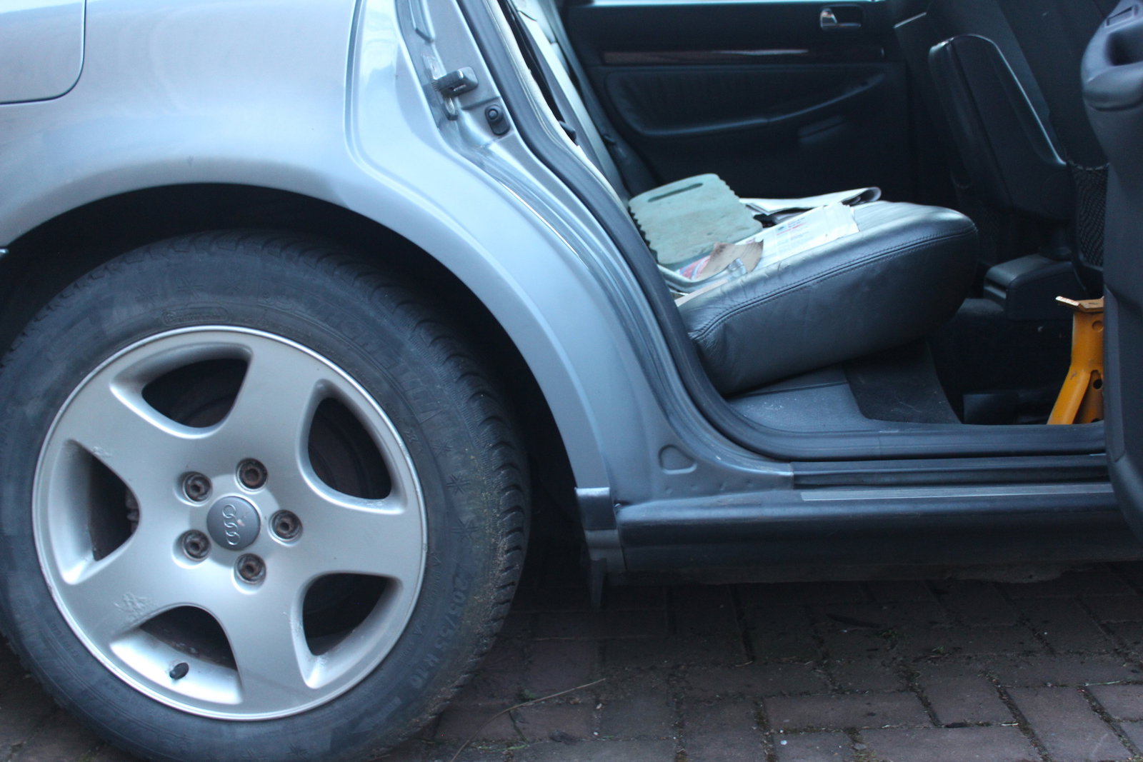

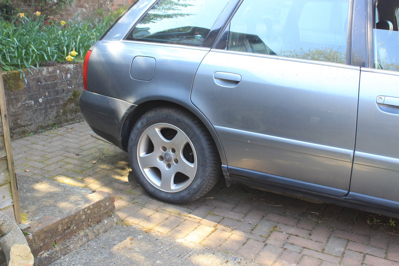

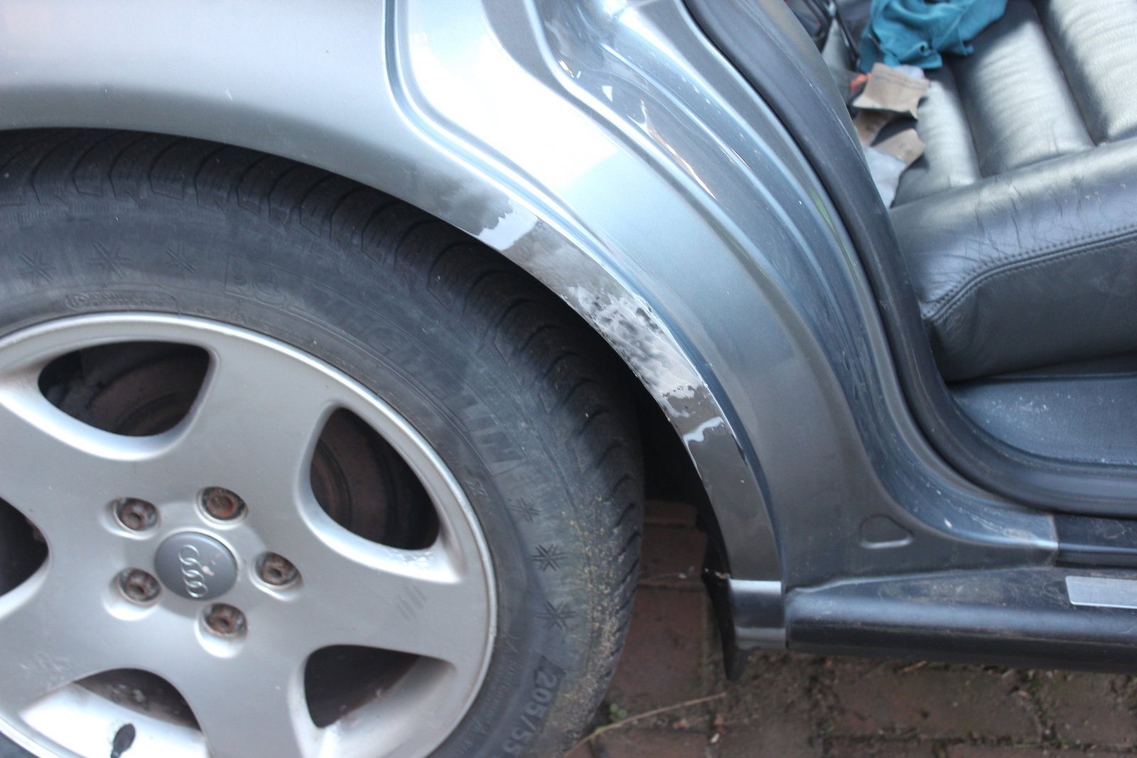

BirdmanMetalSculptor Posted March 27, 2021 Author Posted March 27, 2021 Ok, sorted the fuel leak, it's actually running really well though still hard to start. Took a closer look at the front wing though and it's not pretty ... I just put my finger straight through it! Its at the rear bottom of the wing just in front of the drivers door where it starts to wrap under and form the sill. The main sill behind it under the door seems very solid but I now need to take the front wing off to see how bad it is behind that where it starts to curve under and form the front end of the sill. Although I can weld, if the monocoque is rotting there I'll probably just bin the car before I spend any real money on it. Hope not though, it does drive so well. Worst case maybe I can make a lounge set or some gaming chairs out of the seats ! Anyway, I'll post a pic or two tomorrow. Cheers

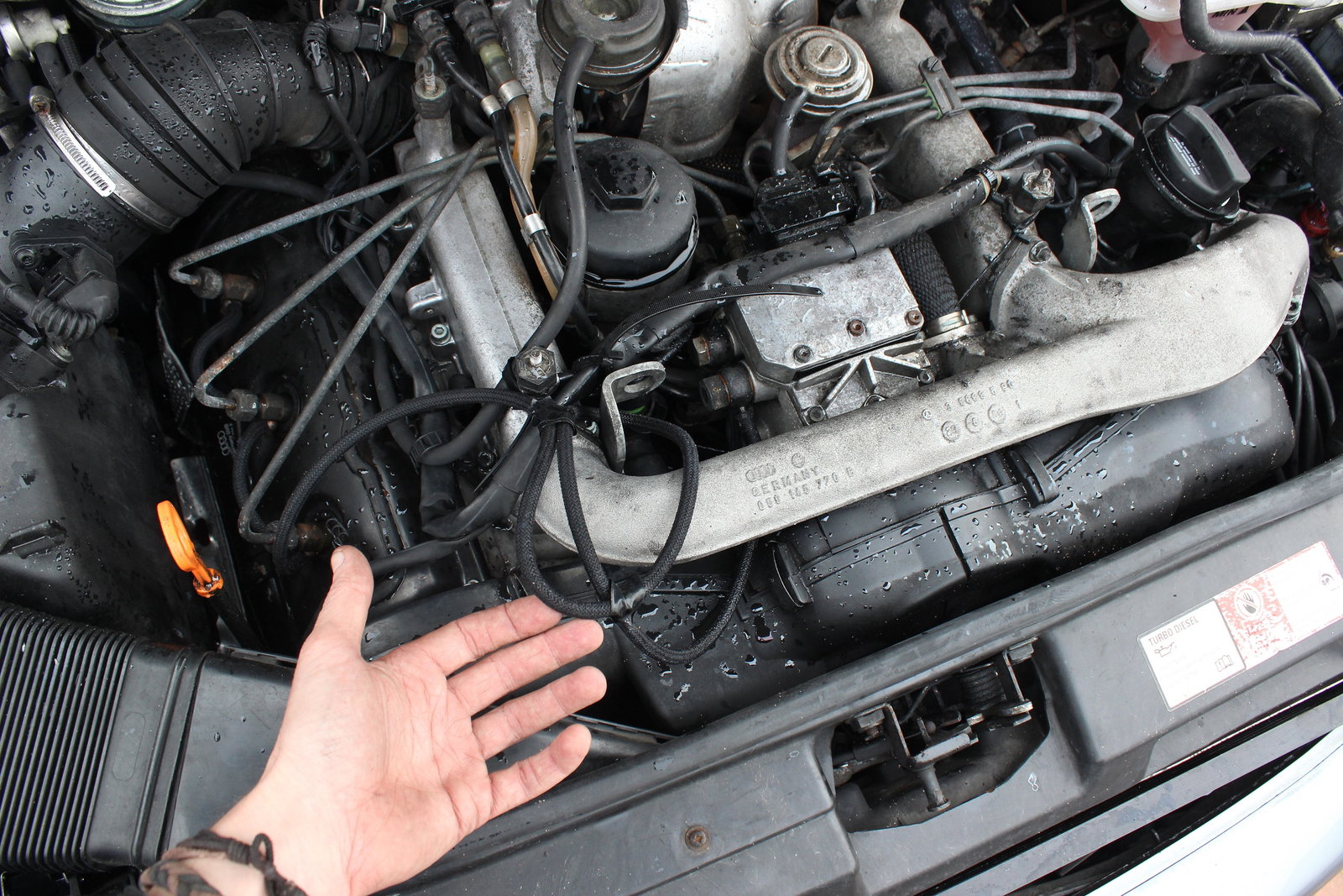

BirdmanMetalSculptor Posted March 28, 2021 Author Posted March 28, 2021 Here's some more on it and some pictures. So the fuel line that burst I'm pretty sure is not Audi ... whoever fitted them left a spare 2 feet of hose coiled up on one of them rather than cut it to length! (Maybe he knew he'd need some spare! - it is janky hose!) So far i've just fixed the leak and done one other frayed pipe but I will redo them all. The engine was absolutely covered in diesel and grime and clearly it had been leaking for a while. That might even explain the trouble it had starting because today it fired right up two out of two better than it ever has in my ownership. Anyway, a can of brake part cleaner and a power wash and it came up not too bad. Can't really drive it yet of course but I'll let it run a while and see if it drops anything, fingers crossed. I checked the wing out properly today and good news on that too! ... the monocoque behind it is totally sound. A tiny bit of surface pitting but structurally perfect. Real relief, I felt like that was going to be the deciding factor on the car but it just needs a wire brush / sand and some primer. There's a couple of surface spots of rust on two other wheel arches but basically no rot anywhere else. I got some colour matched paint turning up in a couple of days so hopefully I can get all the bodywork sorted quickly. I got a primed pattern part wing turning up in a couple of days as well (not bad at £50 delivered) ... just hoping the non original part won't make it an arsehole to fit. The lower part of the old wing, it turned out, had been cunningly fashioned out of expanding foam which had then been sanded and had a vinyl sticker applied over the top! I'd never even noticed! Apart from that the front brakes look good, pretty much new pads in there and the discs have no lips. Haven't checked the rears yet, they haven't seized after standing a year (moved it twice) but they look pretty crappy and the hand brake is high. Maybe it'll need new rear discs, I'll check that out tomorrow. Hopefully I can get this back on the road without spending too much. I do really like it, its a great place to sit and such an easy capable drive. I genuinely think it looks better than the newer ones too, especially with these wheels. https://www.dropbox.com/s/k3uj7x0pbxoksu3/IMG_0490.JPG?dl=0 https://www.dropbox.com/s/eicdo73778on4cn/IMG_0491.JPG?dl=0 https://www.dropbox.com/s/q0avqnd6x8qlf8f/IMG_0493.JPG?dl=0 https://www.dropbox.com/s/0vzqz2pol09b0wg/IMG_0494.JPG?dl=0 Hope the links worked, I tried uploading them here but it kept coming up with 'error 200' J

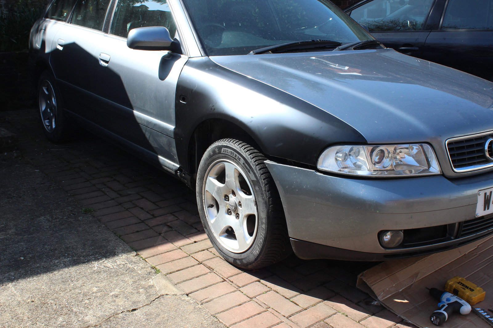

BirdmanMetalSculptor Posted May 4, 2021 Author Posted May 4, 2021 Hey Steve, Thanks man. I'm afraid the video and the shout out isn't public, I just shared the link here for forum members, my channel is about something very different and I don't really want car videos on it publicly. As for the seats, yeah they are nice but judging by the 'Quattro' on the (horrible) fake wood trim I'm guessing the entire interior is a retrofit ... which is fine with me 🙂 ... although ... if anyone has a set of standard matt black trim panels for a 2001 A4 B5 I would gladly take them off their hands! I never liked that fake wood look. The new wing worked out real nice. Genuinely never painted anything before, though I have a spray gun / compressor for lacquering metal sculptures so I thought i'd give it a go. The finish wasn't bad but had imperfections (no spray booth). I went over it with 1500, 2000 and 2500 wet and dry and then mopped it and it turned out really good. In fact if I'd paid for someone to do it I would have been happy if it came out that well so well worth watching the youtube tutorials that I did. The other wing ... pfff ... yep ... errm ... not great! I went down to bare metal around the wheel arch, used a very fine skim of filler on some surface pitting then etch primed it. At that point it looked great, then I tried to blend it in to the existing paint and ... well ... kinda caked it up a bit! lol. It wasn't too bad until I lacquered it but I used spray can PU lacquer on that one instead of quality clear cote and its so fluid it just ran everywhere. In removing the drips I went through the paint I'd put on and that is what is causing that horrific effect. Probably I could sand through it back down to the original lacquer and remove the new paint, re etch it if necessary and then try again but ... well ... priority one is the MOT. Still got enough paint to do a whole wing though so at some stage I will probably take the wing off and do it all as one panel. The slight colour mismatch doesn't offend me nearly as much as how it looks right now and taking the wing off was really very easy. Got some bolts to drill out first though!! 🙄 Thanks again for the feedback, namaste.

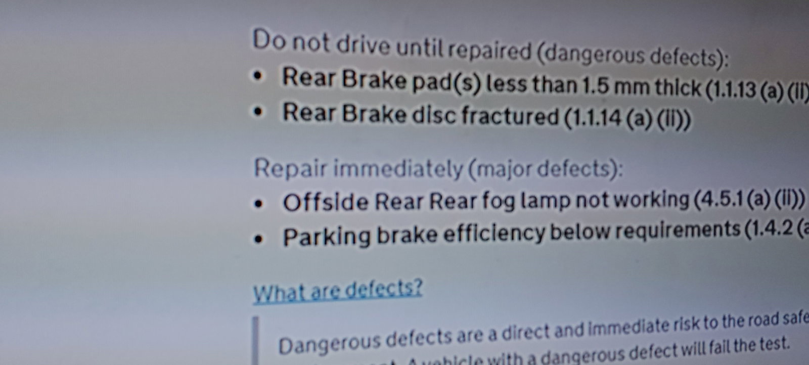

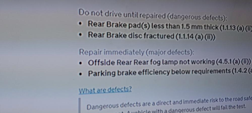

BirdmanMetalSculptor Posted May 18, 2021 Author Posted May 18, 2021 Quick Update ... Last job to do was the rear discs and pads / replace one seized slider bolt. Turned in to a nightmare! ... you can't get the discs off without removing the calliper carrier. Ordinarily not a problem, 2 x 8mm hex bolts that go direct in to the subframe. Sadly 21 years of rust and heat cycling and I couldn't get them off. Soaked them in penetrating fluid for 5 days, blow torched them, used a 3 foot breaker bar, couldn't shift them. Ultimately put so much torque through them I mangled the hex. Anyway ... took it in for MOT today and pre booked an Audi specialist to sort out the bolts. Basically it was a right result! It failed on rear brakes of course but I knew it would, and on handbrake adjustment (which I couldn't do because of the above issue). Apart from that it flew through emissions (thanks to Wynns Gold Diesel treatment !) and it needed a rear fog light bulb (should have clocked that but didn't!) End result, should have it back in a couple of days with a new ticket and without breaking the bank. Chuffed ... I really do love these cars, great to be able to save it and keep enjoying it. Cheers for the comments / feedback Namaste

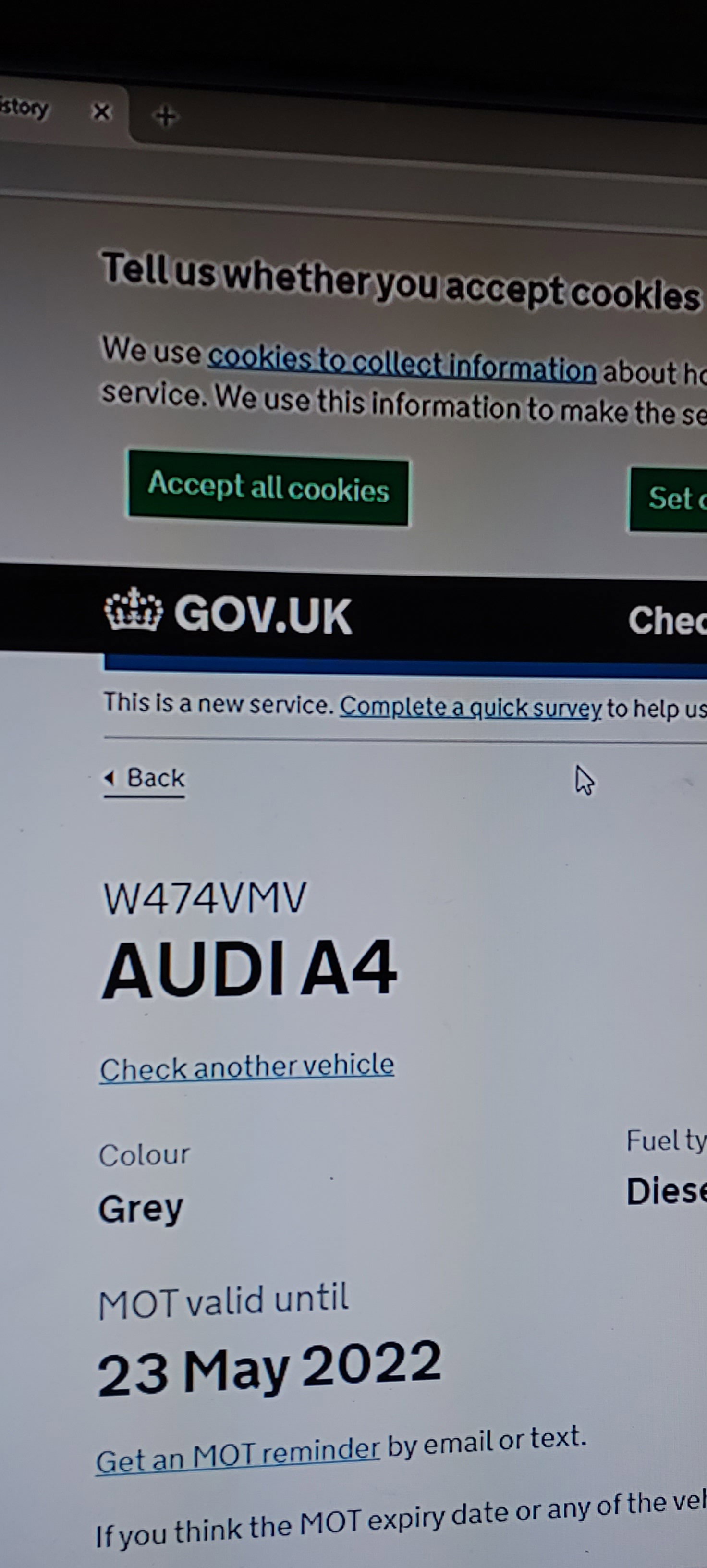

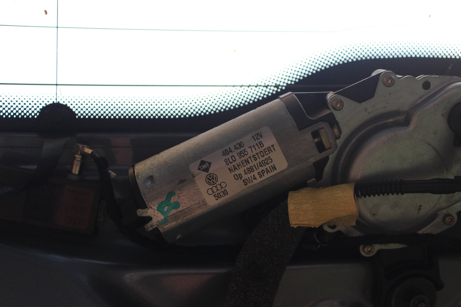

BirdmanMetalSculptor Posted May 24, 2021 Author Posted May 24, 2021 Final (happy) post on this thread (For Now!) Summary: - New rear discs / pads / slider pins - New Front O/S wing + paint / clearcoat - Rub down / fill / etch / paint & lacquer rear o/s wheel arch and front n/s wheel arch - New rear wiper motor & diagnose / reconnect front foot well washer hose (remove 3 pints of pissy water from foot well and carpets!) - Replace crappy / split bodged aftermarket fuel lines (see pic) with new lines to each cylinder - Wynns Formula Gold diesel treatment Result: 12 months MOT ... no advisories! Long time since I've enjoyed a drive as much as I just did! ... life in the old girl yet 🙂 A few random pics of some of the work I did on it. Cheers again for any / all comments / feedback. Have a great day! John
