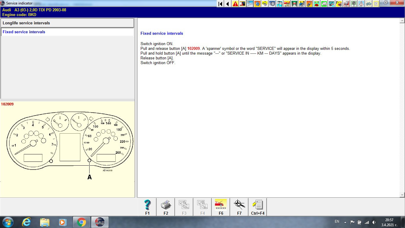

paxterg Posted April 3, 2021 Posted April 3, 2021 I have tried turning the ignition on and then pulling the stalk out, and then again for 5 -10 seconds, it goes through the motions as it should do but the wee spanner and warning light stay on. Has anyone any suggestions?
paxterg Posted April 3, 2021 Author Posted April 3, 2021 Thats what I've tried, goes through the process but the service warning remains
gently Posted April 3, 2021 Posted April 3, 2021 https://erwinsalarda.com/tutorial-on-how-to-reset-the-audi-a3-service-due-reminder/
Stevey Y Posted April 3, 2021 Posted April 3, 2021 Hi get a good quality scanner or VCDS then you can put the light out as well as read your own codes when required. Regards Steve.
TEC_DESIGNS_8PA Posted May 1, 2021 Posted May 1, 2021 On 4/3/2021 at 6:59 PM, gently said: Cheers for that was going to ask this, but you've answered my question. Worked fine on mine
