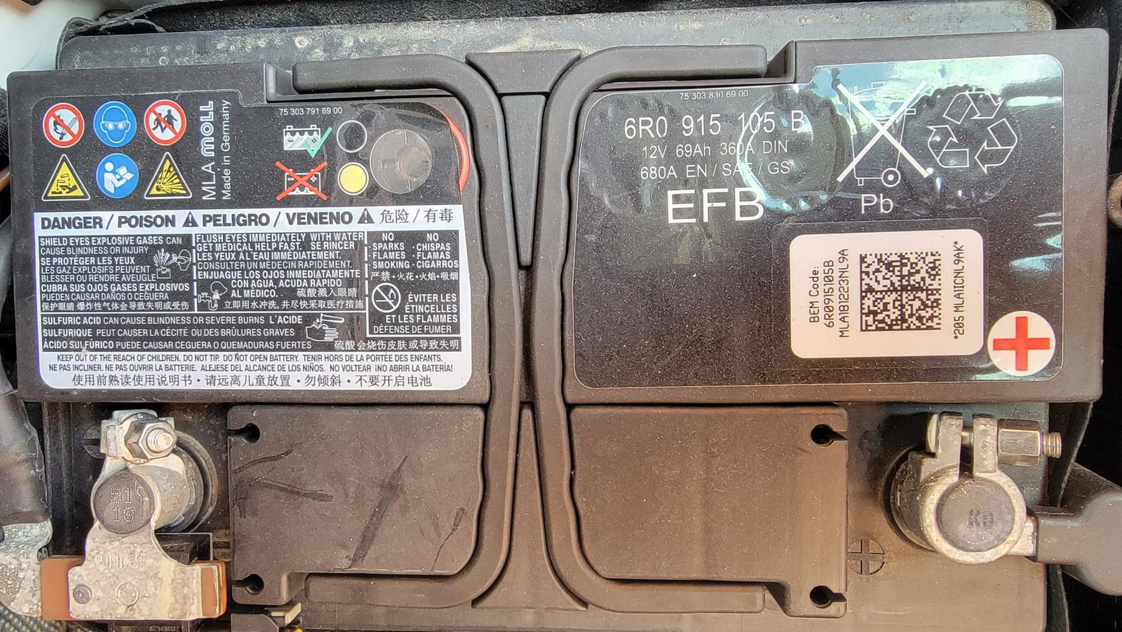

Posted (edited)
Hi Gareth,
The battery is from Moll, not Bosch. I could not find a date on it. I have attached the pic. Let me know what you think. Thanks.
Edited by adithyajb

Hello Adithya,
Your Moll battery is likely to have been an original fitment. I believe they ceased trading about 3 years ago, and there were warranty issues with some of them, so I would be restating that if it were mine, I would want to get it on a sophisticated tester, that will measure all parameters monitored by the Battery Condition Monitor.
I might not be able to convince you of the worth of getting that done, and I sense you feel there is something else wrong with another ( more expensive?) component, so there is little more I can add, except if you do find you need a replacement battery, then I would be going for a Varta/Bosch or possibly Exide - their minimum of 4 year warranty grade.
Incase it helps, I buy mine at competitive prices from on-line specialists such as Tayna, Battery Megastore ( there are more).
The new battery will need to be coded to the car.
