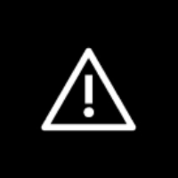

Chad_DC Posted May 6, 2021 Share Posted May 6, 2021 Hi all, Just been looking for information on Audi A4's and stumbled across this site. Thought I may as well joint up and have a nose. So...hello. I'm going to look at a 2017 A4 Sport tomorrow. And if someone could just answer a quick question I'd really appreciate it. There is a symbol on the dash that I'm not familiar with and can't find an answer searching google or indeed on this site. The symbol is an exclamation mark inside a triangle. But it's not red or amber - it's white...? Any ideas? Potentially being new to Audi, I'm stumped on this. If it's something potentially serious I won't bother going to look at the car. Thanks in advance, Chad. Quote Link to comment Share on other sites More sharing options...

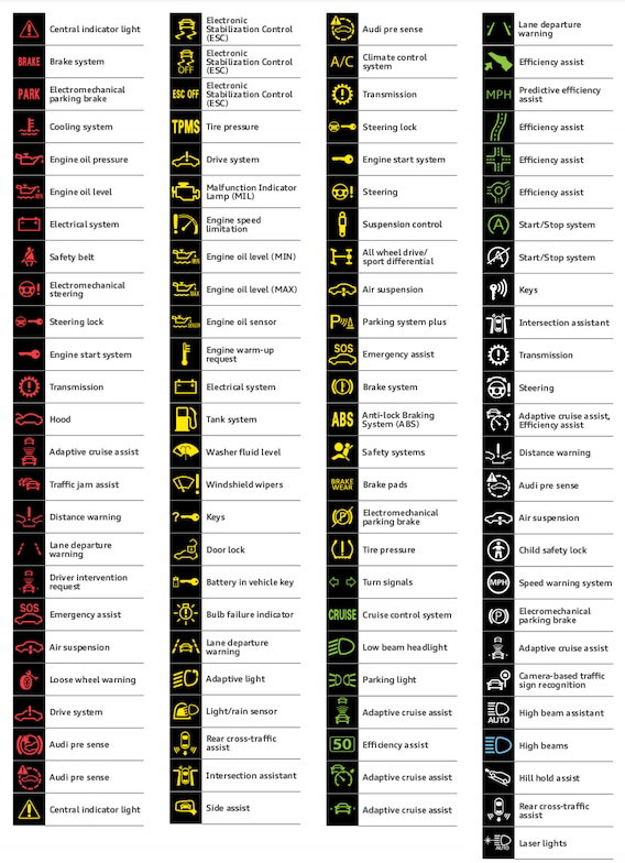

Steve Q Posted May 6, 2021 Share Posted May 6, 2021 Welcome to the forum, you'll find the members on here are a friendly and helpful bunch ☺️ Here's a picture of Audi warning lights. Also the link shows the light I think you're referring too which states: least one check control message is displayed or stored. The symbol is shown on the display of the instrument cluster. you should be able to scroll through the computer and the message will appear. Being white it shouldn't be anything serious. https://www.jardinemotors.co.uk/audi/servicing-and-parts/warning-lights/ cheers Steve Quote Link to comment Share on other sites More sharing options...
Chad_DC Posted May 6, 2021 Author Share Posted May 6, 2021 Hi, Yeah that's the one! With it being white, it confused me. I've seen two cars that I might be looking at tomorrow and they both show this same symbol. Different cars from different places. I just don't want to be buying a car that already has an issue. Not sure how to scroll through menus on one, but I'm sure I'll figure it out while I'm there. Thank you for the reply. Fingers crossed it's nothing. Just a bit concerning that anything at all is showing a warning. Chad. Quote Link to comment Share on other sites More sharing options...
Steve Q Posted May 6, 2021 Share Posted May 6, 2021 No probs Chad, glad I could help. To scroll through the messages you need to use the steering wheel buttons. Once you've found the messages tab you'll need to press ok (or similar) on the steering wheel to open the messages. If it's white it's nothing too serious, maybe tyre pressure monitoring system needs resetting or pressures checking for example. Quote Link to comment Share on other sites More sharing options...
