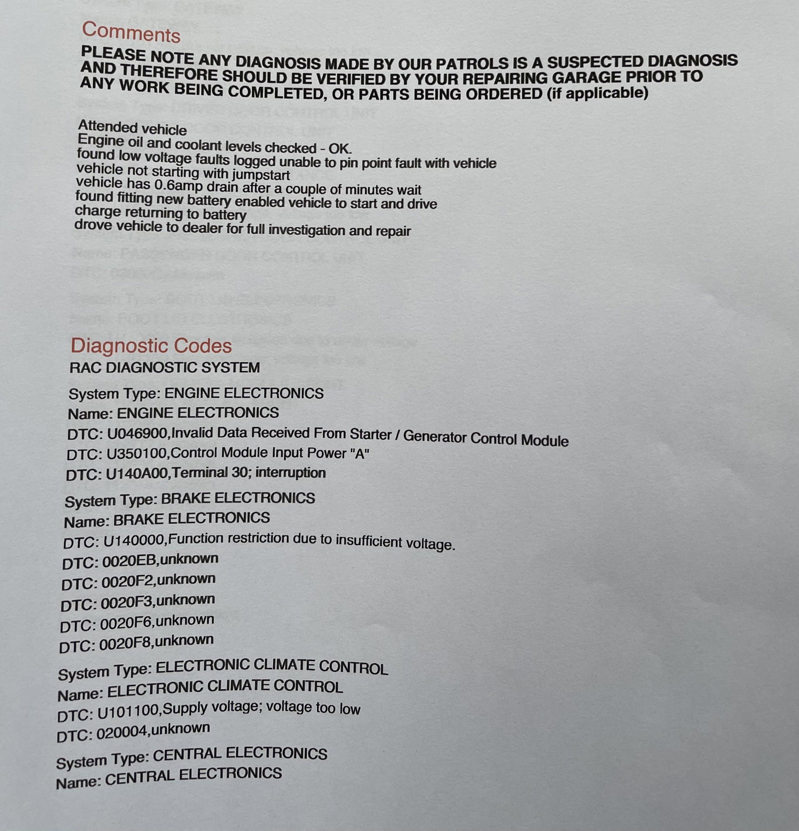

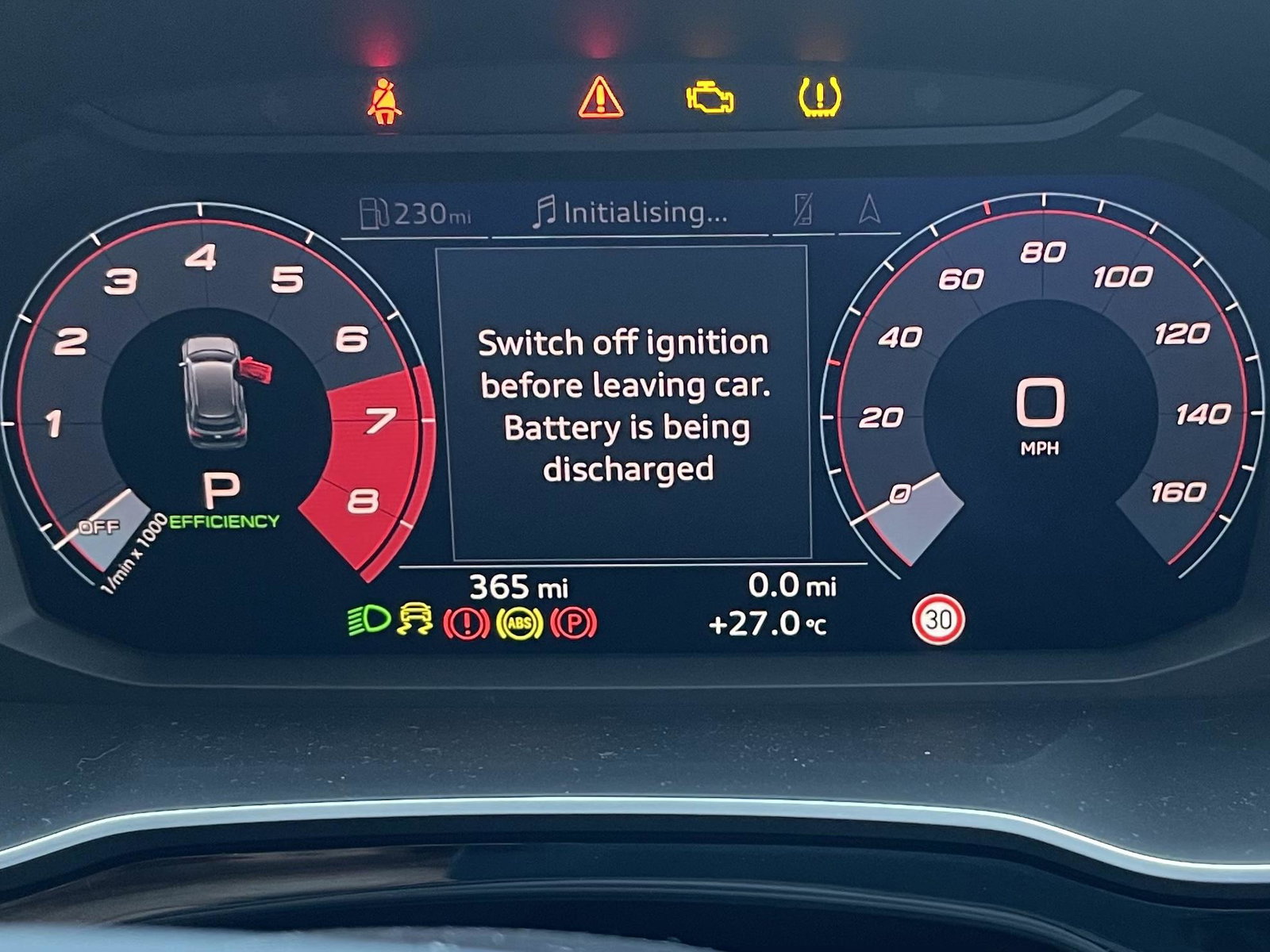

Daytonapaul Posted August 1, 2021 Posted August 1, 2021 Hi, my 18 day old Q3 2021 broke down stating battery discharging. Ten days later my Audi dealership charged me labour and a new battery. They said that the battery had been under 12v for 15 days and that was my fault for not driving the car enough to charge the battery. I had driven over 300 miles in 18 days including motorway driving. I would love to hear your comments please.

Daytonapaul Posted August 1, 2021 Author Posted August 1, 2021 Hi, thanks for your comments. I thought I was going mad, not understanding how I broke my car. I have tried communicating with the dealership but no response. I have been in touch with Audi UK and awaiting their reply. After only 3 days my car had dipped below 12v and stayed there for 15 days before breaking down. All this without any warning lights on the dashboard.

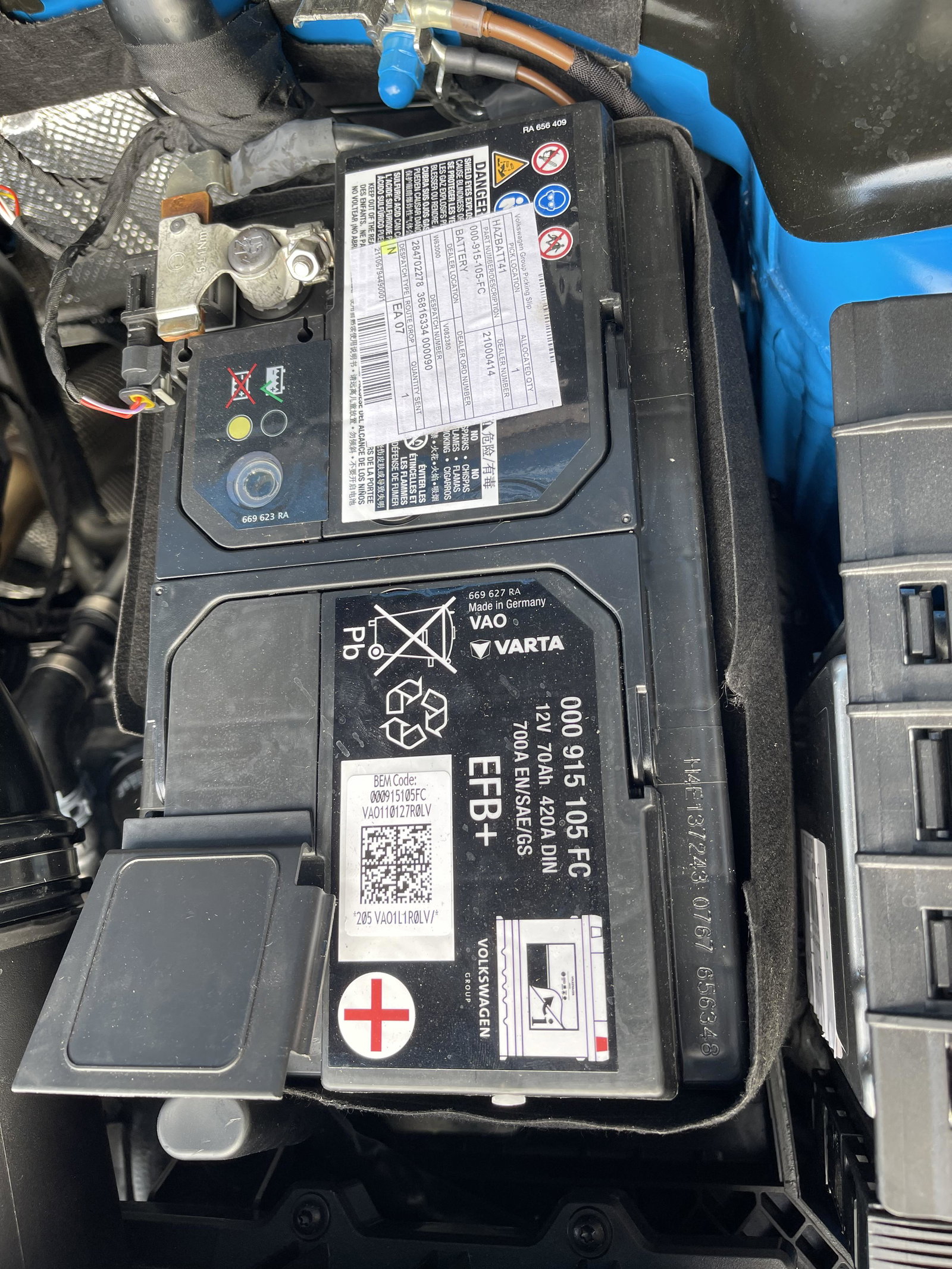

Magnet Posted August 1, 2021 Posted August 1, 2021 Thanks Paul. I’m now even more confused! So did the breakdown company ( whoever they are??) renew the battery? - rather than the dealer. Different story! Who now has the original battery? If so, it becomes even more important to know what make of battery they fitted - and you don’t tell us. Kind regards, Gareth.
Daytonapaul Posted August 2, 2021 Author Posted August 2, 2021 Hi Gareth Sorry for the confusion. The recovery technician read my battery which read a drain of 0.6 amp in a couple of minutes. He took his battery from his van and drove my car to the dealer. He then took his battery out and got a lift back to his van. The dealership put a new VARTA battery in my Q3. I just took a reading and with engine off it read 12.30 with engine on it was 13.30 Regards Paul
