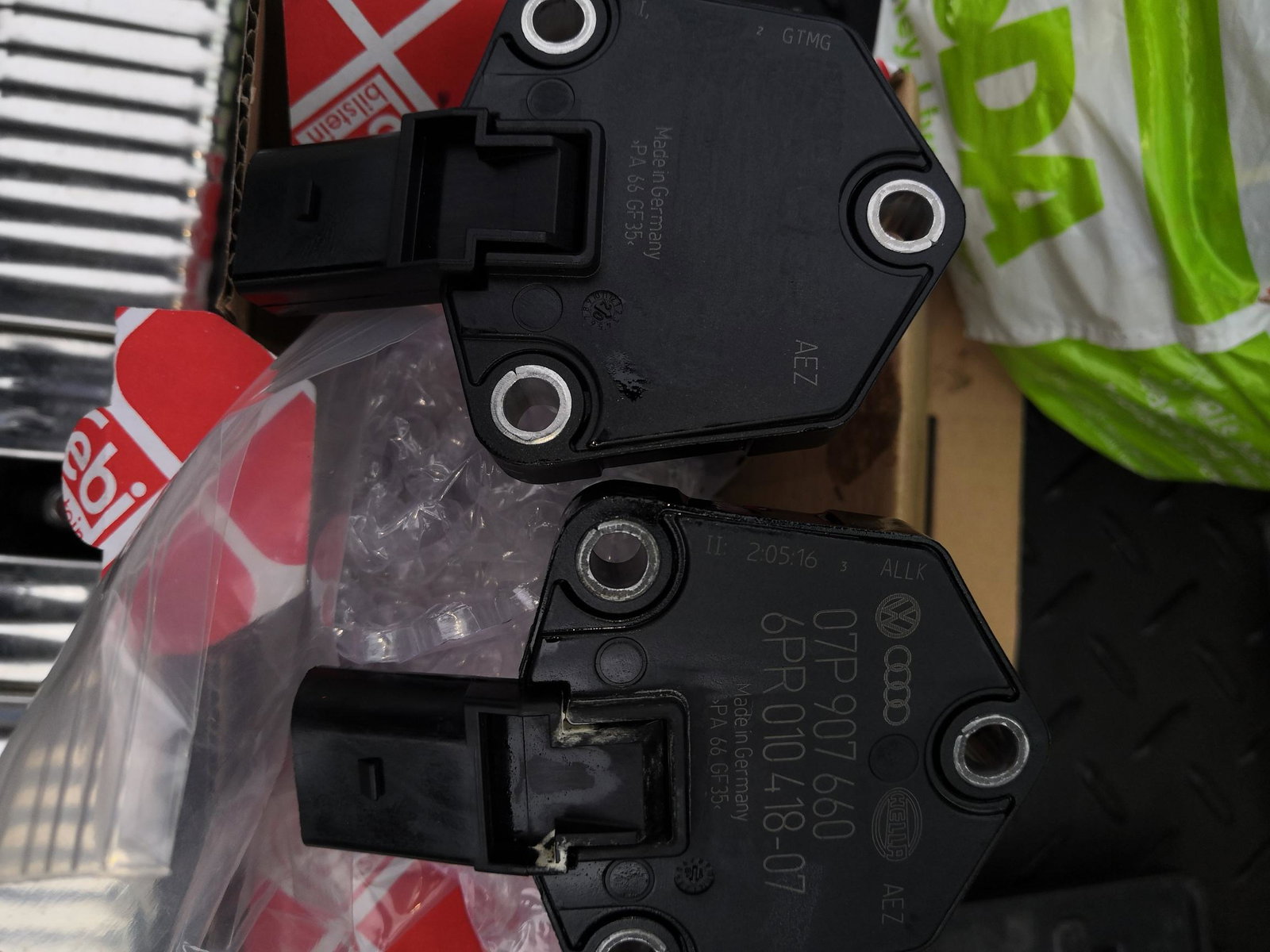

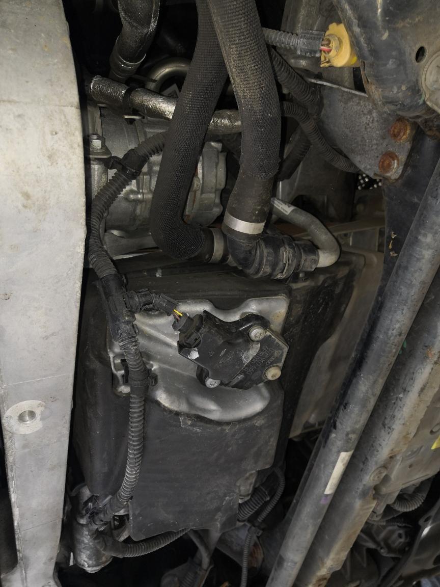

Stevey Y Posted August 17, 2021 Author Share Posted August 17, 2021 Hi Chaps, managed to fix the rogue sensor, the top picture was after I removed the splash guard, fourteen fixings, four massive splined bolts and the rest were an even split of Torx and Phillips headed screws, the fixings for the sensor were Torx and please note the three millimetre thick metal shroud over the front facing area of the sensor this is to prevent shearing in the event of a sump ground out. When replacing the sensor I can recommend a smear of engine silicone as the gasket is pretty thin on the edges where it meets the sump face which is perfectly flat, just a bit of peace of mind, then rotate the tightening of the fixings to 10nm and again to 18nm. The picture below the first shows both the new/old sensor spot the difference the one with the numbers on it is the O.E. sensor the Febi sensor has had all the numbers and logos removed but the numbers that remain are identical, so a little quiz, who made the original?, correct Febi but they can't be seen to be selling O.E. brand parts for less than half dealer price. BTW the reason for the failure is that there is a small PCB at the base of the unit which spends most of its life in boiling oil therefore dredging my memory I think its called built in obsolescence, designed to fail after a suitable period of time, this endorses my theory on aftermarket parts as long as you buy branded they are most likely the same as what you have taken off. Steve. Quote Link to comment Share on other sites More sharing options...
