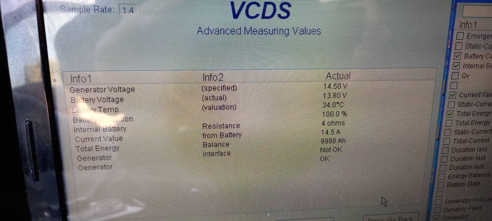

 i have 02254 interface to generator no signal intermittent and 02479 partial consumer shut off active

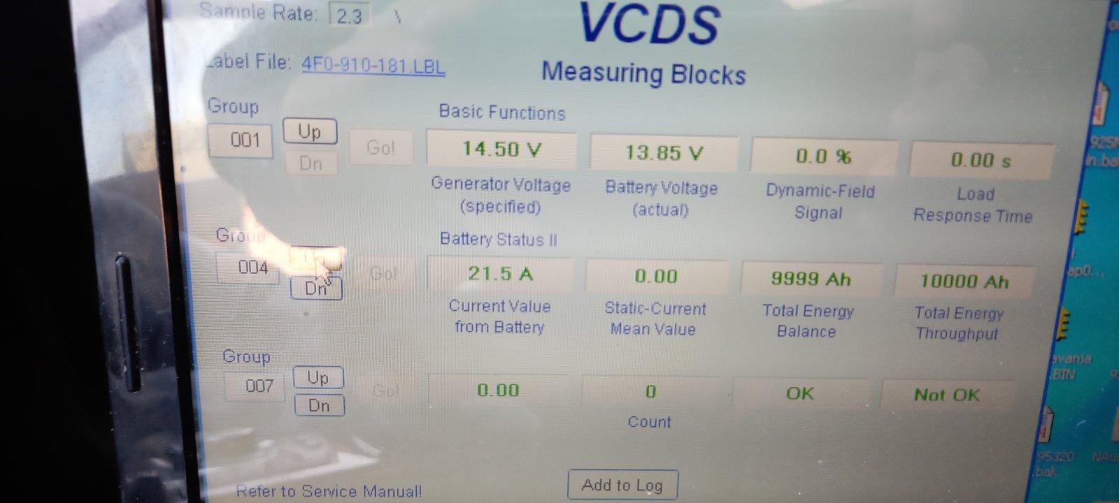

I with diagnostics VCDS and found the following data (photos 1 and 2).

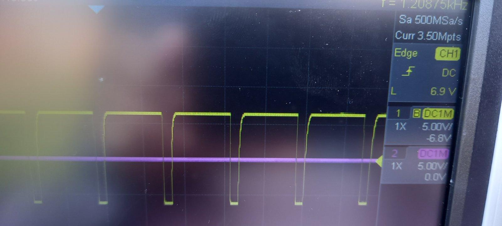

I checked the blue wire from the alternator to the module in the trunk, everything is Ok.
