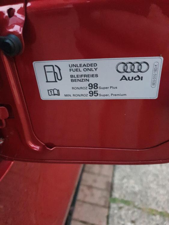

johnbhoy Posted September 1, 2021 Author Posted September 1, 2021 fule cap sayin 95 and 98 octane cheaked tesco fuel pump today e10 saying its 95 so am guesding its ok can anyone else add any info
Stevey Y Posted September 1, 2021 Posted September 1, 2021 Hi please check Shytots post which is bang on the money, its not the octane rating that is the problem its weather your fuel pipes can withstand the onslaught of the extra 5% bio ethanol, check the government website or with the main Dealer.

NathanR Posted September 14, 2021 Posted September 14, 2021 On 9/1/2021 at 8:16 AM, johnbhoy said: fule cap sayin 95 and 98 octane cheaked tesco fuel pump today e10 saying its 95 so am guesding its ok can anyone else add any info Octane rating has nothing to do with the E10 debate mate. Octane rating denotes an ability to resist Knock (detonation) Hi Power cars usually run a high octane rating to prevent detonation and its usually the last transition from road to race fuel. The big Issue with E10 is its corrosive properties. 95 RON E10 and non E10 95 RON have the same Octane rating. Octane rating isn't the issue, from what I can see it will effect classic cars that sit for months on end rather than daily drivers. 1
