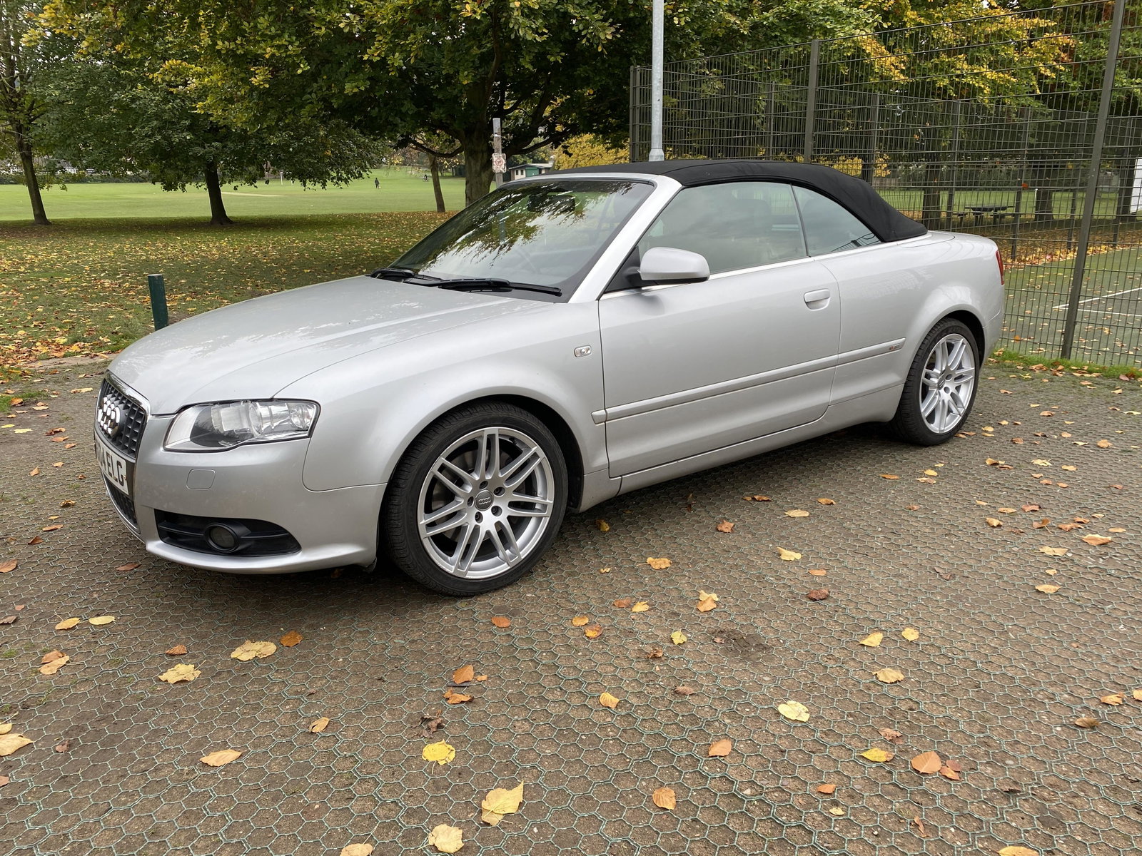

Hi can anyone help my car is throwing on the EML with the code for running lean on bank 1. Also it sometimes has a slight misfire.
Do you how I can fix it?
