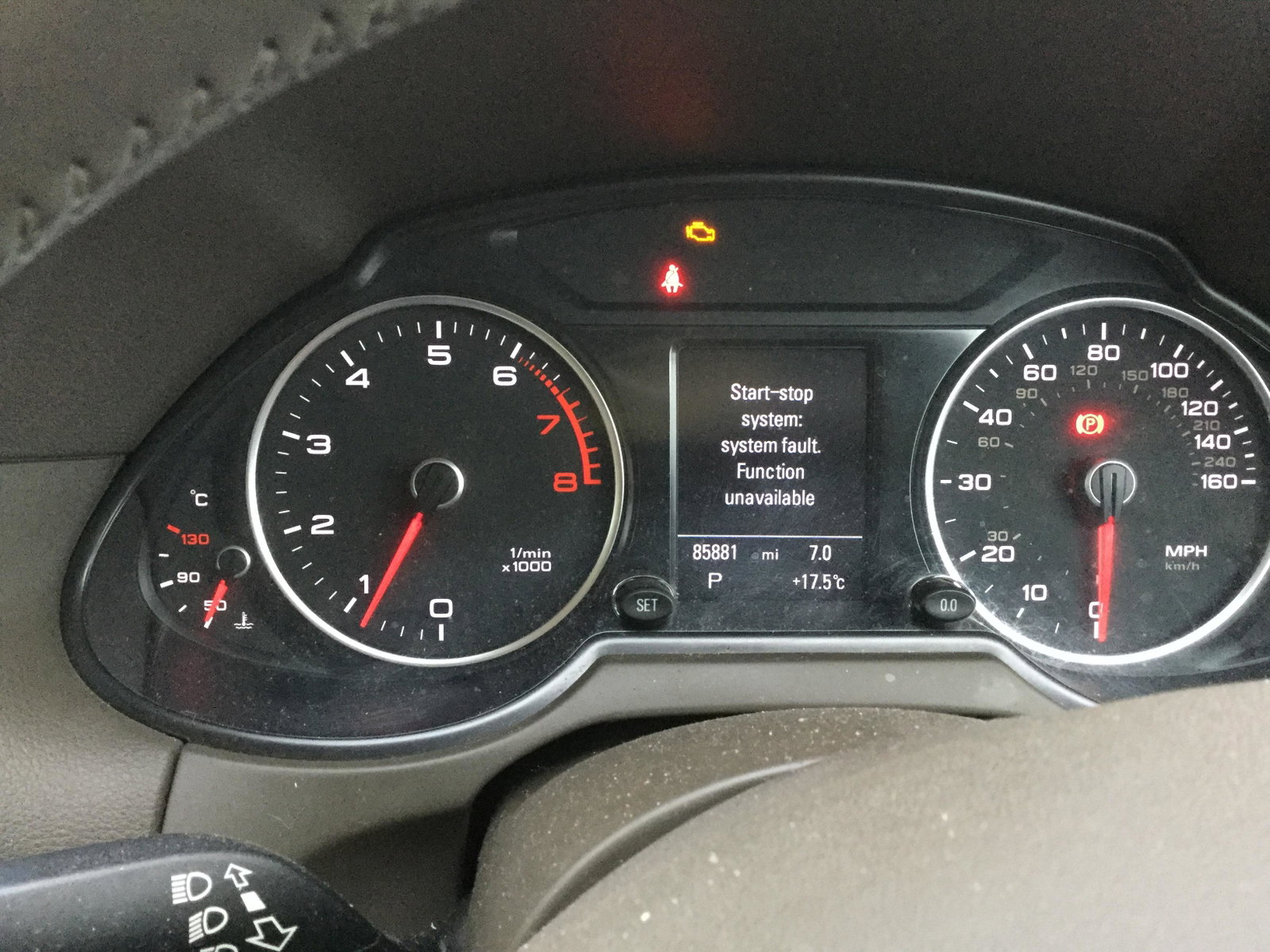

piccadilly Posted September 11, 2021 Posted September 11, 2021 My Audi Q5 whilst travelling today suddenly lost power although the engine continued to run. I managed to freewheel downhill into a safe space ,turned the engine off and restarted it, and I was able to continue my journey. But the same thing happened again a total of 4 times during the 7 mile journey. I reached my destination but have left the car there. I notice when I turn the engine on I am given the message “Start-stop system:system fault.Function unavailable” Any help or suggestions much appreciated! Kind Regards,

piccadilly Posted September 11, 2021 Author Posted September 11, 2021 Dear Gareth and Steve, Thank You for your prompt and detailed replies. There is a warning light showing on the car dashboard (please see the picture) and the local garage who service and repair the vehicle thought was due to a faulty battery, and so replaced it with a Yuasa YBX 2019 .The car is a 2013 model. The light however has not disappeared and the garage tell me that I need a new sensor which they have ordered. I find it alarming that the car can suddenly and completely lose power - I was only doing about 15 miles per hour on a quiet country lane at the time - but it would have been a different (dangerous) story if say this happened on the motorway. I am not particularly bothered about the "stop-start" ,as Steve suggests I have always been sceptical as to whether it does help the environment - but I am concerned about the complete loss of power. I don't suppose the catalytic converter would have anything to do with it? - as you have probably guessed I am not particularly mechanically minded. Kind Regards, John

piccadilly Posted September 12, 2021 Author Posted September 12, 2021 Dear Stevey Y, Sorry I am not mechanically minded - the BEM module and diagnostic platforms VCDS or Snap On mean nothing to me.Is this something the garage should have done when they fitted the battery? Also what is the purpose of the warning light on the dashboard? - please see initial picture. Kind Regards, John
Steve Q Posted September 14, 2021 Posted September 14, 2021 To jump on this, yes the garage should program the battery to the car. Also the yellow light on the dash is the engine management light. 1
