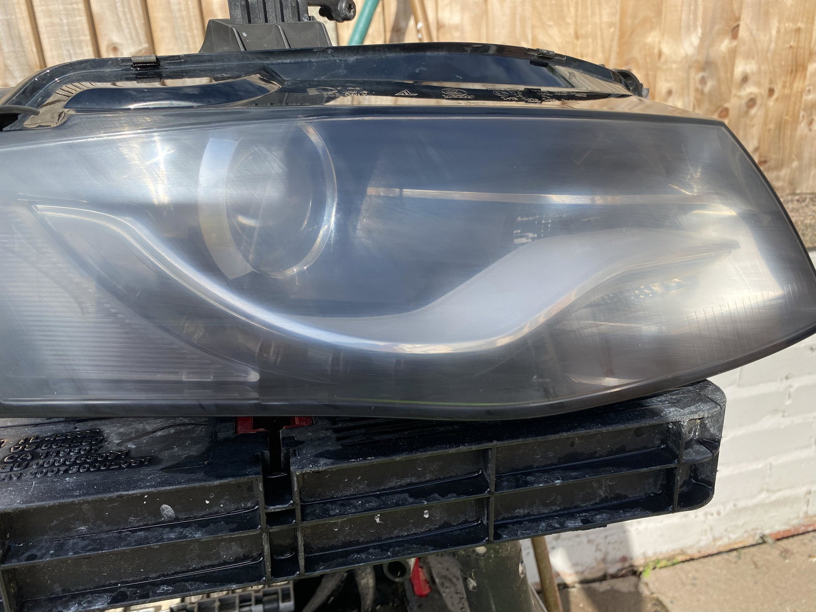

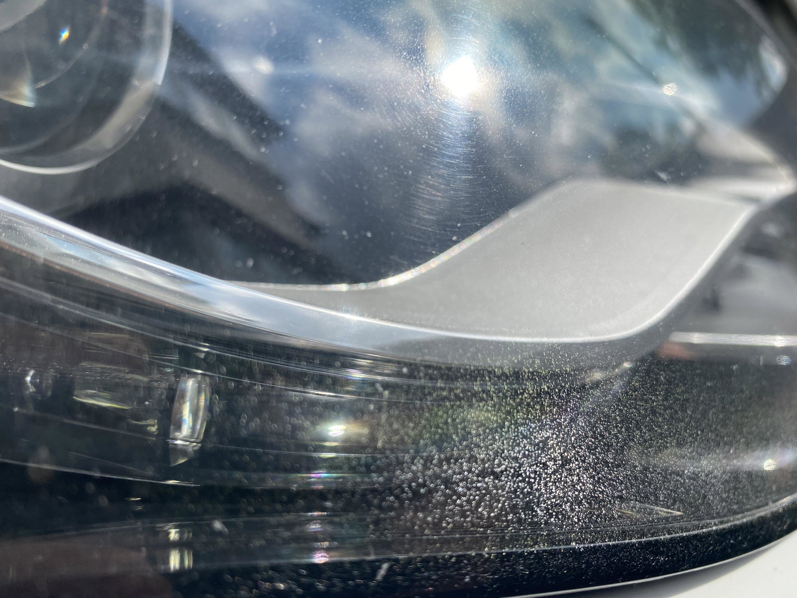

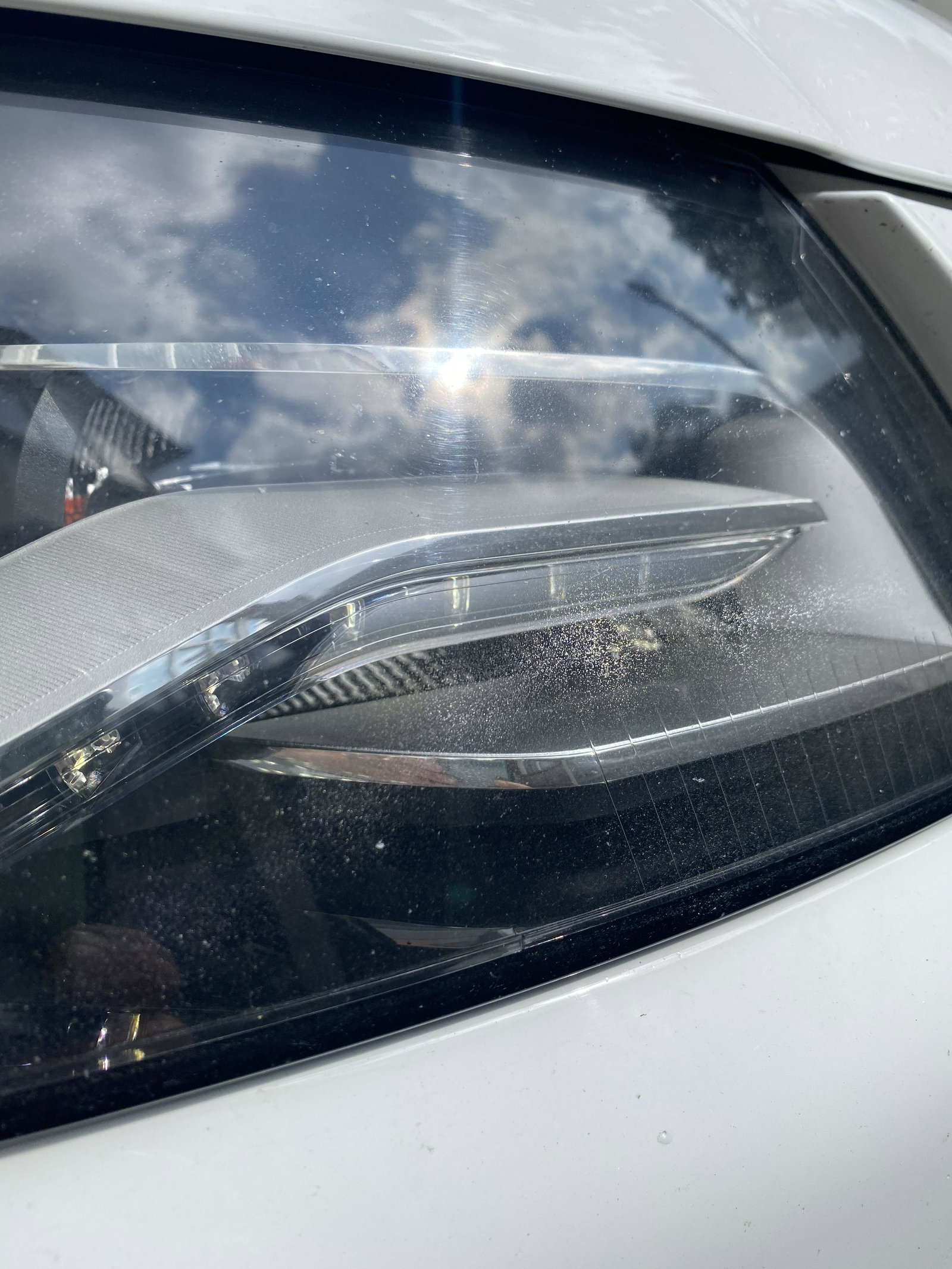

Mrheisenburg Posted September 19, 2021 Share Posted September 19, 2021 Hello all…… The xenon headlights on my A4 are in dire need of smartening up a bit…. I have just replaced the bulbs with a pair of Osram Nightbreakers which are a vast improvement but when you look close at the lights they are covered in loads of tiny little chips which don’t look great. I have watched a few videos of people sanding them down and polishing the chips out…. Anyone done this..?… How did it turn out..?… a new pair of lights are out of my price range at the moment..!.. Quote Link to comment Share on other sites More sharing options...

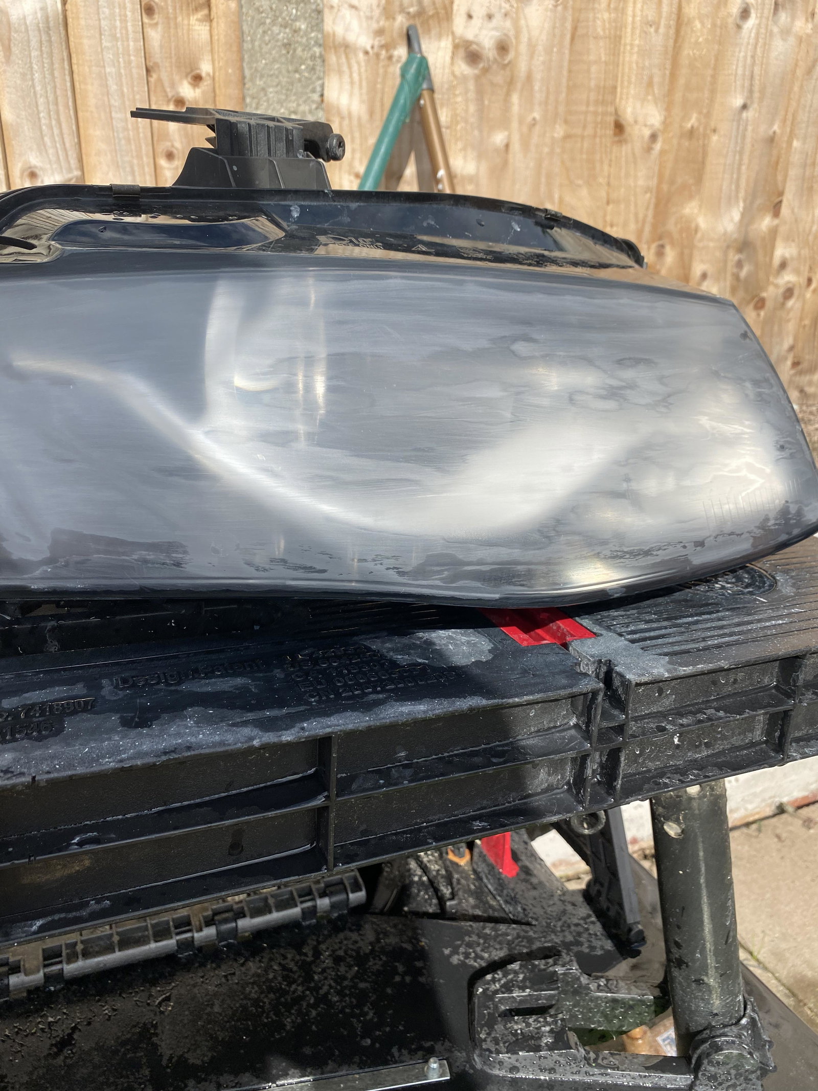

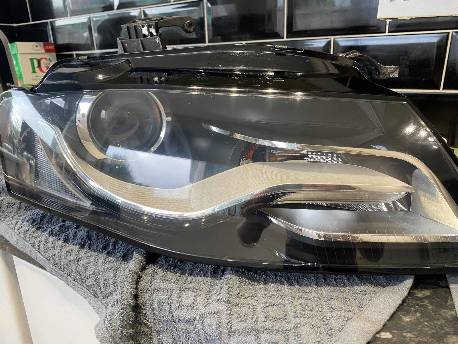

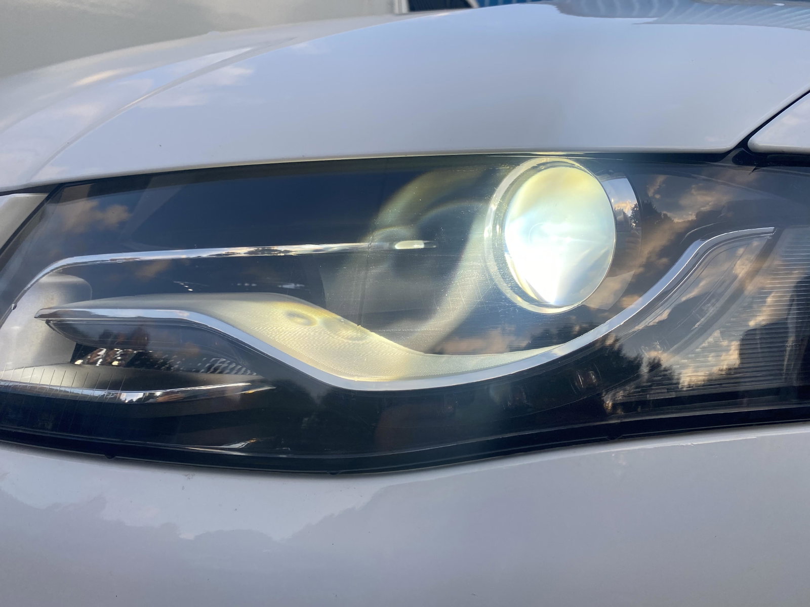

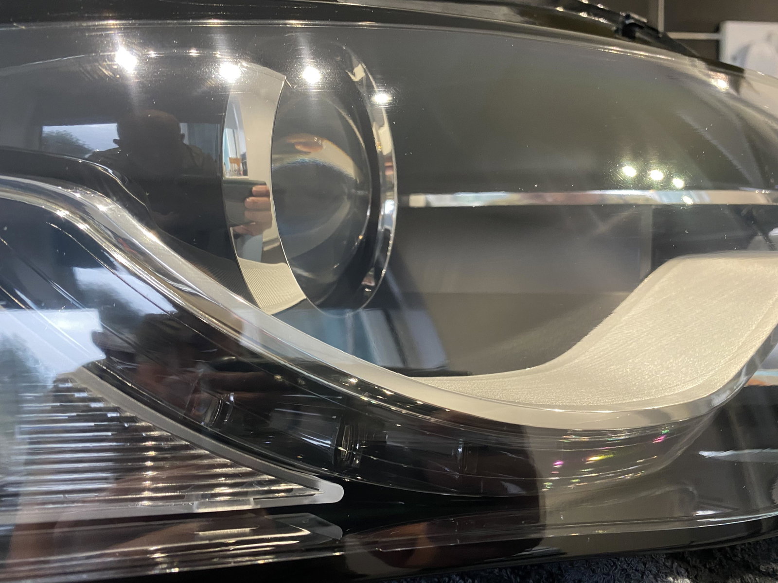

Mrheisenburg Posted October 16, 2021 Author Share Posted October 16, 2021 Well I took the plunge today…… pulled out my headlights and attacked them with various grades of sand paper….. took me around 3 hours to do both lights…. I started with 600 wet and dry and worked up to 5000….. polished them up with turtle wax polish and scratch remover and finished them off with some 3M uv protection. I am very happy with how they came out….. Quote Link to comment Share on other sites More sharing options...

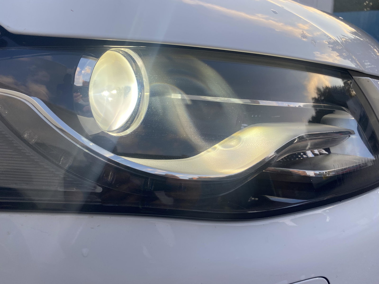

Mrheisenburg Posted October 16, 2021 Author Share Posted October 16, 2021 The new bulbs and the polished lights have made an amazing difference…. Quote Link to comment Share on other sites More sharing options...
