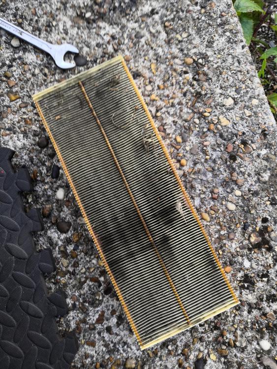

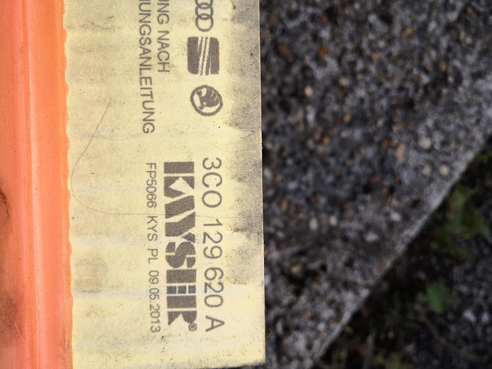

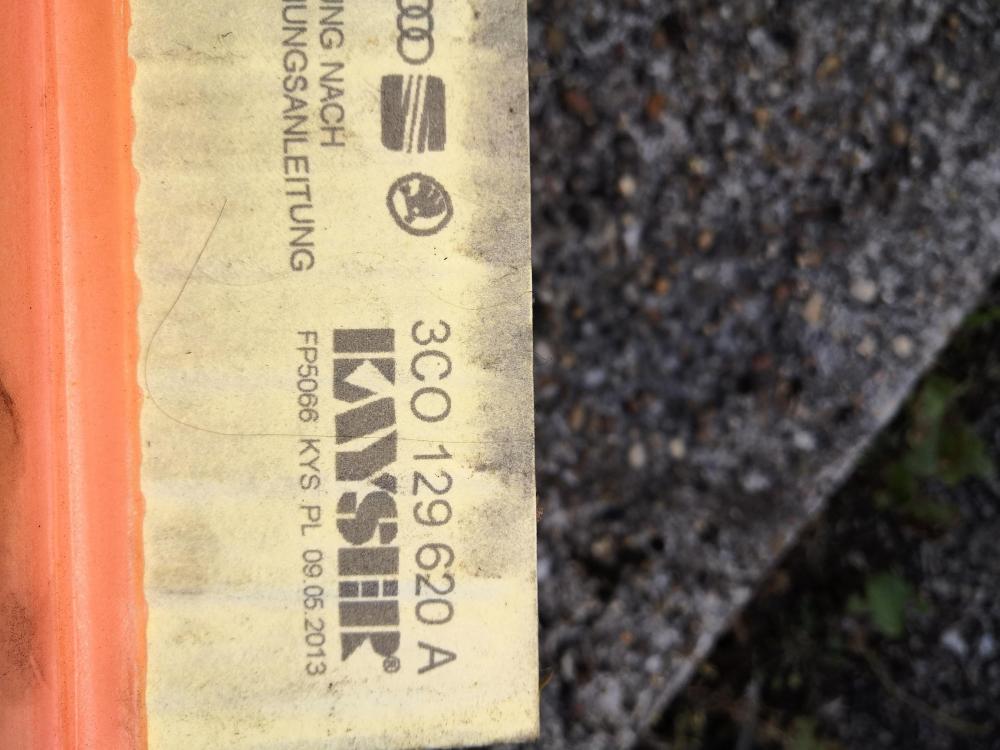

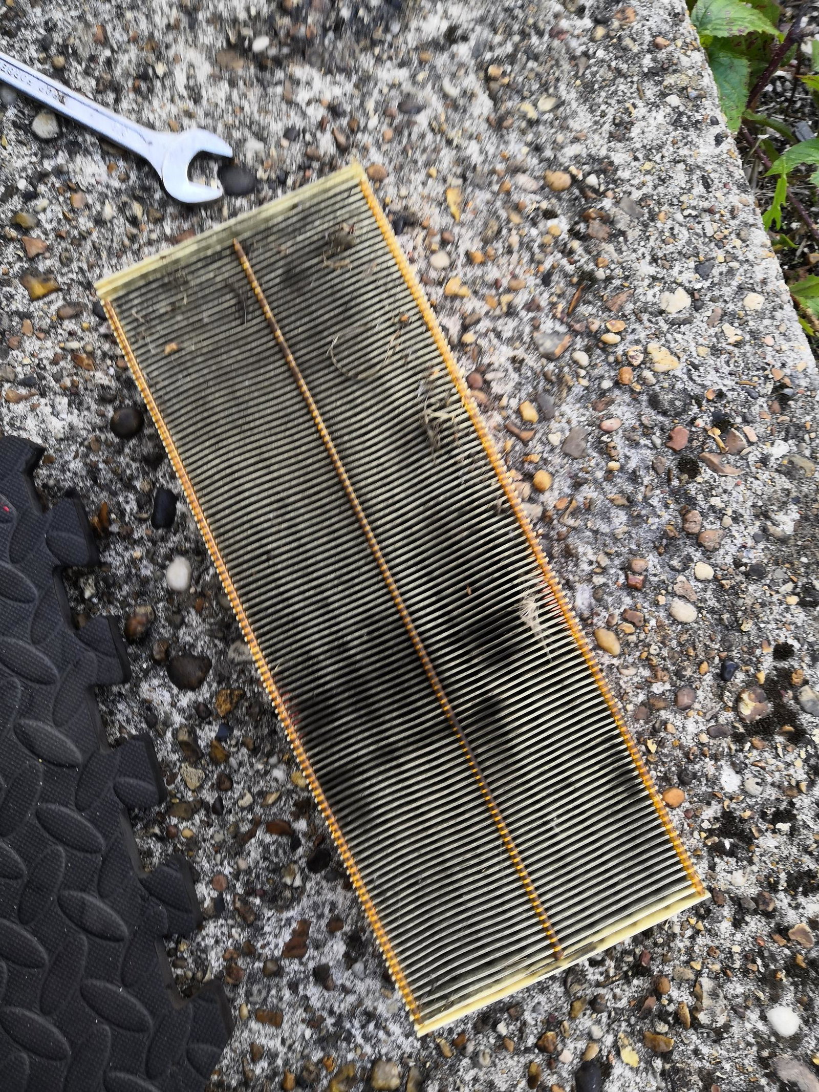

Stevey Y Posted October 10, 2021 Posted October 10, 2021 Hi Gareth, I have a morbid mistrust of dealers apart from the ones I know to be honest to a point, prime example being my daughters Q3 we recently purchased, although it was bought from a private vendor it had always been serviced by Audi with the last service being done at a Bosch service centre, I don't trust the bits of paper supplied so after I had sorted the brakes out I went on to do a full service myself all Febi filters which cost £42.00 the oil came in at £25.00 for VAG oil 504/507 fully synthetic, its not worth posting pictures of the oil and fuel filters as there is no readable print visible through the crud considering the car had been serviced in January this year they were in pretty poor shape as was the oil, the most interesting filter was the air filter please observe the date on the filter which is the same as when the car was built, the car has only done 62k so can someone please explain what these thieving b@£tards for the £350.00 charged for a service, not a lot apparently, as I said they all prey on those that know nothing about the mechanical side of cars, they only want the maximum profit for the least effort. Steve.
Magnet Posted October 10, 2021 Posted October 10, 2021 Hello Steve, Interesting - although if I read it correctly, the last service wasn’t carried out be a main dealer. With a morbid mistrust, is it possible that the last service centre might have swopped good parts for well used? Who knows? For what it is worth, I was talking vehicle sales and not vehicle servicing. Having said that, I think we share the same view with regards to the (unquestionable?) belief that FSH is an absolute requirement. Kind regards, Gareth. 1
Stevey Y Posted October 11, 2021 Posted October 11, 2021 14 hours ago, Magnet said: Hello Steve, Interesting - although if I read it correctly, the last service wasn’t carried out be a main dealer. With a morbid mistrust, is it possible that the last service centre might have swopped good parts for well used? Who knows? For what it is worth, I was talking vehicle sales and not vehicle servicing. Having said that, I think we share the same view with regards to the (unquestionable?) belief that FSH is an absolute requirement. Kind regards, Gareth. Hi Gareth, I think dealer/servicing all comes under the same sub heading, if you view the symbiotic relationship between the two its hard to see where one begins and the other ends, I think its highly unlikely that the last service centre had an air filter that was not only second hand but had the right build date that was the same as the car, having spoken to the guy I know at BMW service he reckon the dates are peculiar to when the part was fitted as built and would not appear on any subsequent part even if purchased from a main dealer. Steve,
